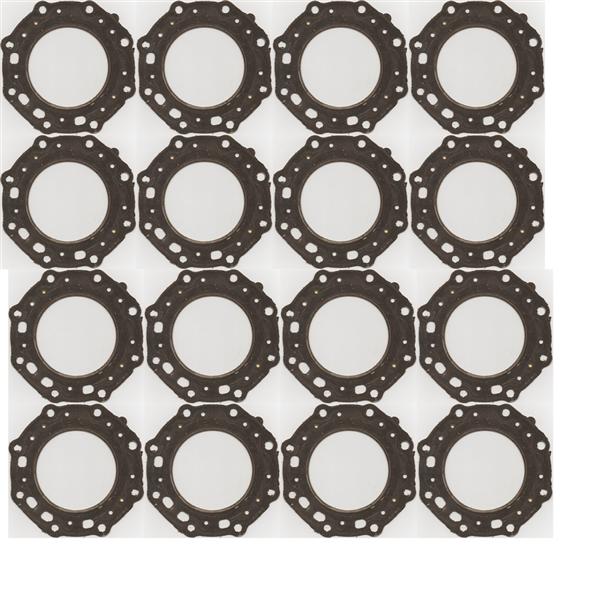

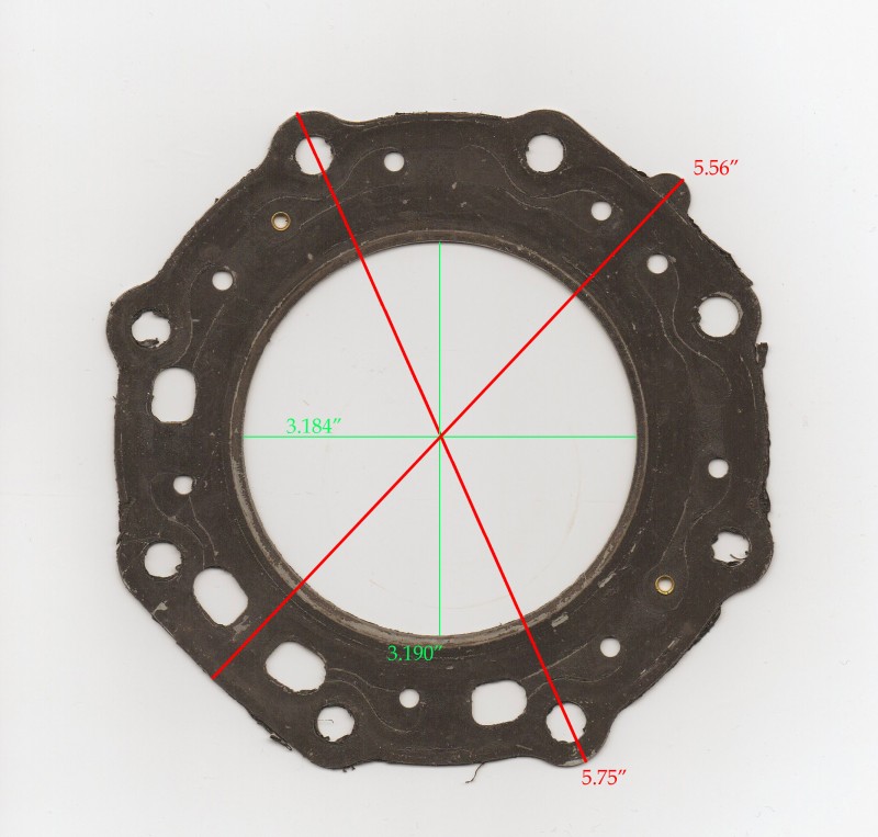

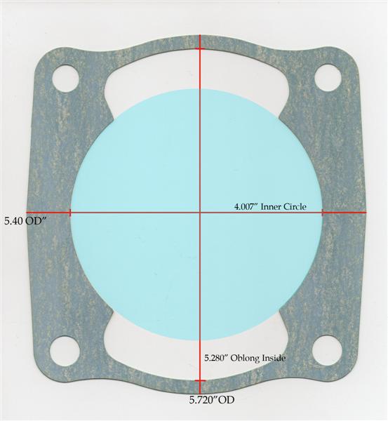

here are some measurements i made with photoshop digital ruler. Can you double check these for me on the actual gaskets to make sure the DPI is precise.
thanks for the scans!
PostPosted: Wed Mar 24, 2010 10:53 pm
Posts: 1228
speedchaser wrote:
Ask your laser guy how flat he can keep the copper and aluminum being that Thin I think he will run it to problems
but I been wrong before :-)
The way I was going after them was steel rule die or some times call a cookie cutter die goggle it
http://www.google.com/search?q=steel+ru ... =firefox-a
I can have the die built for under $150 each fl350 head and base gasket.
and they will cut up to .045 soft copper or aluminum and keep the pretty flat too
P.s. what price where you looking to get out a fl350 copper head gasket and a aluminum base ?
thanks SpeedChaser
it wont be a problem to keep flat i hope, the whole plotter table has a honeycomb mesh and really powerful vacuum. if you put your hand on it, its hard to remove. We will have to paper off most of the open table space to concentrate the vacuum to the area the metal is sitting also.
and as far as price? im not too sure actually. It depends on the price of raw materials. On the forum i don't think i would really be looking to make a profit as i feel i owe something to the community. Assuming i don't have to buy polished finish metal: aluminum base should be fairly cheap. copper would be more. I'm going to look around locally at some shops and see what i can get. I couldn't find polished finish any thinner than .032 (which might be the correct width for head gasket on pilot)
24"x24" @ .032" of polished copper on McMaster is 123 bux!
24"x24" @ .032" of brushed copper @ 100 bux
36"x48" @ .032' unfinished @ 139 by far best deal.
if a 24 x 24 has total surface area of 576 sq.in. and a head gasket takes a little less than 30 sq in i should be able to fit around 16. math would say 19 but the edge doesn't have usable space. attached is a picture that is to scale(but scaled down proportionately) of the layout on a 24x24 copper sheet with roughly 5.5x5.5 sized heads.
so assuming polished copper @ 123 bux/16 gaskets = 7.68 cost per unit to make+shipping(assuming ray doesn't charge me to use machine). What do you think would be a fair forum price? 20 shipped? are they worth more?
Brushed = 6.25 each
unfinished 36x48 = 139/53 gaskets (tough squeeze) = $2.62 a piece
if the unfinished copper are usable, or even if i can buy the unfinished and polish/sand by hand it would be by far best option.

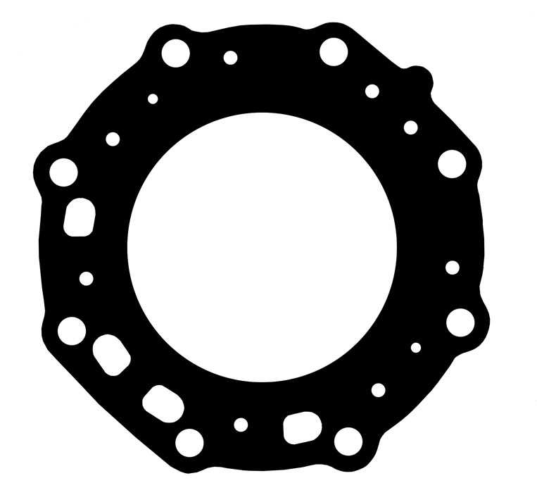

this laser method might have zero start up cost besides materials.. i don't think ray will charge me, i will exchange computer repair services for use of engraver.
He says it should keep the metal down even if i buy it in a roll...
anyways here is a scaled down image of the complete head gasket drawing
one with measurement mask layer and another without (not these are at 72dpi and not to scale)

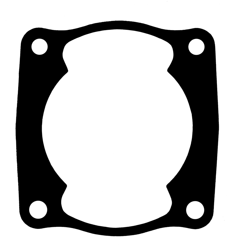

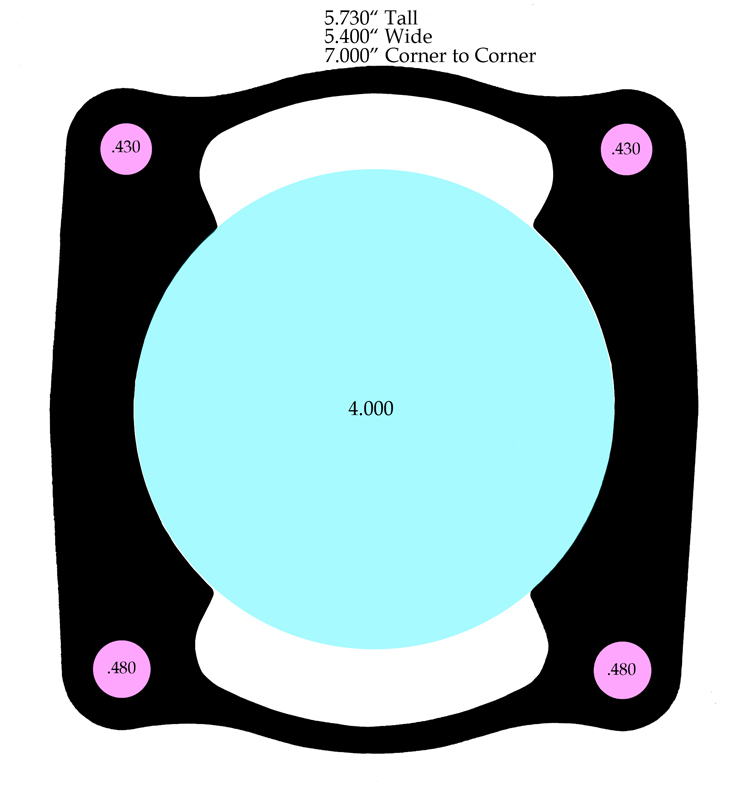

PostPosted: Thu Mar 25, 2010 1:42 am
Posts: 1228
base gasket done here are scaled drawings

PostPosted: Thu Mar 25, 2010 9:37 am
The corner holes are the only thing I can verify on the cylinder gasket and they are correct as you have marked them, the rest is just a guess your trying to measure something if you touch it the measurements vary .010 to .040 where you put the lines its not a straight line for me to measure from its all just a guess where it lands on the gasket.
The Pilot cylinder gasket thickness is .020
The same with the Pilot head gasket trying to measure over all on a radius or curve is all just a guess yeah looks close enough type thing, am I measuring EXACTLY where you marked it on the radius and bends? I really doubt it o its just a guess.
IMO the whole thing is a wash your just going to be guessing and will not know if they fit until you make one then fit it to the Engine parts.
Isn't their a scanning utility out their we can use to scan a true 1:1 scan my scanner no where does it give you an option of 1:1 so you know that's what your scanning.
IMO your wasting your time if you cant get a true 1:1 scan to work from?
All 3 layers of the Pilot head gasket measure .030 thick

Try this one I also put a machinist rule with it . 300 DPI

PostPosted: Thu Mar 25, 2010 11:30 am
Posts: 1228
awesome thanks
when making a copper instead of wafer would three layers be required? would one layer at .030 be too thin?
PostPosted: Thu Mar 25, 2010 11:41 am
Tpreed wrote:
awesome thanks
Make the copper one layer not 3
http://www.pilotodyssey.com/PO/view ... ead+gasket
PostPosted: Thu Mar 25, 2010 1:48 pm
Posts: 1228
I just about have the vector drawn up in illustrator.
Anyone have used pilot head and base to donate for comparison?
PostPosted: Thu Mar 25, 2010 2:41 pm
I have all kinds of used head gaskets they are steel and don't change much the coating on them just gets damaged, I have a few used cylinder gaskets but used they no longer lay flat and maintain their correct dimension, I scanned a new gasket.
PostPosted: Thu Mar 25, 2010 3:11 pm
Posts: 1419
Location: San Diego
Can you use a DWG of DXF?
I can digitize a JPG pretty quick in AutoCAD as long as I have two known points to scale the JPG to. I can then extrude it to whatever thickness you need and send the model back in BMP, DGN, DWG, DWF, DXF, DXX, EPS, RVT, SAT, STL or even WMF.
