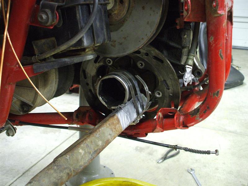

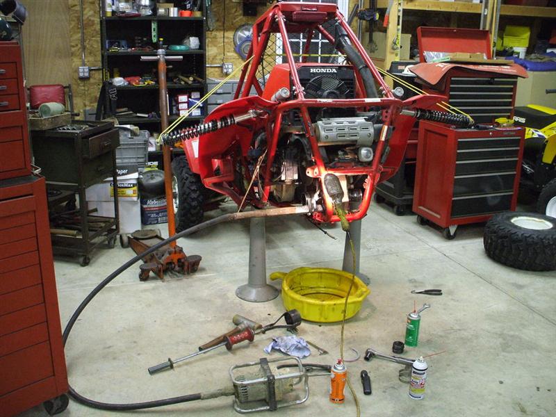

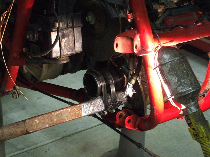

I've been trying for a few weeks now to remove the darn things. I've been spraying with penetrating oil at least two times a day. I'm trying my best to not just start beating on them.
so anyway i got this wild idea to somehow vibrate the cups to work the oil into the splines and losen up the rust. So here is my idea. let me know what you think.

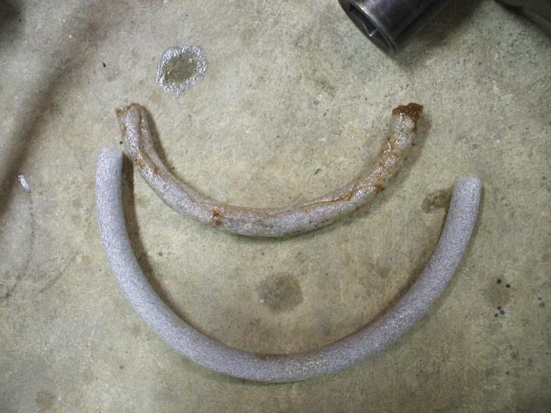

I used foam caulking/weather strip to create a dam to puddle the oil otherwise it was just running off.
I used a concrete virator to vibrate the stub, time will tell if it works.

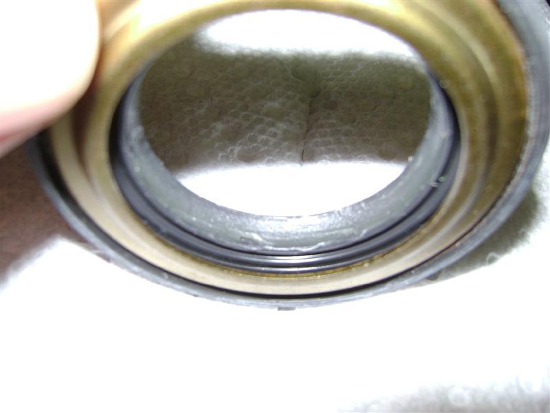

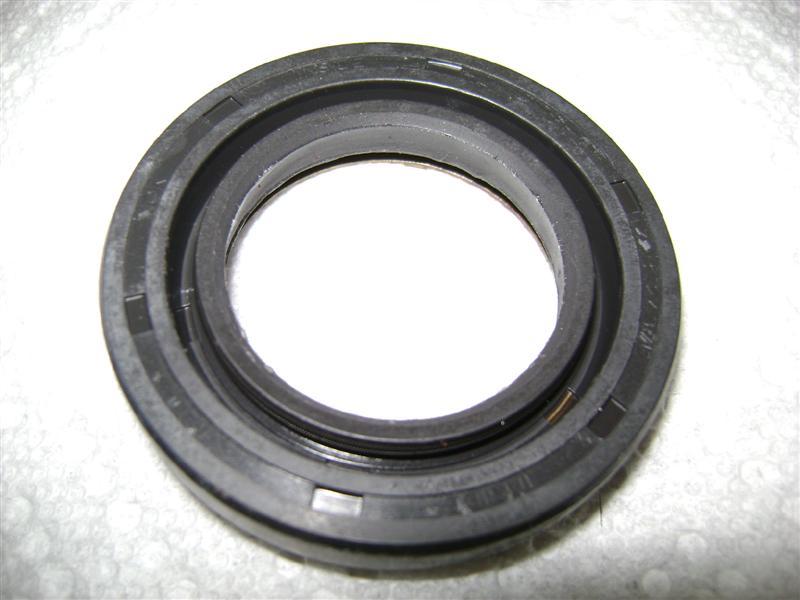

Here are pics of the seals I have.

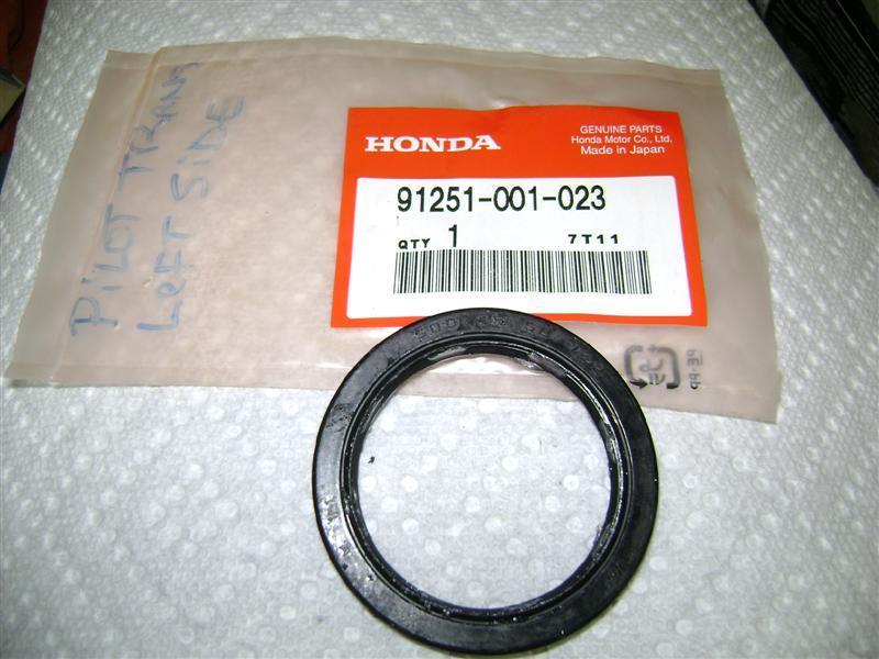

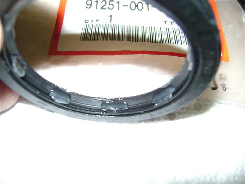

The 91251-001-023 says 45x58x7 on the sticker service Honda put on the package
The numbers molded into that seal are W 11 BIG SPACE 500 45 58 7-2

I'm still trying to remove these cups. I can not believe they are stuck so solid. I have the pilot cabled from wall to wall of the garage with lag bolts into studs. the other end of the cable is around the axle cups. i've tried several heat cycles using the heat gun. using a thermometer the hottest it got was 220 or so. The biggest slide hammer i can find is 5 lbs. i've tried several different 3 jaw pullers with the slide hammer and they all eventually pop off. i rigged up a 1/4" cable which wraps around the rear of the cup by the splines.

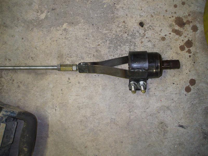

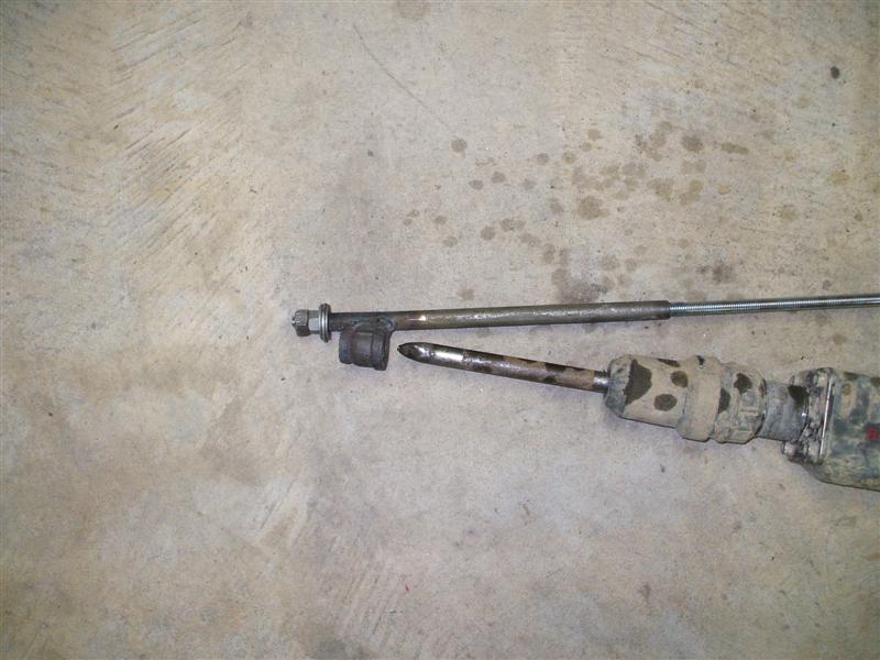

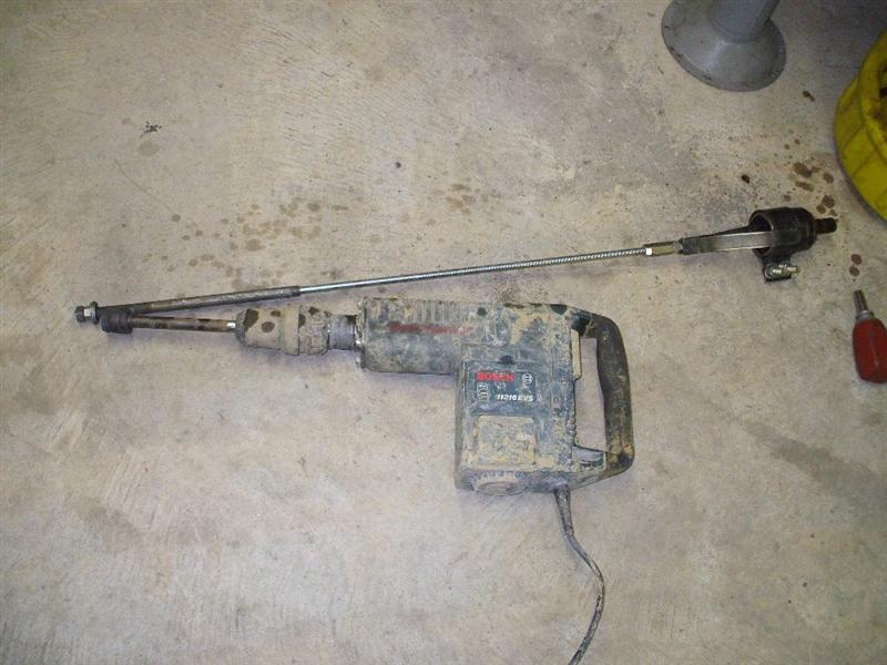

PostPosted: Sat Feb 27, 2010 9:28 pm
well i finally got them out. welded up some fittings and used a bosch chipping hammer. splines and final look good, now clean em up, pack the cvs and reassemble. Thanks for all the help!
Lots of work but I am glad it has a happy ending, nice job I like your puller mine is all manual labor heh.
