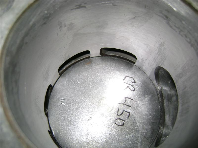

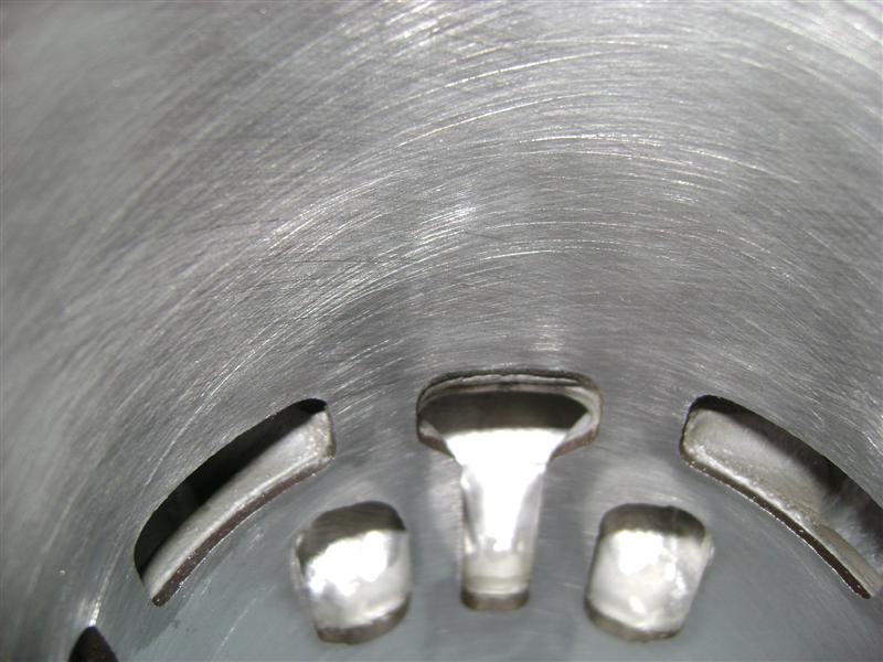

Over the years I have been told by more than once you were on the last bore you could go over bore or as some call big bore, their are a few options one is to go to a 435cc Stoneman has done this read more here http://www.pilotodyssey.com/435cc.htm the other option is to bore it to accept the CR450 pistons.
Afastcar sent me a Pilot cylinder on the last bore and a stock bore CR450 piston so I bored the cylinder out to acceppt the CR450 piston, a few things happen when you do this first all the port openings change for example the exhaust port gets smaller and lower, smaller because its slightly tapered and down because its angled slightly down.
The rear boost port is angled up so as you go bigger that port is lowered.
The transfers because of the way they are angled get wider as you increase the bore size.
The cylinder was getting hoserized anyways so its not a big deal to adjust the ports, the exhaust port will be wider and raised, the rear boost port will be raised and enlarged, the transfers will get the usual treatment.
Afastcar is going to run a Speedchaser Pilot Cool Head with this setup so a new dome will need to be designed to work with the increased displacement and bore size, I think I have a damaged dome that I have been saving for just a occasion it was beat up during one of my Pilot Engine crank bearing failures, if I am going to machine down a dome might as well cut the material off a damaged dome save the new undamaged dome for future use.
Some cylinder pics.

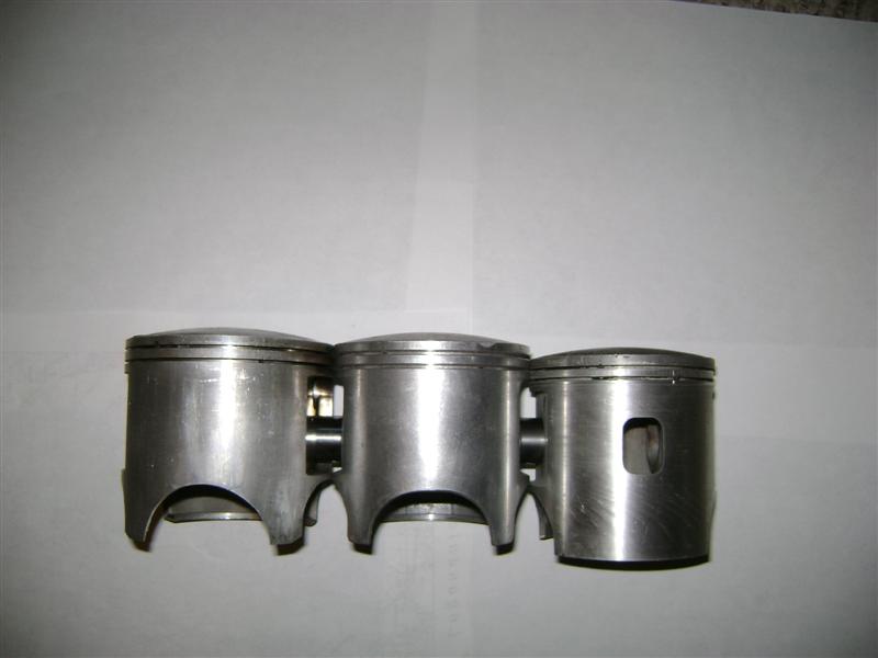

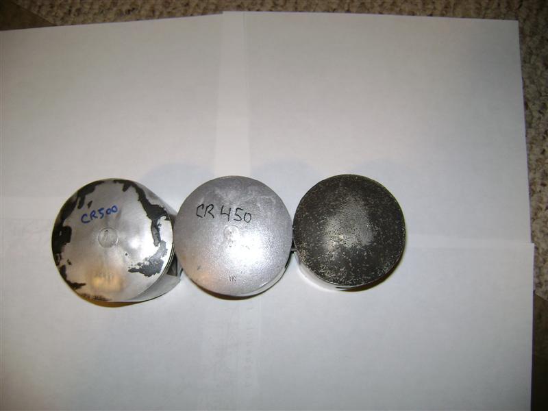

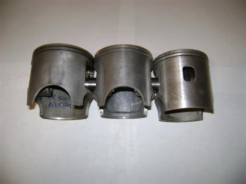

with the cr450 piston are you going to have to run a thick base plate to space the cylinder up or does the wrist pin hole line up with the pilot piston? this is pretty freaking cool idea
PostPosted: Wed Mar 30, 2011 5:23 pm
Will need a spacer, left is CR500 middle CR450 right is Pilot piston

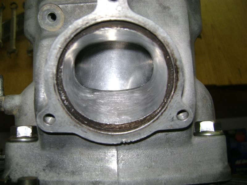

PostPosted: Thu Mar 31, 2011 1:05 pm
Ok I did a quick and dirty measurement for the spacer plate by installing the piston and cylinder on my Pilot bottom end with no gaskets then putting the piston at TDC (Top Dead Center) (Top Dead Center) the outside edge of the piston is about .210 higher than the deck (top of the cylinder)
Cylinder gasket is about .020 thick.

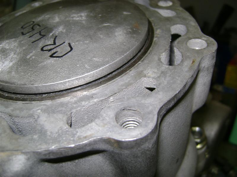

PostPosted: Thu Mar 31, 2011 1:07 pm
The bottom of the top ring groove is flush with the top of the cylinder with no gasket or spacer.

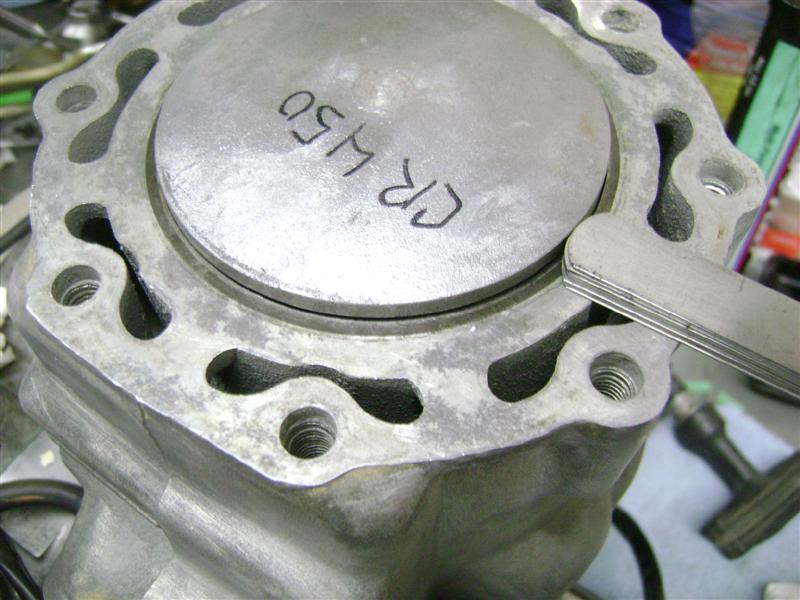

PostPosted: Thu Mar 31, 2011 1:09 pm
I took 3 sets of feeler gauges and set them to .210 and put between the cylinder and the crank case spacing it up the required .210 I installed the cylinder nuts and tighten them thumb tight to keep the cylinder in place.
Longer cylinder studs will be required with the spacer.

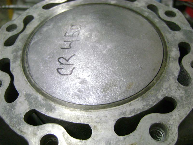

PostPosted: Thu Mar 31, 2011 1:11 pm
Raising the cylinder the .210 now puts the outer edge of the piston flush with the top of the cylinder.

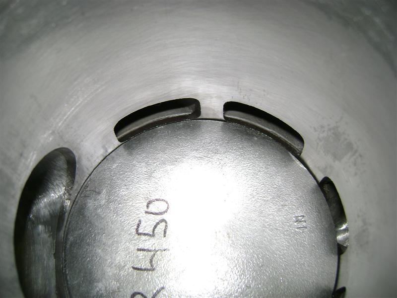

With the .cylinder raised .210 and the piston at BDC (Bottom Dead Center) the top of the piston is real close to being flush with the bottom of the transfer ports and the center of the exhaust port.

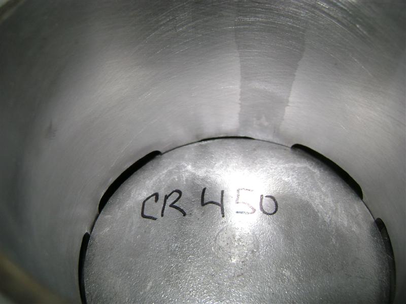

With the cylinder spaced up .210 and the piston at TDC (Top Dead Center) the bottom of the exhaust port is still covered when I remove the piston and cylinder again I will look inside and see how close it is to not covering the exhaust port.
What am I missing?
adnoh what measurements/data do you need for the head data, can just take your Pilot data and increase the bore size to the CR450?
