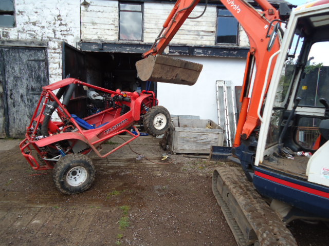

i changed both front wheel cylinders,brake shoes and the hand master cylinder (for new) on the pilot yesterday and had the same problem even with the vac pump it was a pain but lifting the front end helped to get out the last of the bubbles....it worked and now have a great brakes again....
