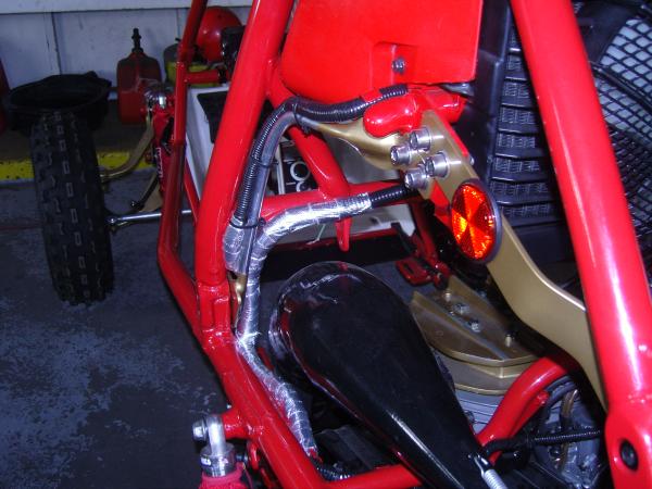

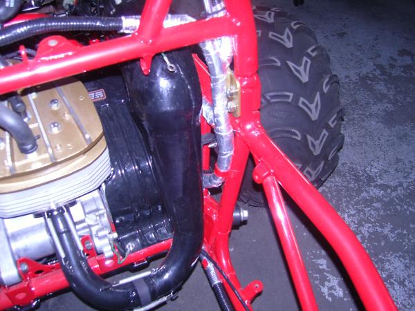

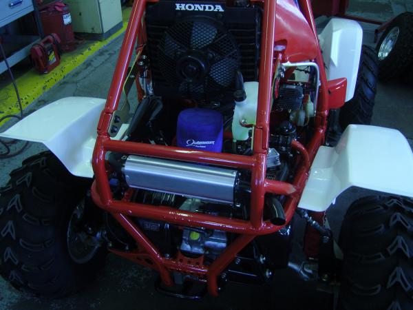

The first pic. is of some new oem air dams and new oem headlight buckets, I got them put on today.
I also finished the crankcase breather and installed the seat today.

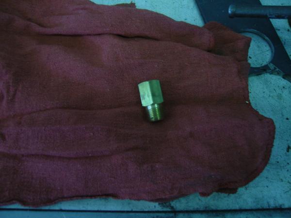

I used a brass transmission cooler line adaptor fitting for the crankcase breather, I cut it down and cut new threads 14mm x 2.0. I then took a 1/4 brass nipple and screwed it in to the fitting and saudered it.
The breather hose is inside some spark plug wire heat shield.

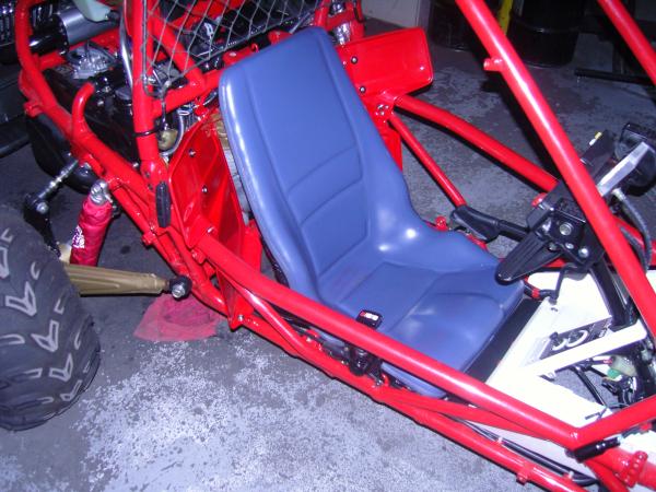

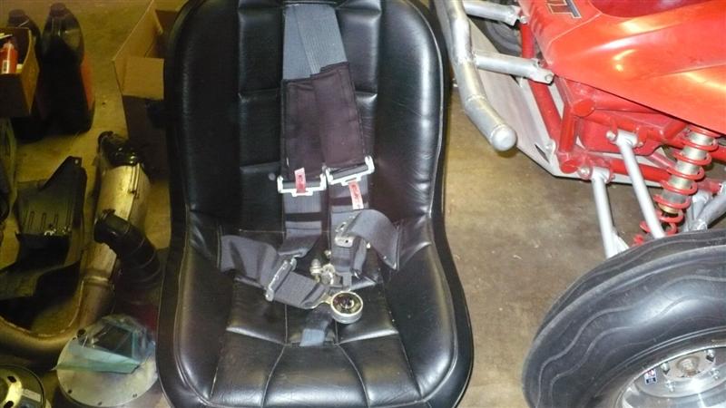

One more pic. with the pilot seat installed, I bought an air suspension seat from Randy for my wifes pilot and was going to put it in the odyssey for my son but after setting it in there it looked like it would be another big under taking to get it put in so I went with a pilot seat for him. I may in the future get him a better seat.
Does any know what suspension seat will go in the odyssey, will a beard seat fit?

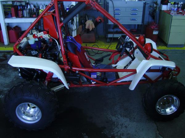

Hello to all, other than the decals, re-torquing all bolts, touch up on the paint and putting the digitron gauges on she is done. I finished her on the morning of the 4th. but have not had time to post some pictures.
I am going to break her in and astablish a wet line in the exhaust before adding the digitron gauges.
I took her out for her first ride yesterday, wanted to get on her bad but held my thumb at bay. By the end of the day I was doing half throttle short bursts man does she run and ride great. I started with a 185 main jet it may be to big but I wanted to be sure and start out fat, I will be taking her out next weekend to finish the break in and see how she does so far no problems. Everthing works perfect even the fuel level sensor.
I am using the Honda GN2 non synthetic mix oil for the break in, after break in I will be running Honda HP2 full sythetic mix oil.
I can not wait to open her up.

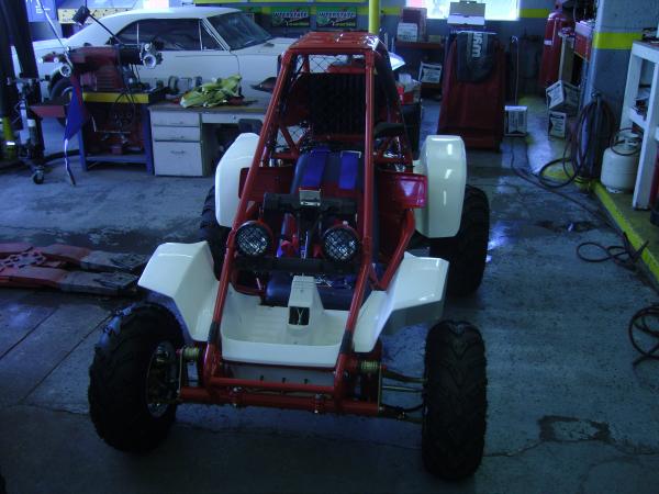

Here are some more pics they are not that great the lighting is bad. She looks so awesome in person, I wish I could just park her to look at.

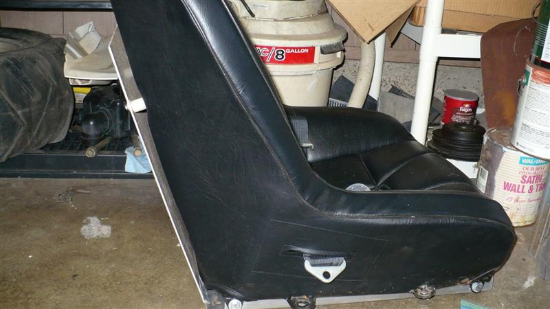

Randys "better" seat will bolt right in. The only problem is theres no bottom skid plate. I had one made up at a metal fabrication shop. It doubles as the heat shield. Hope this helps and your PilOdyssey really looks great!

Stix you need to find some good closed cell foam padding to put between your keister and that skid... My skid drops lower than youts does and I have bottomed my tailbone once on mine... The extra padding will prevent that!

Hello Stix, thank you for the pics. That is the exact seat that I bought from Randy, I sat the seat in there and decided it was to much more work at the time. I will check it out later when I hook up my gauges.
