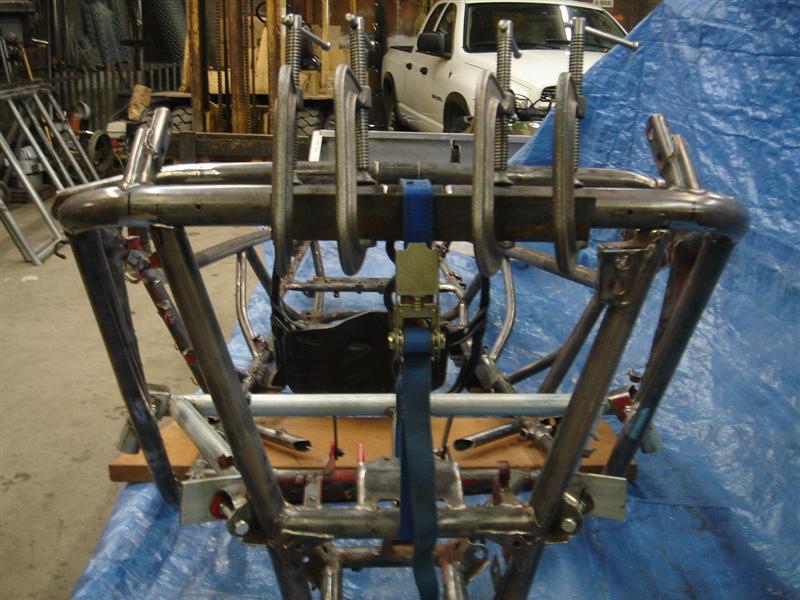

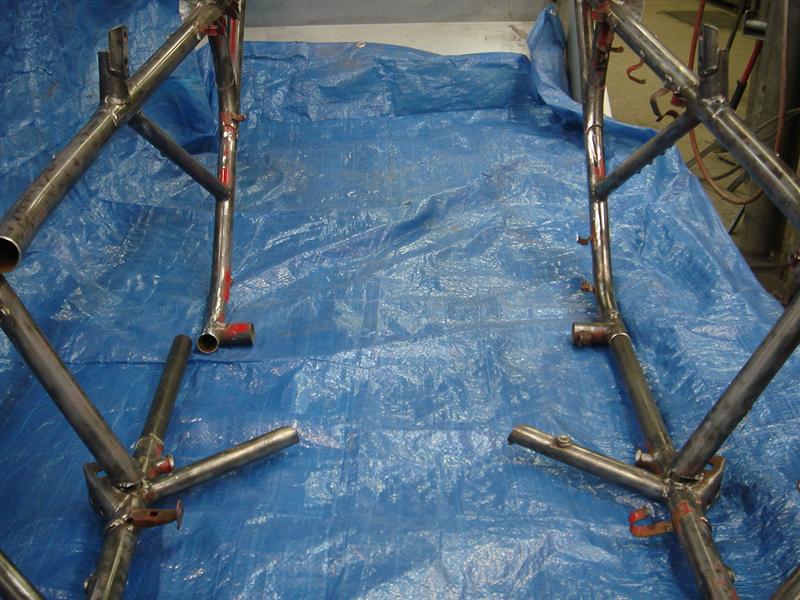

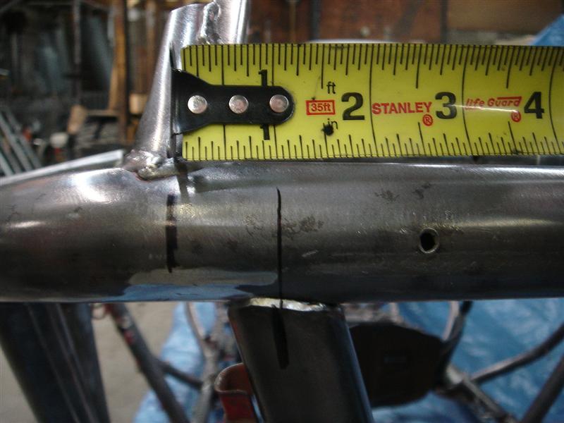

More pictures of where I'm at. With the inner sleeves it allow one to move the frame in and out to get a feel for how the frame will untimately end up. The inner sleeves and the "extension" pipe is cromolly .058 wall, I try and use no less than 3" of sleeve going into the main frame. Sometimes this can't be done like on the bottom tube where the Trailing arm bolts go through, but the longer the better.
Wayne
File comment: The bottom frame member wants to "grow" this much when stretched 12 inches. I'm only going for 5-6 inches but I'm finding it hard to make the plastic at least as good as the FL800 at 4" of stretch. I remeasured the stretch and it is only
File comment: Slotted inner sleeve for the plastic munting point. This is the only one that need slotting.

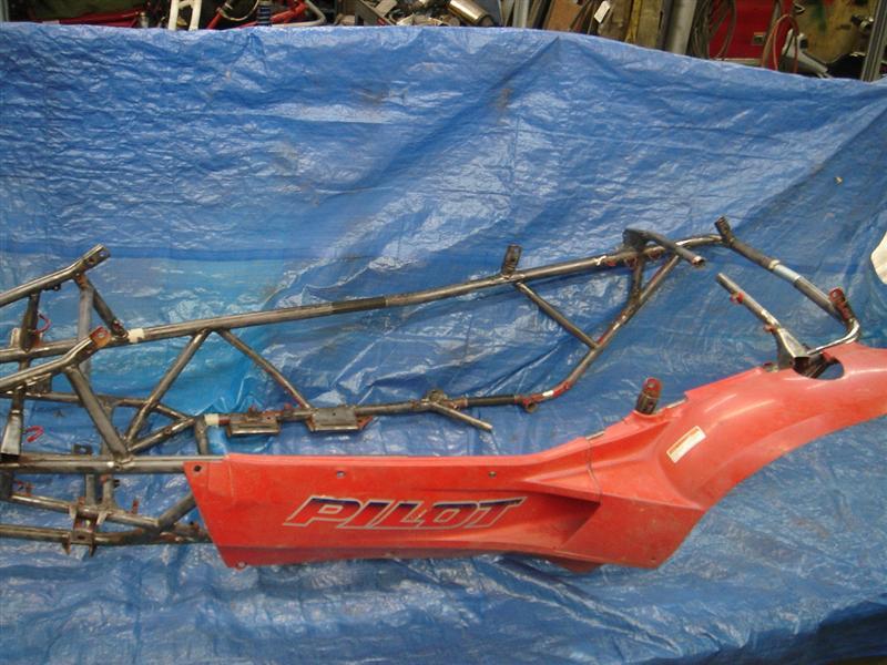

File comment: Rear quarter panel with sleeves
File comment: Frame Test fit. This is at 6", I don't think the plastics will fit very well at 6".

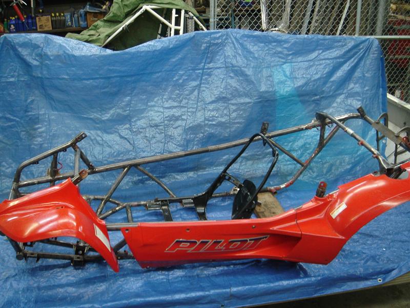

PostPosted: Wed Jan 09, 2008 2:02 pm
Posts: 185
Location: Anchorage Ak
The plastic is not fitting well at 6", the main problem is the bottom trailing arm mount is pushing out the side plastic.
Wayne
File comment: THe gap with 6" is getting really noticable, not that it was not noticable at 4" but now I think it is too much. I really want atleast 5".
PostPosted: Wed Jan 09, 2008 2:40 pm
Wayne
Can you notch the plastic where its pushing out?
What if you put a piece of metal in to fill the gap between the plastic then paint it red to match the plastic?

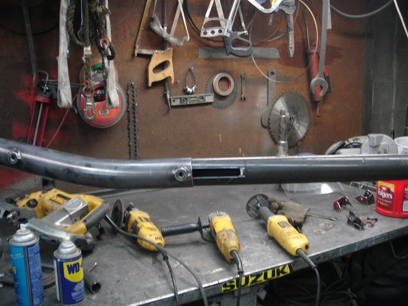

File comment: I cut the bottom frame member just before the seat mounts, this gives me more inner sleeve into the front half just before the bend.

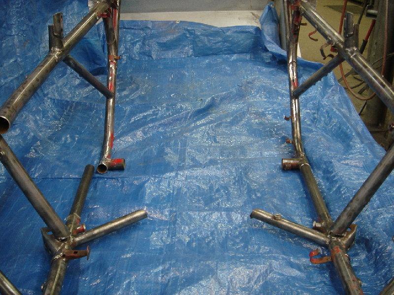

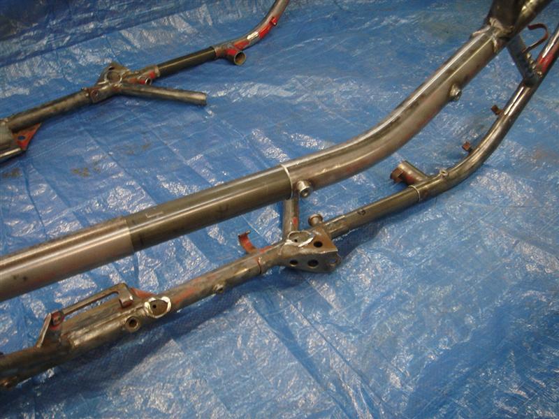

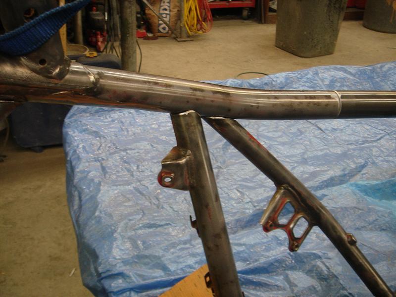

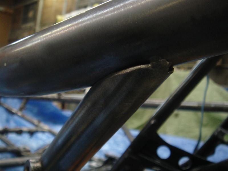

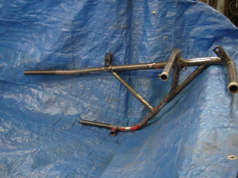

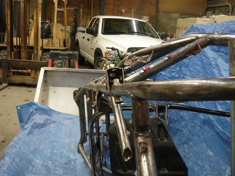

Problems I ran into with stretching THIS frame.
I should first state that I in no way trying to sell anyone on doing this type of modification, nor am I selling plans, selling this machine, ect. Quite the oppsite I'm doing this because I like to, I e-mailed Hoser about this subject before I started this post.
I also feel that I rescued this Pilot from the grave, yes I had some reservations on my first Pilot about cutting it up, partly because it was a nice machine, but I like the benifits of stretching the frame. One could leave the stock Engine/trans and use the length for leg room and elbow room or use the room for a snowmobile motor (( Internal Combustion Engine ? )). How it handles big jumps ect. I don't know as I have not jumped mine more than 5' in the air, and don't care to. Will it ball up with the stock suspension? Don't Know. Do I feel it is strong, of course I do, it has twice the metal thickness because of the inner sleeve.
With that said I will disclose all problems I encounter, I will not sugar coat this to make me look better, lord knows I need it though. I do know some of my fears of doing this modification for the first time would have been less if someone before me tried this, documented it and had success. The last thing I want is someone to try this and get left with a cut up mess and in need of another frame at who knows what price.
Wayne
File comment: The seat mount all the way backwards. The distance I need to clearance is the same throughout.
File comment: When I cut the bottom tube and moved it backwards 1.5", the splay of the bottom frame moved the seat mounts out on each side.

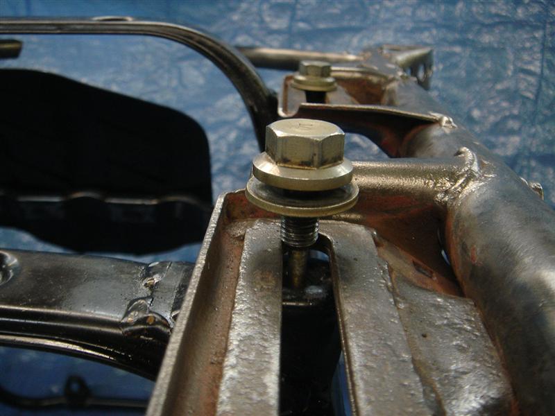

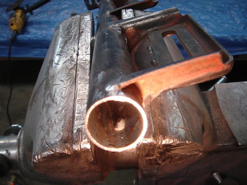

File comment: Original weld pool form the factory where it got too hot and sagged in. This must be clearanced in order to slide in the inner sleeve.

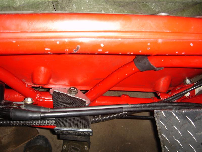

There is probably a good reason for it but why do honda use those bolts on the seat mounts (bottom picture)
Leegb, not sure what you are asking. The bolt is a flanged washer bolt with a pilot. The flange spreads the load out, this is needed because the slot has a lot of area under the bolt head that is not supported, a flanged bolt has more area under the head to compensate. The washer prevents the torquing of the bolt from trying to spread the slot apart. Otherwise the turning action of the bolt would try to widen the slot with repeated installations. The pilot on the end of the bolt makes it easier to start the bolt in a mass production setting. You place the bolt in an impact gun, jamb it in the hole and the treads start correctly almost every time.
PostPosted: Sat Jan 12, 2008 10:42 am
Posts: 885
I beleive i have one of the "almost" bolts on my pilot :shock:
PostPosted: Sat Jan 12, 2008 10:50 am
Lee wrote:
Look closer at the end of that bolt, need a picture? I cut then end off all mine (hoserized ) because its a pain in the ass to get the first part started, IMO I think the end of that bolt was something to do with safety or to keep the bolt from falling all the way out when making seat adjustments than speed of assembly, I cut them off to make it faster and easier to start them when removing and installing the seat, I bet you could drive the Pilot 1000 miles with a bolt lose and it would never fall out it would just dangle their.
Maybe AKPilot can post a pic of his if he has not cut the end off like I did :-)

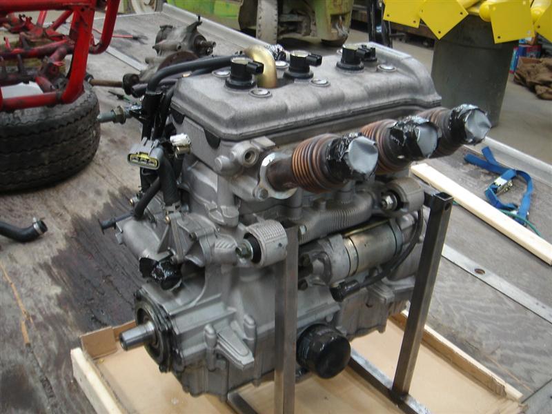

Now that the width and length is what I want, my Engine of choice is going to be a 4-stroke Yamaha Rage motor (( Internal Combustion Engine ? )). If I could not get what I wanted I was going to keep it stock for now, eventually maybe my son to put in a Polaris 800. I originally purchased the Rage motor (( Internal Combustion Engine ? )) to go into a Rorty's new stadium car because the size seemed too large for a Pilot Engine bay. The motor (( Internal Combustion Engine ? )) was enroute when I purchased this Pilot, well my mind started turning. Here is some pictures of the inital setting in of the motor (( Internal Combustion Engine ? )).
Note: In picture #1 the motor (( Internal Combustion Engine ? )) is in backwards. I really wanted to mount it like this and I believe it is possible it is just not practical. Their was 2 ways I was looking at doing this. First manufacturer to reverse a motor (( Internal Combustion Engine ? )) in a sled is Fast Inc. sno-go the Blade. It did not use a jack shaft/chain case, it turned a gear/reduction on the right side that turned the drive shaft, so the Engine spinning counter clockwise to the clutch again turning counter clockwise to a gear turning with the secondary clutch to a gear mounted on the final drive turning clockwise. Anyway the Blade is no longer in production but Arctic cat uses the ACT which is a gear box that uses planitary gear to get reduction. I thought if I just got rid of the planitary gears then maybe it would work. I decited for simplicity sake and the fact I would have to have reverse cut helixes I'm mounting it with the carbs in the back of the seat.
Wayne
File comment: 2005 Yamaha Rage motor (( Internal Combustion Engine ? )), 120 H.P. 973 cc three cylinder, carb version. The new version is the Nytro and it is slightly larger displacement but fuel injected. I opted for the ease of the carbs and the availability, the Nytro is 2008 model, although I was
File comment: The airbox will be tight. this pic is with the seat all the way forward. With stretching it 5" in the rear this is about what I should have with the seat all the way back, maybe a 1" more.
