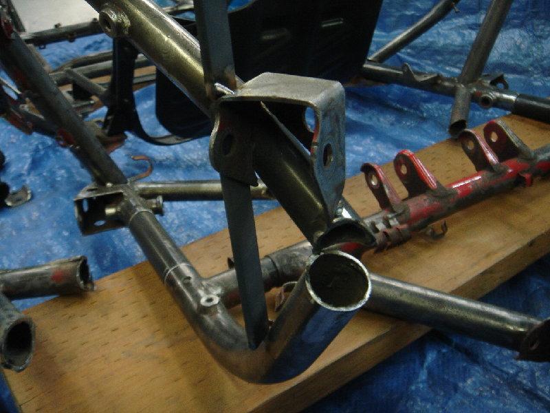

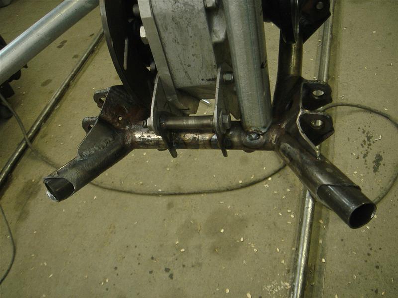

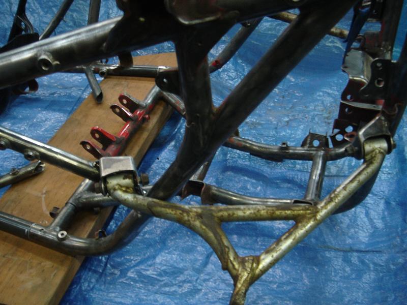

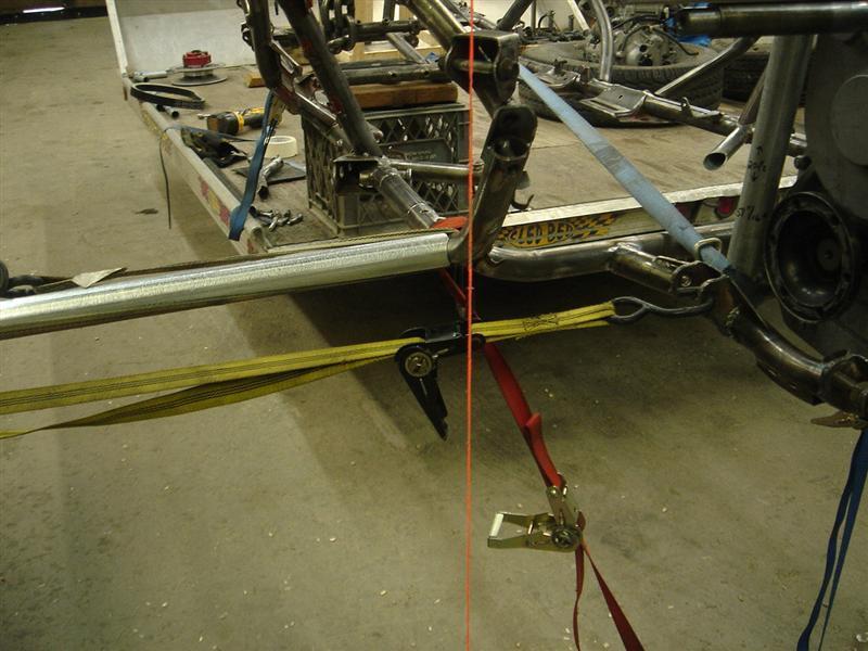

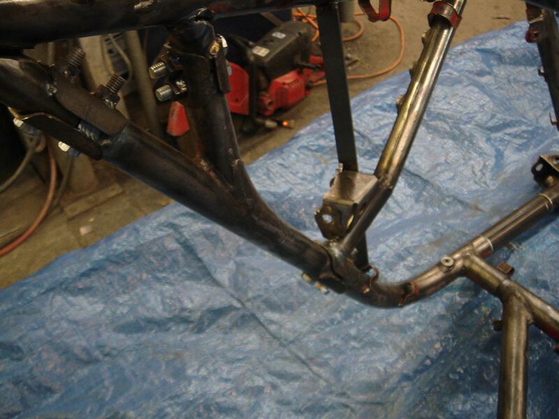

The A-Arm relocation frame worked great. It's sure nice to get that out of the Engine bay!
Right now the diagonal brace and the frame stretching will just well tacked for now as I fit the Engine and trans into the frame.
Progress will slow down a bit as I need to make 10 sets of frame attachment fixtures. These fixtures are patterned after the roll bar attachment points. I'll need 3 sets (6 each) for the removable frame member for the secondary clutch, 4 each for the front of the motor (( Internal Combustion Engine ? )), and who knows how many for the rear of the motor (( Internal Combustion Engine ? )), or make hard mounts. With hard mounts in the rear I fear the trans will be a pain to get out. I need the Engine mounting points in the front of the Engine to be removable or else I'll need to remove the Engine out the top and I don't want to remove the cage to get the Engine out.
Wayne
File comment: Inner sleeve getting cut to fit. Bending the tube did not look good and was too far into the Engine bay. I decited to miter the pipe, and double the miter.
File comment: Left diagonal brace mitered, inner sleeve welded and now ready for welding and install.
File comment: Left diagonal brace installed
File comment: A-Arm installed. Not much movement in the A-Arm before it hit the frame, this modification definately needs the LT A-Arm. Nice to have my Engine bay back!
File comment: This is how far the frame moved out from the original spot. Thus the miter to bring it back in.

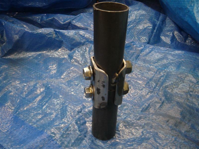

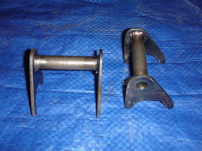

Frame attachments.
File comment: Complete big unit, except fully welding clamps to the tubing. This will weld directly to the 1.5" lower frame tube where the 2nd roll cage hoop will attach. It will be in the stock location as the stock attachment point moved back 6.5"
File comment: One half completed, I weld 1/2 way around (as far as I can go) the crush sleeve to the inside of the tubing.
File comment: Frame attachments comming together. I use a 1/2" drill bit and drill out one side for the crush sleeve. I go through and drill out the other side only half way throught the other side tubing, then "sharpen the crush sleeve on a belt sander so

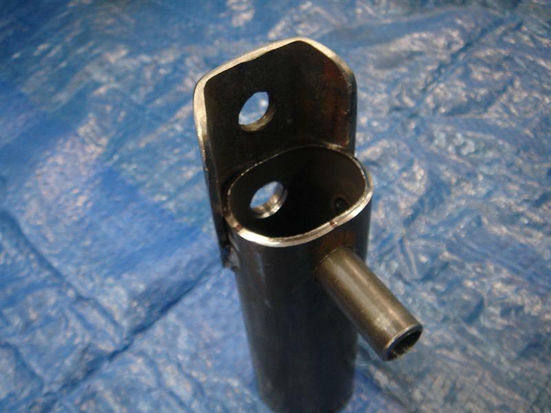

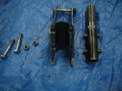

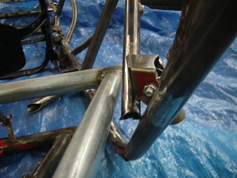

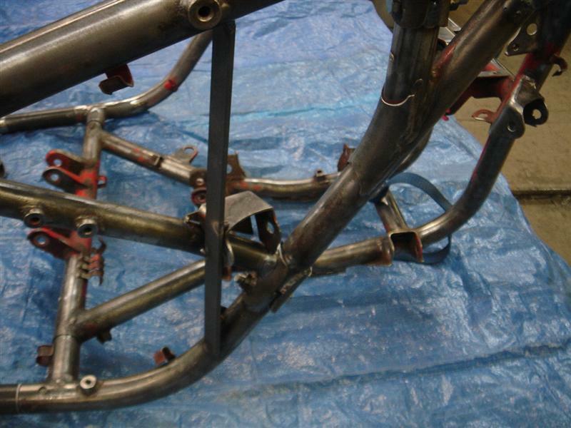

Removable frame member for servicing the secondary clutch. I used this method on my FL800 and with great results. It was a no brainer for me to do it again, as I feel this is really strong. Another point is I'm using LT on these Pilots so the bottoming out forced are not transfered above this removable frame member as it would be in a stock Pilot, so how much force is really placed right here?
File comment: Need to attach the diagonal brace to the backside of the attachment point. I welded in a 1" brace while making the removable frame member.
File comment: The cut away piece, soon to have attachment points on it to bolt back in place.
File comment: Cutting away the frame.

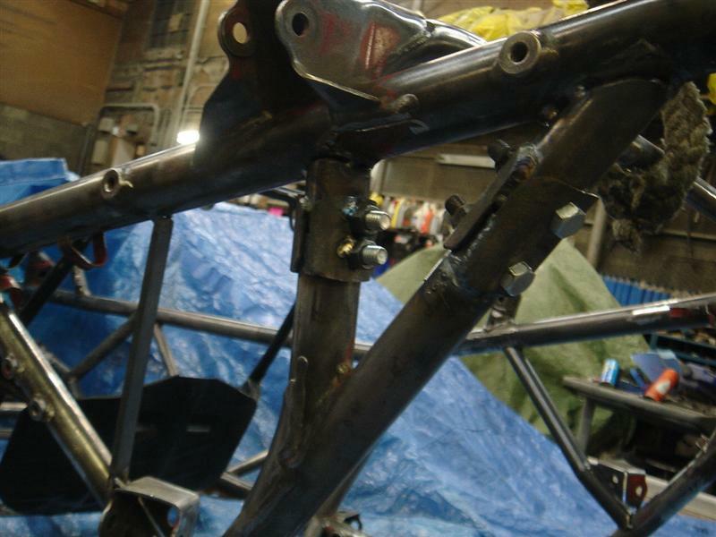

File comment: Another angle, notice the diagonal brace welded into the back of 1/8" steel of the attachment point. Inside the diagonal brace is a welded nut, 3/8" on all bolts.

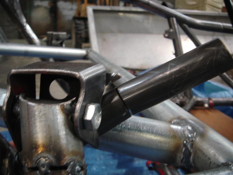

File comment: The top attachment is a shorty, the nuts are kind of close for a ratchet but just makes.

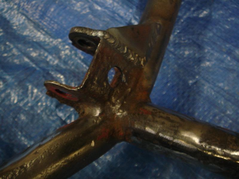

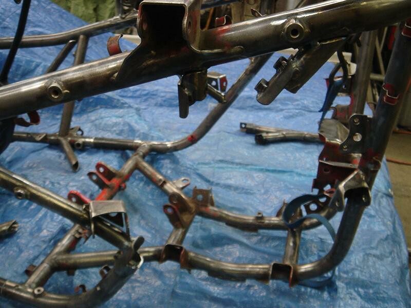

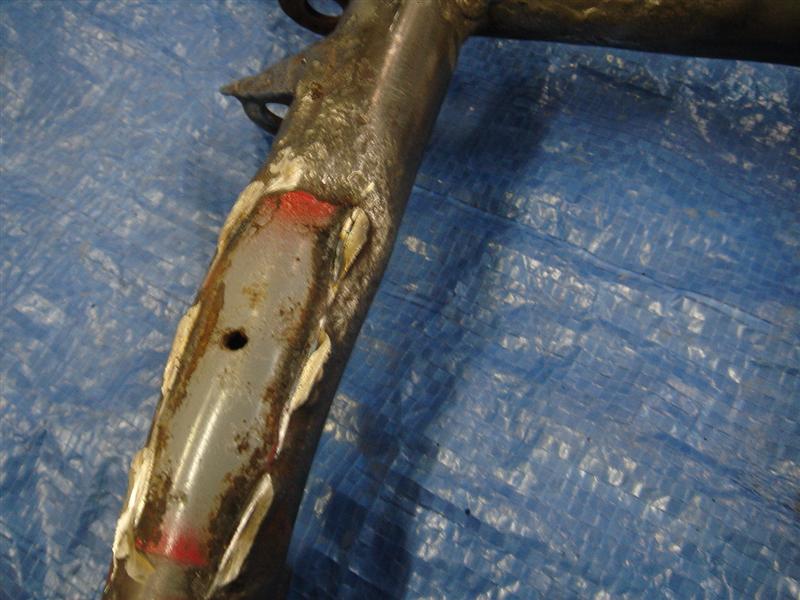

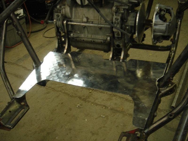

Well I finally was able to spend some time on the basket case, been reinforcing the rust.
The bottom of the transmission/Engine cradle is rusted pretty good, so much so that I decited to reinforce the lower suspension mounts.
Wayne
File comment: I'm welding all around the reinforcements to keep out moisture.
File comment: Here you can see the webing totally rusted away.
PostPosted: Wed Feb 27, 2008 12:42 am
Posts: 185
Location: Anchorage Ak
At one point the bottom Engine/transmission cradle took a big hit, don't they all :shock:
Wayne
File comment: Cut away skid plate, I then bent it back the best I could then rewelded it.
File comment: Skid welded back in. I'm thinking I'll well all the way around to once again seal it. You can also see my reinforcements webing and the stock webing almost gone.

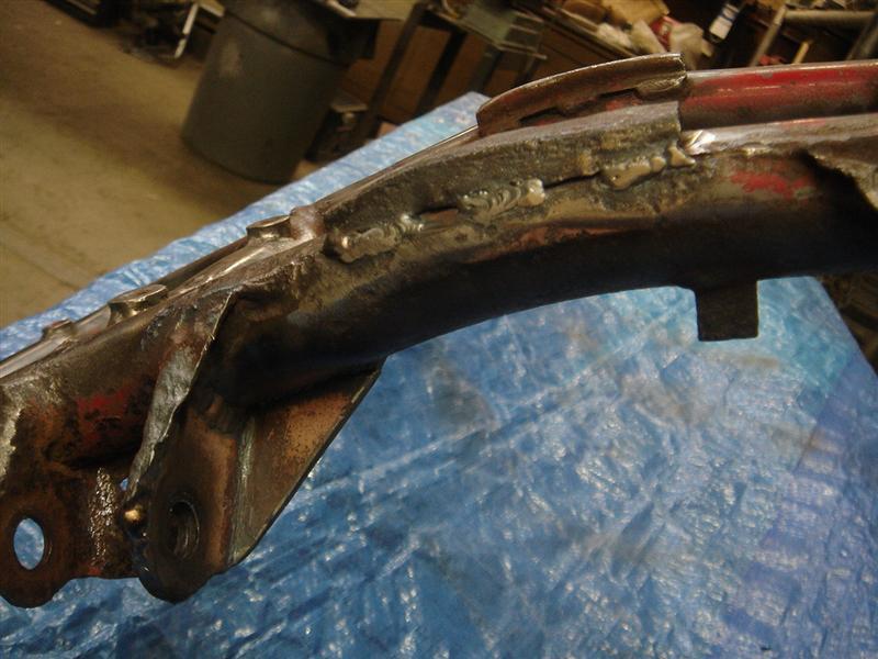

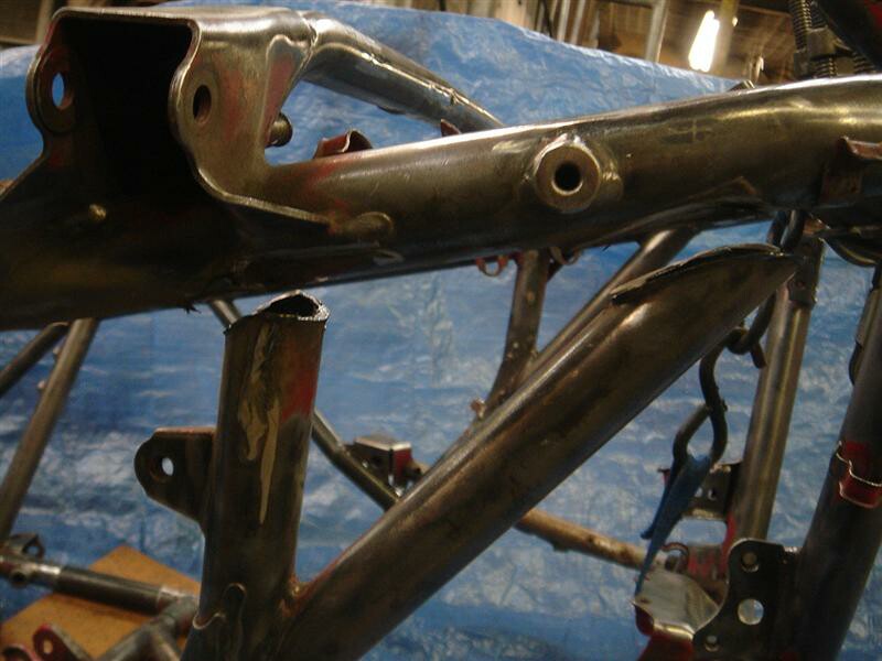

PostPosted: Thu Feb 28, 2008 10:46 pm
Posts: 185

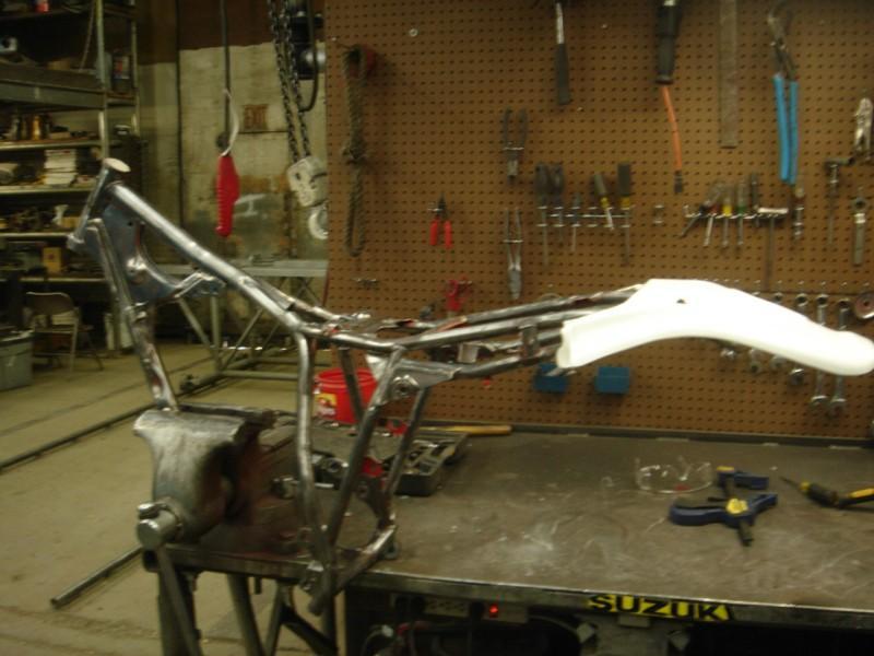

It's starting to look a lot like a Pilot! kindof

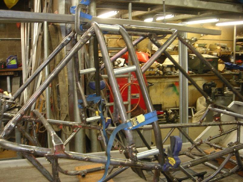

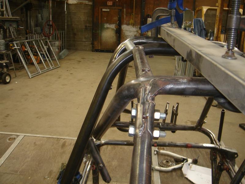

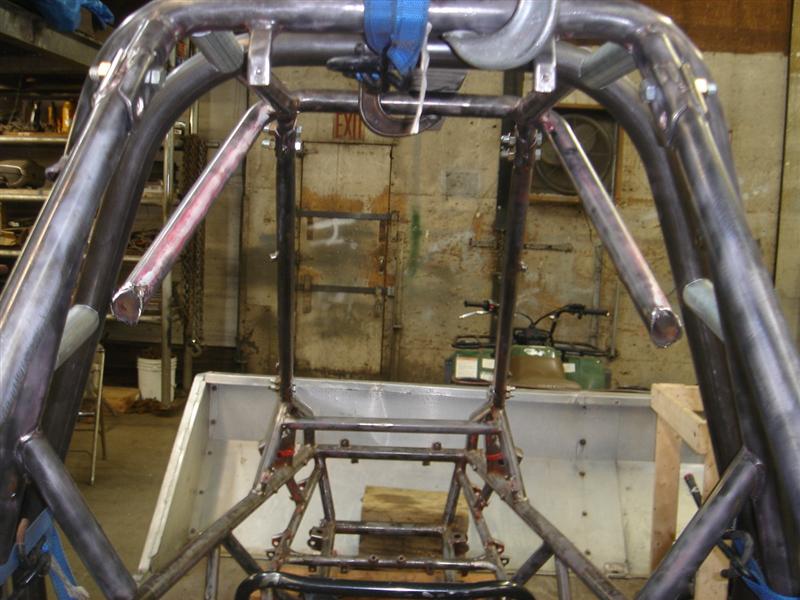

Well I got the second main hoop for the rollcage yesterday and wanted to mock up how it will look, well the bends don't match up very well at all. I was afraid of that, with the stock hoop and the new bent hoop being so close to one another I thought it might stand out. Honda uses a very tight radius on their 1.5" hoop, so I will be forced to have a second hoop made up. On the Fl800 I purchased a used hoop, but the cost of the roll cage and shipping made me look elsewhere this time. Oh well I guess IF I do another Pilot I'll already have a second hoop :-) Or my wife will commit my arse.
Wayne
File comment: Cutting the stock rollcage apart. The cross member is so rusted it will need to be replaced, too many holes.
File comment: This cross member is so rusted it will need to be replaced. I'll cut out the seatbold bosses. Wonder why Honda did not use the inner rust preventitave on the main roll cage? The main cage hoop is not nearly as bad.
File comment: I think the 4" center to center looks better, maybe because I'm used to it.
File comment: The 6.5" center to center looks odd to me. Too much space between the hoops. I've been thinking of sliding the front hoop towards the Hailo bars approx .5", then move the second hoop 2" foreard and lenghtening the back down bars. This wi
File comment: Here you can see the bends not looking good at all. I have no choice but to eliminate the stock hoop and get another one bent up.
File comment: The upper Hailo part of the roll cage needs to be widened so they match up with the wider hoops, also either the two hoops need to slide forward or lengthen the Hailo bars as they did not stretch as far as the frame, you know the whole A sq +B sq = C sq.

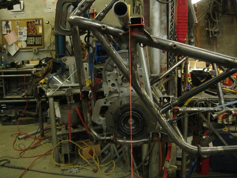

PostPosted: Mon Mar 03, 2008 8:55 pm
Posts: 185

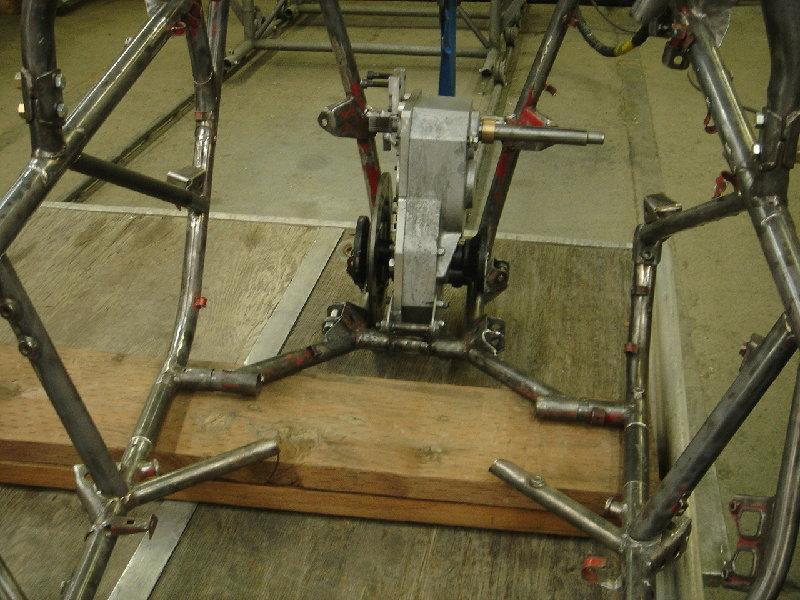

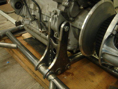

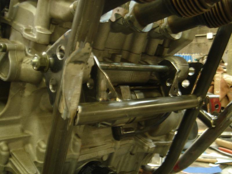

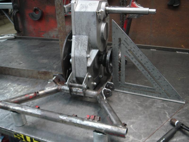

With the Engine/transmission cradle out it made it much easier to repair the rust and mount the RPM transmission. I took out the trans from the FL800 as my new one is still on order.

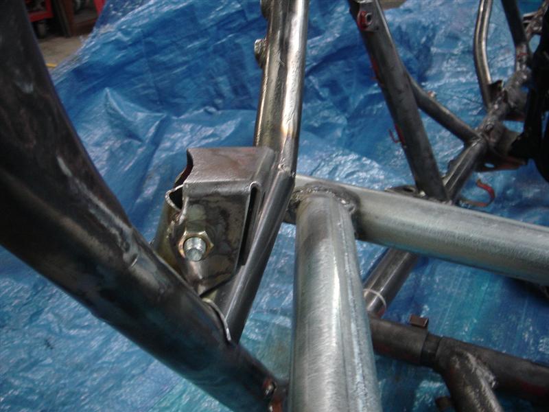

I made mounting tabs for plates that bolt to the sides of the RPM, the front tab will be a piviot point and the back and the top (hat) will be slotted so the trans can piviot forward. This makes for easy belt removal and more importantly allows me to use many different belts lengths (with in a certian range) by setting the belt deflection. I think the center-to-center distance between clutches changes 3/4" which translates to a 1.5" difference in outside circumference.
Wayne
File comment: I needed to cut out the crossbar for clearance. It looks like the left side will need more clearancing, this 4-stroke is BIG.
File comment: Centering up the RPM by the 930 cups.
File comment: Mounting tabs.
PostPosted: Wed Mar 05, 2008 1:16 am
Posts: 185

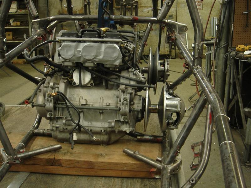

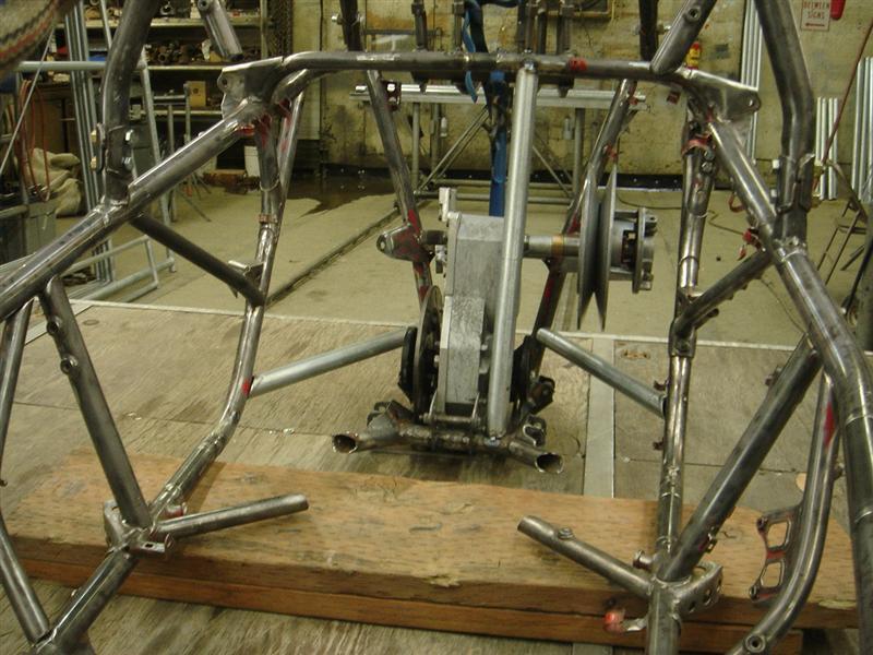

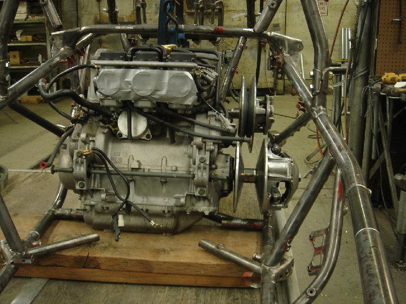

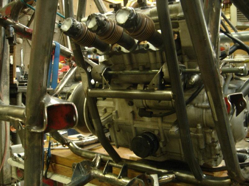

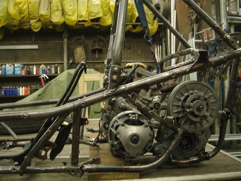

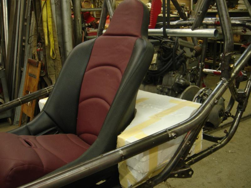

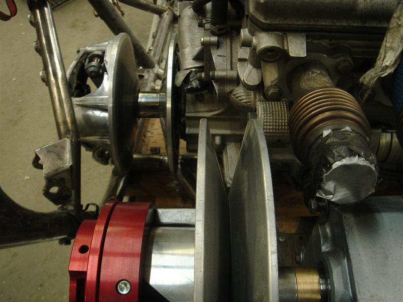

Well, I set the Engine in this weekend. That's about all I can say, the light at the end of the tunnel is getting dimmer! Those high Engine mounts are going to be a bioach to build. Not only are they high but they need to be removable. I'll definately have a low center of gravity!
The Engine is so tall it will be .25" above bottom of frame and just clear the crossbar for the seatbelts. I'm thinking I'll need the seatbelt bar removable to remove the motor (( Internal Combustion Engine ? )). With the Engine so far to the right the Engine cradle will need to be cut back almost to the lower suspension mounts, it's still not far enough to the right in pic #001.
Hoser/Anyone, what is the safe height distance for the seatbelt bar to be at behind the seat? Can I move it up say 2-3 inches? Or does it need to be lower than the seat back height? On my FL800 it is the stock height but this monster is tall, I REALLY don't want to remove the cage to get that motor (( Internal Combustion Engine ? )) out!
Wayne
File comment: The long bolt in front is the motor (( Internal Combustion Engine ? )) mounts. Front not so bad, the rear are on the cylinder. The motor (( Internal Combustion Engine ? )) is not centered to help line up clutches, secondary out 2.5" from where the FL800 is.
File comment: This is the spacing with the longest belt I can find, Mach Z belt. $140 from Skidoo or $100 for Ultimax 3's, OUCH time to look for another belt! This Engine sits on block and is just clearing seatbelt bar. Rear mount same height as RPM input shaft.
File comment: Engine centered, secondary pulled up to FL800 spacer. I'll have to do some creative things to get side to side balance back. Engine needs to move over. Exhaust just clears RPM.

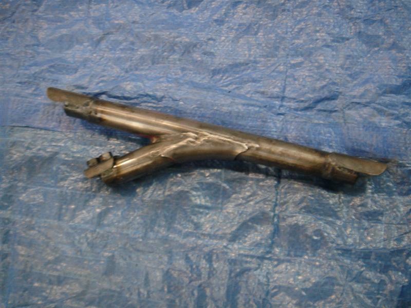

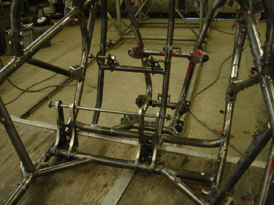

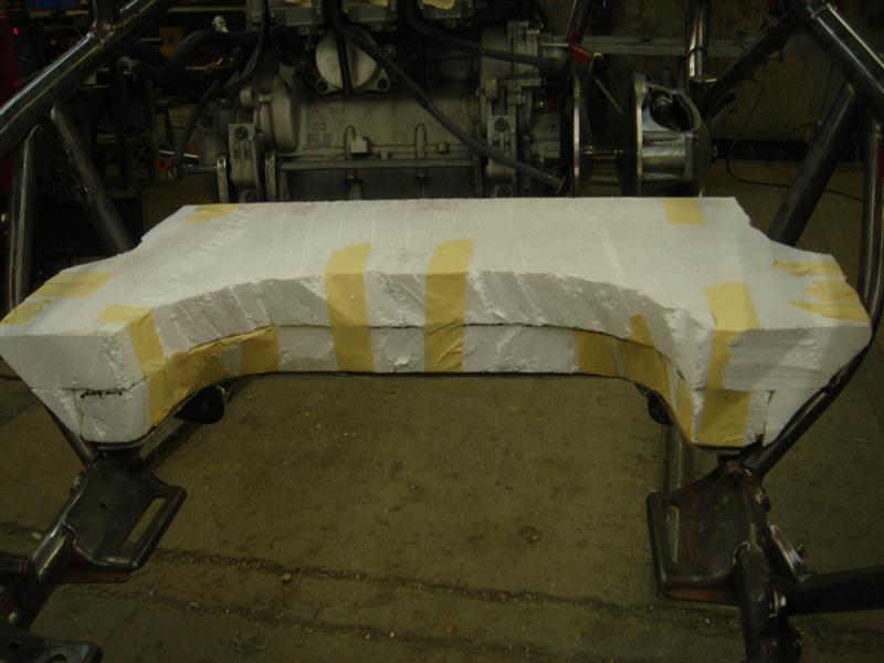

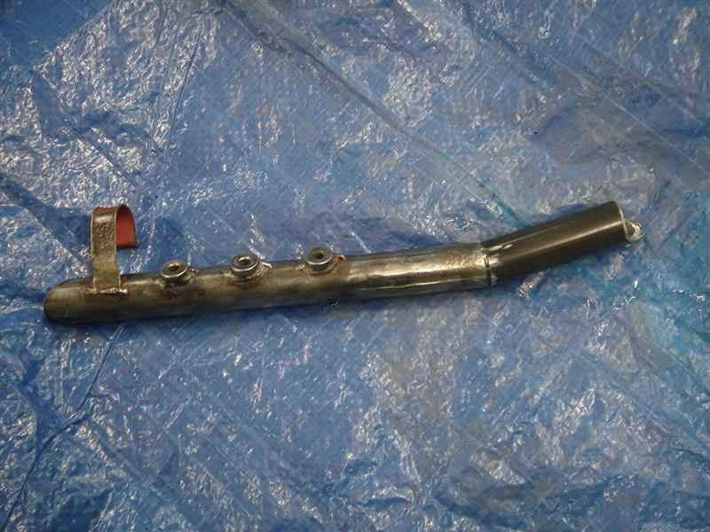

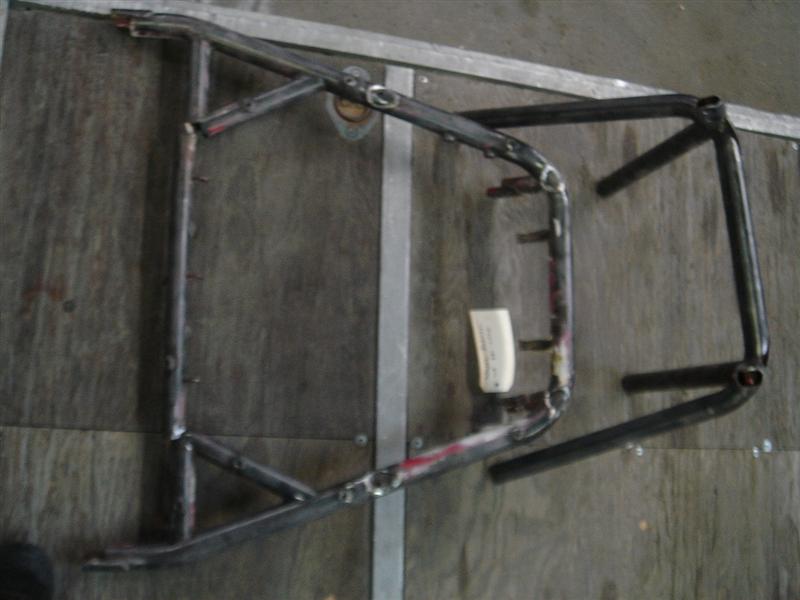

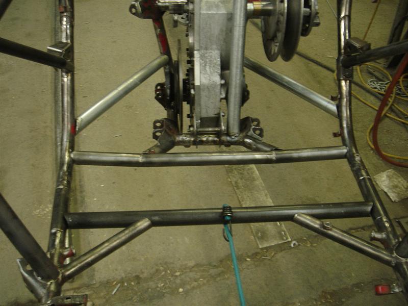

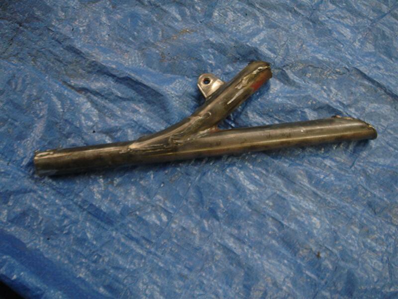

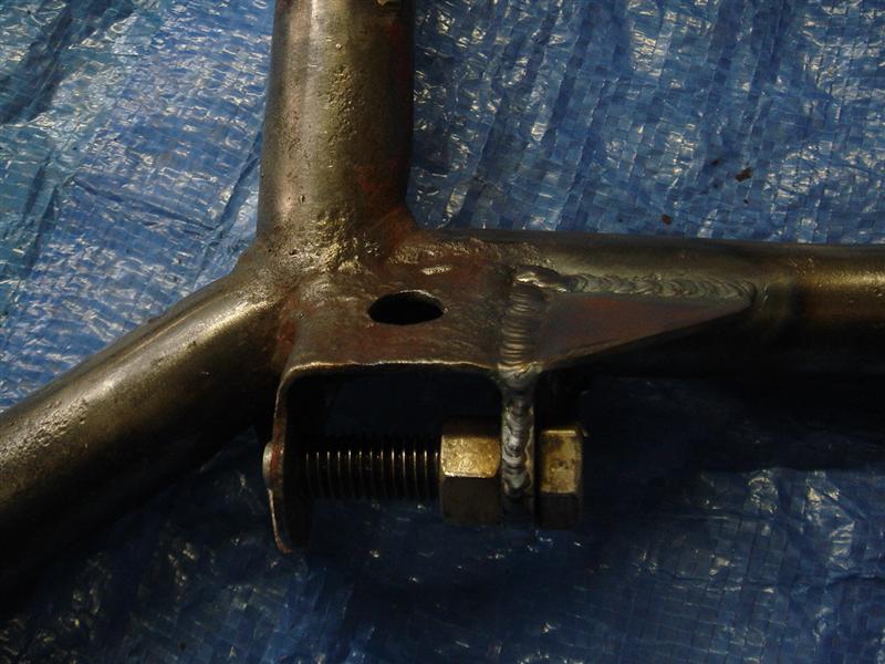

It's been awhile since I posted my progress here, but I have been working.
Wayne
File comment: This is the first gen cross tube, I had a new tube bent at both ends, as this mitered one came too close the the Engine.
File comment: I inner sleeved the cradle
File comment: First I had to cut back the trans cradle way back as the Engine sets low in the chassie. I used pipe to locate the cradle in it's position.
PostPosted: Mon Apr 28, 2008 12:33 am
Posts: 185

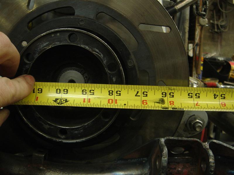

Centering up the cradle in the chassie.
Wayne
File comment: Pulling the cradle into position.
File comment: centering up the CV cups with the chassie.
File comment: Front to back distance the same. and yes I had to pull, and twist to get measurements the same.
PostPosted: Mon Apr 28, 2008 12:54 am
Posts: 185
Rear Engine mounts. I kept the Engine .5" from the bottom of the frame.
Wayne
File comment: I attached two 1" tubes from the bent tube that the trans cradle attaches to the original Honda cross tube between rear shock mounts
File comment: recessed the PTO side bar for the trans access as the trans can "rock" back and forth. Notice the bottom "bent" cross tube as oposed the mitered one. Much more clearance on the mag side.
File comment: Trans and "top cap" can rock forward and backward I think it travels 3/4". This is a big help with setting belt deflection which ever belt I end up with, also for belt removal. Rock it forward slip off belt.
PostPosted: Mon Apr 28, 2008 1:37 am
Posts: 185
The front Engine mounts were much harder to figure out. I needed them to be removable.
Wayne
File comment: Finished Engine mounts. I plan on using the long bolt on the front mounts that will tie into the PTO frame side cross bracing to eliminate side loads. This is assuming I can cut off some of the Engine block casting blocks for the spreader tube clearance
File comment: WIth the Engine weight down the bolts spin freely. I planned to place two more bolts in the cross brace, but if my cross brace idea works I don't think I'll need them.
File comment: The cross tubes have Pinch tubes for 3/8" bolts. The Engine weight sets on the removable mount not on the bolts
PostPosted: Sat May 24, 2008 2:15 am
Posts: 185

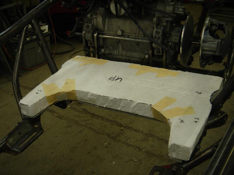

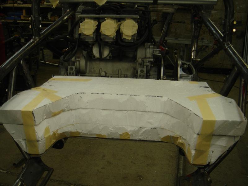

been playing with styrofoam!
I decited to mock-up the tank in styrofoam so I could make a pattern. Hopefully this will keep the "opps I need a filler peice here" down to a minimum. With my FL800 it was MUCH more complicated so there was more filler peices because of the angles involved. I think filler pieces will stick out on this one, although the wrap-around peices will be challanging to make with out a lot of weld lines. I sure it'll have a few though.
I'm still waiting on the second hoop to be bent, it is holding up the filler neck, oil tank, radiator ect. Seems like everything is held up by that.
Wayne
File comment: Made the bottom of the gas tank. I used 3 each stock Engine/trans mounts.
File comment: The rectangle area measures: 8" X 26.5" X 8.5" so far with 4 layers of styrofoam. It should work out to 9+ gallons with out the "wrap around sections"
File comment: I have decited to make the oil tank on the left side (PTO) and the filler neck to help off set some of the Engine weight that's on the right.

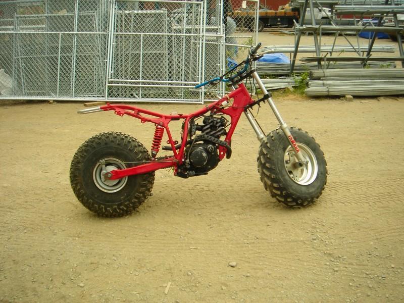

PostPosted: Wed Jun 11, 2008 1:44 am
Posts: 185

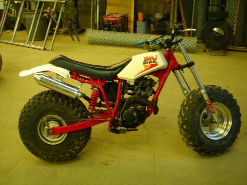

Well I'm still waiting on parts for the Rage Pilot.....so I picked up a "quickie" project. I thought you guys might appreciate this one.
Wayne
File comment: Picked up a 1986 Yamaha BW200. I would have liked a BW350 but hard to find!
File comment: The strip down. This is the absolute most difficult airbox I have ever seen. You must take off the exhaust and slip the entire box out the back to open it up and clean the filter.
File comment: The Yamaha plastics were more money than the bike cost me if they were even available. So I got some off E-bay from DC plastics that fit the 350 and modified the rear frame to accept it.
File comment: Rattled caned the frame, put in new bearings, seals in it and started the assembly. At the end of the frame is the aluminum extension to help out the rear fender. I need to make one for the front fender as well.
File comment: Near complete. I put on a cheap "loud" exhaust that is interchangeable with the stocker. I'm sure the HP nut in me will have this apart again to wedge in a XR400 or something. There is just nothing I can do for this old of a motor (( Internal Combustion Engine ? )), no hp part
