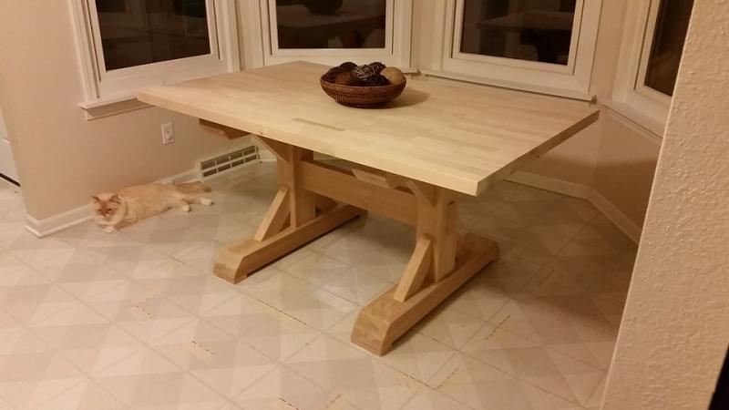

I built a 64" x 40" red oak dining room table for my house. This is what I've been working on in my shop instead of buggy stuff. Wife found a farmhouse style table at PotteryBarn, but the price was WICKED HIGH like....$2k without chairs! So I built one for $650 and bought $350 of chairs. Also acquired a 6.6" joiner, 13" planar, and a commercial Craftsman table saw (my motivation for building a table, ha!) in the process.
Picked up some "real" red oak from a sawmill in SE Michigan and learned #1) it ain't cheap and #2) it ain't light.

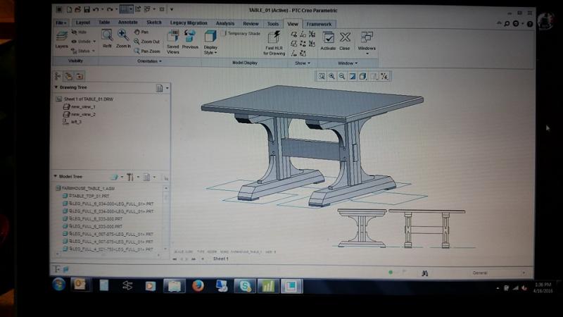

Found some plans online, but needed a custom size to fit our fining room nook. So I drew one up in Pro/E.
In my spare evenings/mornings when kids were asleep or busy having fun, I managed to find enough hours to make this thing happen. The results were well worth the work & $$! A happy wife makes a happy house. :-)

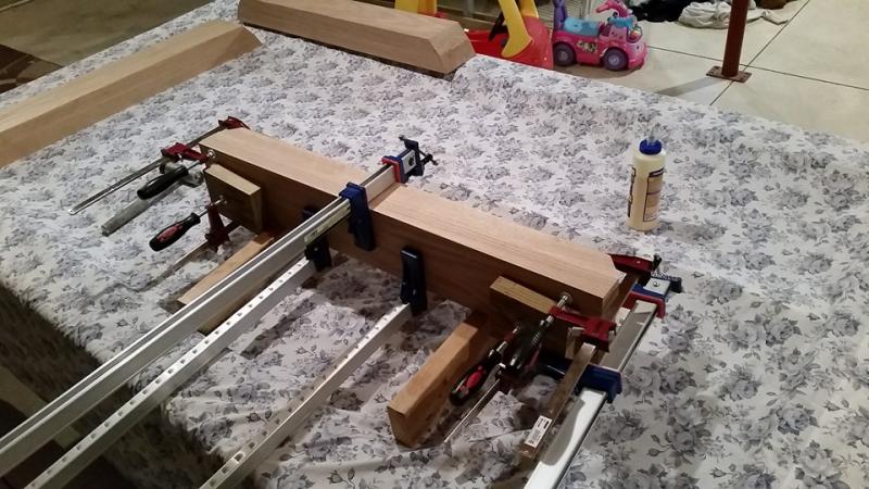

File comment: Couple clamps...

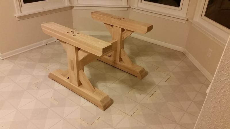

File comment: My original cad design. Only changed the gussets because my band saw didn't have enough @ss to cut arches in 2" thk oak.

Nice job!...beautiful table
PostPosted: Mon Apr 18, 2016 3:50 pm
Awesome job dude! I like heavy tables.
I used to do a lot of woodworking, but not so much lately.
Did you glue up the top or is that a purchased part?
PostPosted: Mon Apr 18, 2016 4:45 pm
Looks great. Love the finish. What did you use to clear coat?
PostPosted: Mon Apr 18, 2016 8:17 pm
Looks so nice I almost wouldn't want to eat off of it
PostPosted: Tue Apr 19, 2016 6:26 am
The top I got at Lowes. It's a 1.75" thick piece of butcher block in Baltic Birch. I trimmed to length and sanded the snot out of it.

Beautiful table, nicely done. I'm glad the gussets ended up the way they did.
I rustic piece like this doesn't need no stinkin :-) flowy curves or bends.
Strong straight wood ( Baz. ) is how it should be.
