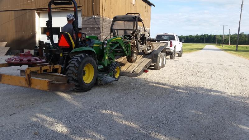

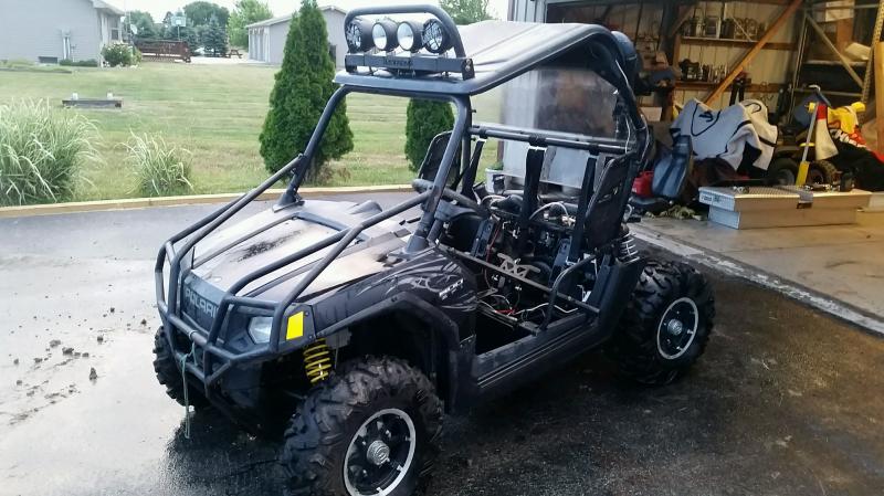

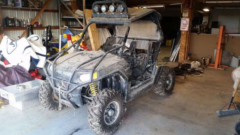

Couldn't resist. Just sold a mower & trailer, and this popped up on CL 7min drive south of my house. Bingo!
2010 RZR 800 EFI with winch, roof w/ speakers & cd/fm, roof lights, front & rear bumpers, snorkel, stiffer front springs, 4pt harnesses, front & rear windshields, and 4 new tires. Has 147hrs and 1100 miles. Bed, seats, etc are not shown in pics. Straight frame, straight axles with good boots
Seller was a good dude, too. Original owner with title. He was asking $4k, and I got it for $3.5k. He even delivered it! Helps it was down the road. Farmers are good people. Period. Said all his buddies sold theirs a couple years ago and its been sitting in the barn since the clutch broke. Then he broke the starter gear.
It needs...
- Desperately power-washed
- New driven clutch installed (new parts included)
- New starter bendix installed (new parts included)
- Seats & bed reinstalled
- Battery
- Headlight bulb
- Few minor aesthetics
- Basic carb cleaning, new filters, new fluids, safety check
Plan is to just get it together and bugs worked out and tool around. Roof halogens will be replaced with an LED bar. Plugged in a battery and all the accessories and dash work fine.
Will be working on it all week after kids are in bed. :-)
-D$

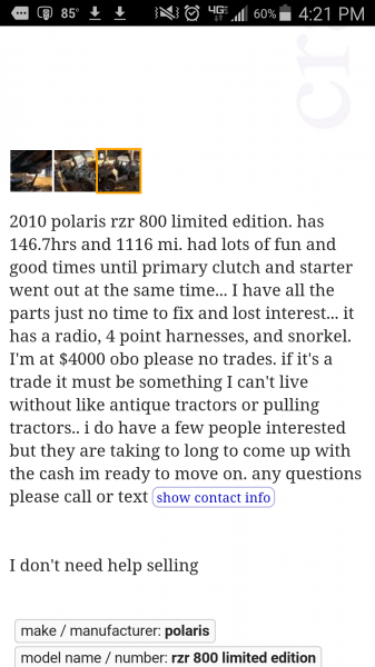

Here's the ad...
Listed it 9pm last night and i was on my way at 3pm today. He had 6 calls on it today, but I was the closest and had cash ready to spend. Money talks!

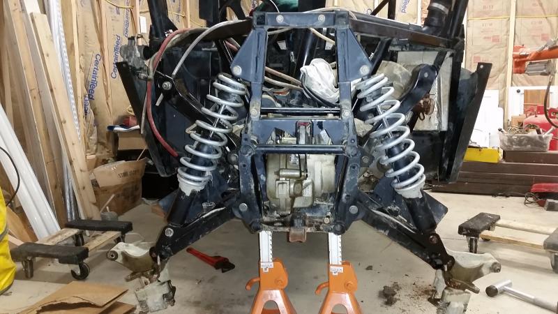

PostPosted: Fri Jun 24, 2016 12:44 am
Engine mount bolts, coolant lines, and fuel line....and this baby is free. Need to fetch my Engine goist from my old man. I see why the seller eas hesitant to make this repair! Solid 2.5hrs on this tonight after kids were in bed. Feels good to burn some midnight oil!

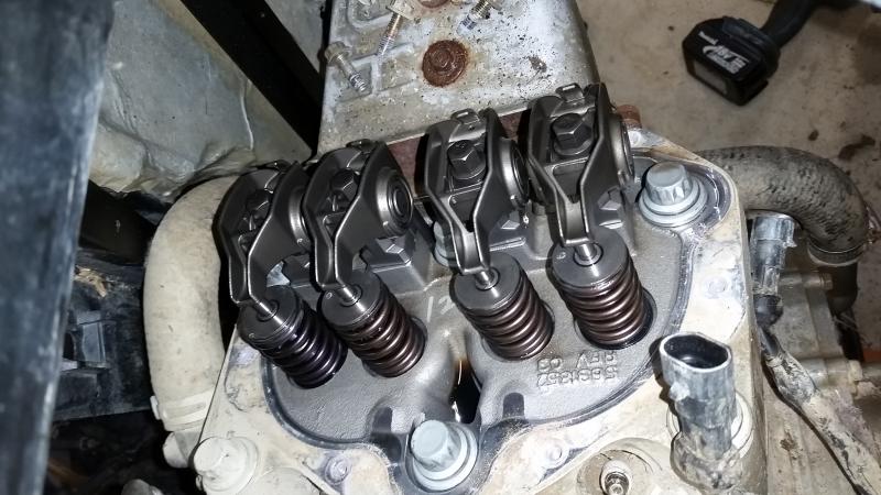

Also pulled the valve cover to make sure she didnt sit in a pond for a weekend, ha. Looks fine.
Tell you what, the only way i could get all the mud off is to tear it down. Good Lord!
Added rear carrier bearings to the list, and might as well do fronts as well. Cv's look great.
What else should i replace or upgrade while i'm spelunked this deep??

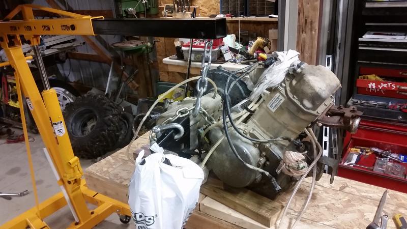

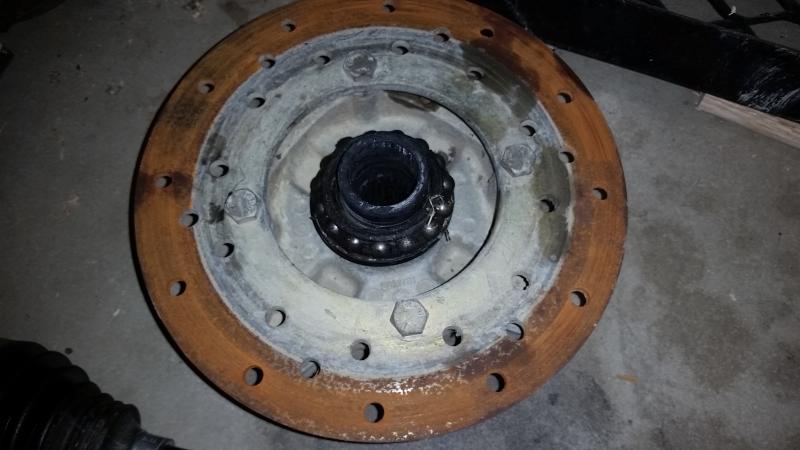

Engine/trans/diff are out. Came out with not much fuss, but a lot of steps. Tedious.
Will be replacing the bendix, plus performing 2 preventative mods as recommended by the RZR forums while I've got it apart:
1. Changing rear diff pinion nut from the RZR nyloc to the Ranger steel nut with loctite. Its a nut that is known to backoff. You gotta keep your nuts in check, eh!
2. Removing trans brake pawl bolts, and reinstalling them with loctite. Some have backed off and trashed the trans case.
Besides cleanup everywhere, will also replace all 4 wheel bearings and the rear diff seals.

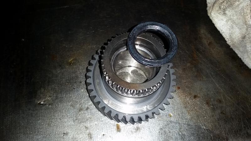

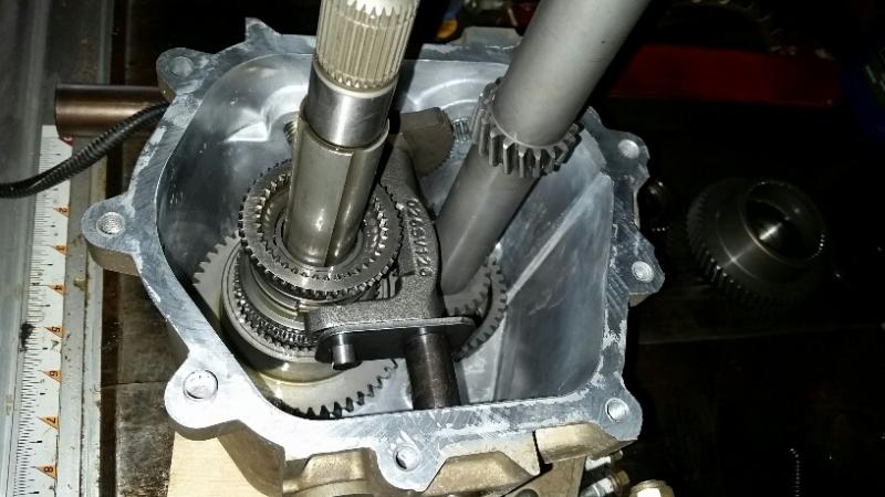

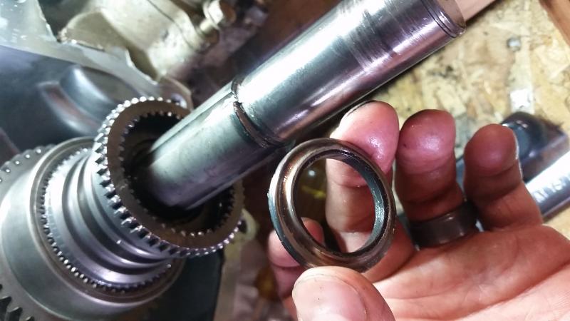

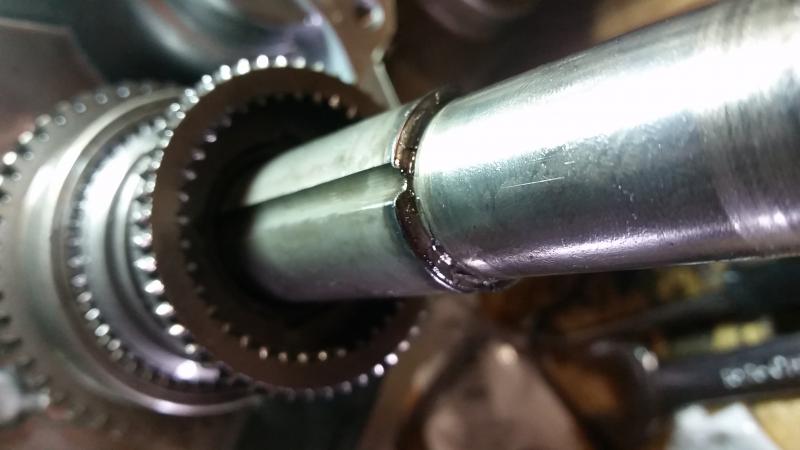

Found some metal flake in the trans fluid. Upon deep dive inspection... :shock:
Drive gear in trans is broken. Polaris only sells the whole trans shaft, gears, bearings, etc as a kit....for $581. Will be in this rig $4250 (so far). Still in it to win it.
File comment: There is a thrust washer fused to the broken piece

File comment: Shaft is mushroomed

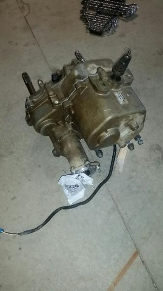

I just separated the trans from the Engine last night, and then gutted the rest of the trans. Its logically yard-sale'd in my shop right now, lol.
The (2) actual repairs needed here both required the Engine to be pulled were:
[1] Starter bendix was stuck retracted, and
[2] eventually discovered the "high" drive gear to be broken + shaft damaged.
Well you can't get inside the stator case or trans box without pulling the whole Engine/trans/diff assembly.
Bendix repair was as simple as pulling the cover, pulling flywheel, replacing bendix and its 2 washers, installing new o-ring on cover, and sealing back up.
Trans repair required complete and utter tear-down to replace the main drive gear set & shaft. The trans kit was $539.99 and includes oil seals. They won't sell the gear I needed by itself (list price is $265), so they sell the whole kit. I see why though. When something in that set grenades, its will also affect the other parts include in that kit. Also good piece of mind.

[1] Rear axle bearings were shot, so replaced both front & rear set with Pivot Works branded parts. When I pulled the axles, both rear bearings were stuck to the hub and just looked nasty anyways.

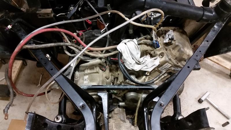

PostPosted: Thu Jul 21, 2016 2:14 pm

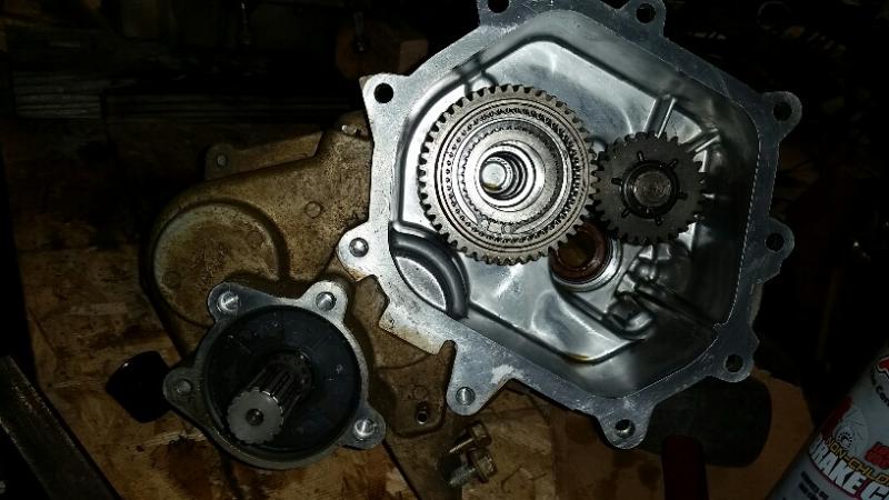

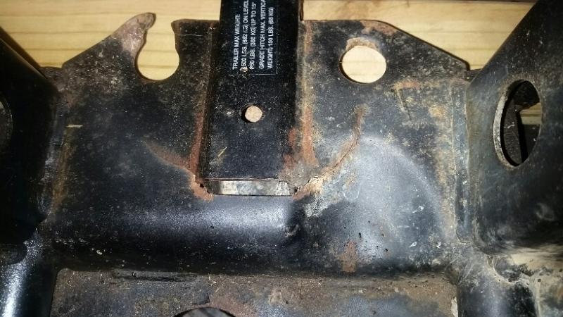

Trans is back together. Was a pretty simple job. The manual is pretty spot-on with clear diagrams & pics.
Just need to weld a couple ugly spots on the rear hitch, and this rig is getting re-assembled.

PostPosted: Fri Jul 29, 2016 1:59 pm
RZR powerplant is back in the frame. They go in a lot easier than they come out! New starter solenoid installed and cleaned up some shotty wiring of the roof stereo & lights. Will be glad when the power-sucking halogens are gone and replaced with LEDs. The wiring to the lights and stereo were 100% fire hazard! He was running a 30A fuse on lights & 30A fuse to light bar powered both off the same single 12ga hot wire. Eek. That's a potential 60A draw on wire that's designed for 20A.
Also gave the exhaust parts a face-lift with some high-temp paint.
