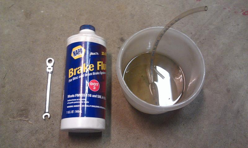

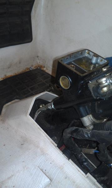

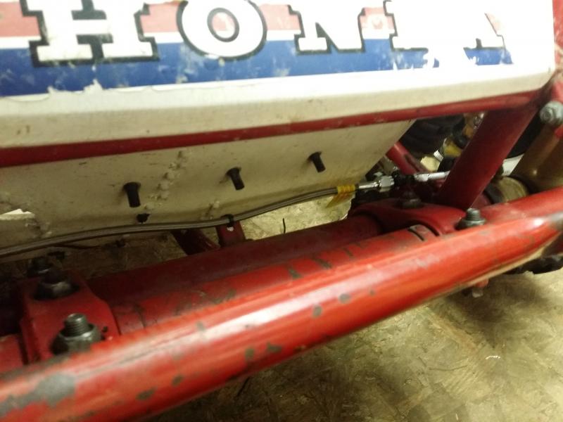

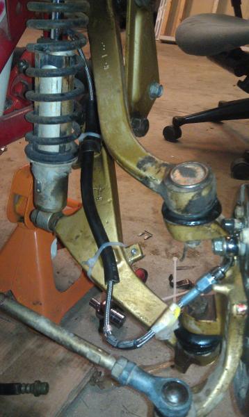

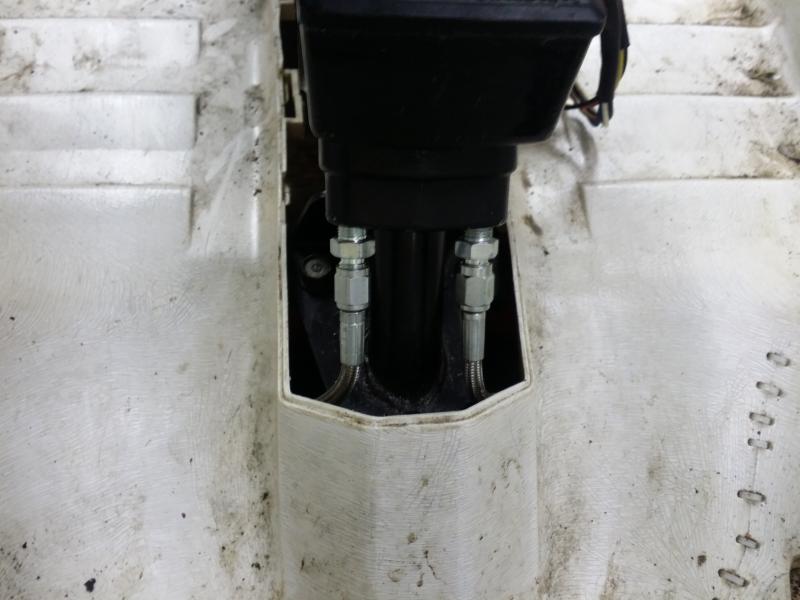

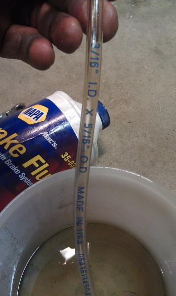

Got around to installing the front steel braided lines tonight. It's a breeze, man! And the difference before vs after is NIGHT & DAY. The new lines bled easy, too. I used a small wrench, small bucket, piece of clear hose, dot3 from NAPA, and my own lungs (suction) to bleed. Used some 1/4" heater hose as a pad where the steel hose touched the frame or any sharp edges. I'm uber impressed. :-)
You know, it could be the hardware, but it has to be attributed a little bit to getting all the old fluid out and getting a really good bleed. I bled the short side first, then the long side. Open the short side bleed screw, pull the brake handle, and suck the air out of the line. Eventually you can just suck some pressure and then tip the tu e up and let the bubbles rise out while holding the lever firm. Then when she's close with just tiny bubbles, I did half pulls on the lever until the bubbles were gone, and closed the screw. Then went AMD checked the short side to make sure no air trapped on that side. Dunzo. Have a beer nearby to wash away any residual dot3 from your gums. :-)
Some pics...can't really aww all the beautiful steel lines, but they're there.
Looking forward to road testing tomorrow after the rear conversion is bled & done!!!!
File comment: Simple bleed kit
File comment: Bleed hose to use

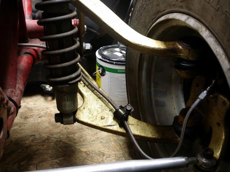

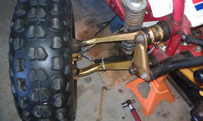

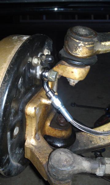

PostPosted: Wed Jun 11, 2014 9:05 am

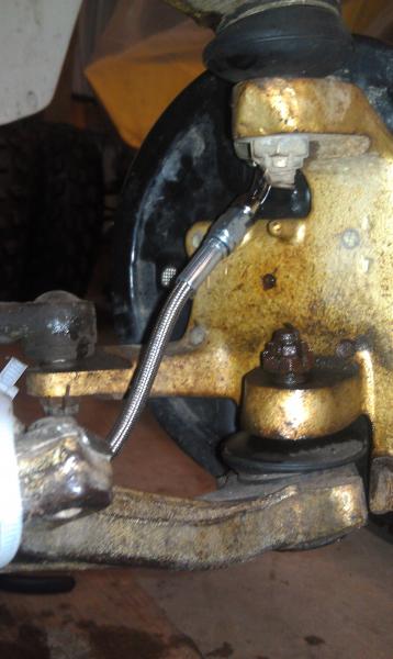

Couple more pics of the front. I tried a different hose-to-j-arm attachment method on each side. Mainly because the right-foot lower j-arm has a snapped bolt in the brake hose tie-down, and so I had to do something different than what I'd already done on the other side. And I figured I could demonstrate two different ways to skin the cat. I think I'll settle for a combo of both -- piece of radiator hose + both stock brake line clamps.
The right-foot side brake line shown is 2" longer than the one in the kit. I couldn't wait any longer, so I just installed the longer one I had.
I also cleaned out the banjo bolts really good with some good ol' Brake Kleen. Both bolts had this plaque / build-up crap on the lower section.
Sheesh...my buggy needs a bath! :shock: Plus, its always funny how fast the shop gets messy when you're in there working on something. I really only needed 4 wrenches, but I've got 16 of them out. FYI...flare nut wrenches are a God-send.
Also figured out why I have a little more camber on the left-foot side: the lower ball joint castle nut needs to thread on another 1/4". The slack is allowing the lower side of the knuckle to slide out. I hope the ball joint threads aren't toast from it bouncing around. You can actually see the gap as well as the PB-Blaster-soaked nut in the 4th and 7th pic (from top).
Tell you what, clean brake fluid is a great solution for getting grease off your hands!
Rear brake update will be up later.

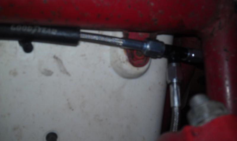

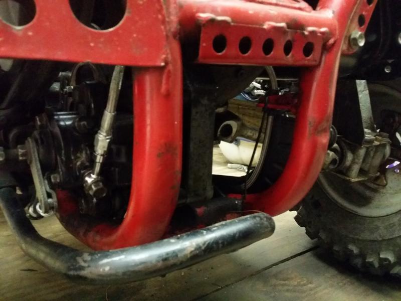

Got the rear steel-braided line on and it totally makes a big difference. Again...I can't say for a fact the lines are magically better, but they bleed easy. Having brakes is nice.
Still have that sticky rear brake hand lever. Not sure if it's the shaft in the steering wheel or the cable. I added a helper sprung to assist the return.

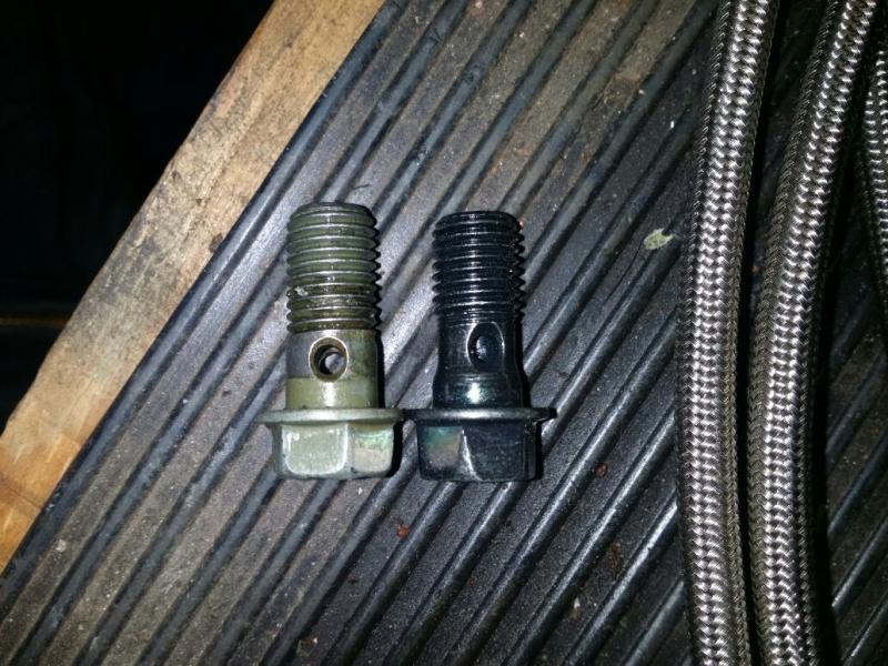

Many thanks to Crackwarrior for some intellectual exchange on the FL350R brake line kit. He noticed the alignment of the banjo bolt flow hole is not as good with the kit's banjos as with the stock banjos. And if you look at the pic, the inner groove of the stock banjo is much bigger than the ones I'm using. He found another Honda banjo that puts everything into perfect alignment (see p/n below).
I've never had any complaints about it, plus mine works fine and moves plenty of fluid. But I will always strive for continuous improvement! :-)
Here is the link to the other banjo bolt. They're currently $4.76 ea: http://www.partzilla.com/parts/detail/honda/HP-90145-MS9-612.html
These are on evilBay right now for $6.99/pair with new washers:
Thanks for your help, Colt (aka: crackerwarrior)!!!

Lol thanks for the credit just seen this.. be careful of the washer thickness as well those thin silver ones you gave me were perfect.
Those brass ones could be to thick and cause the same problem.
