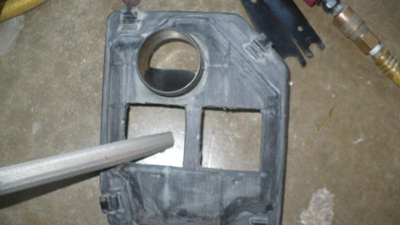

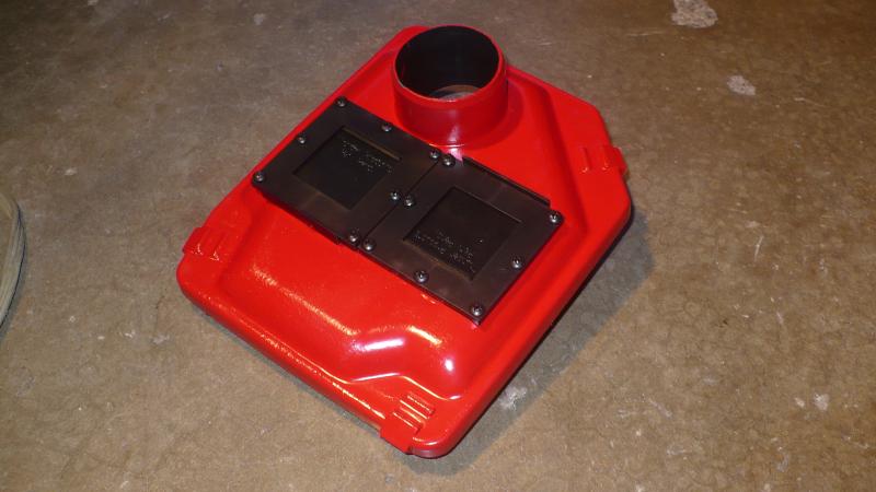

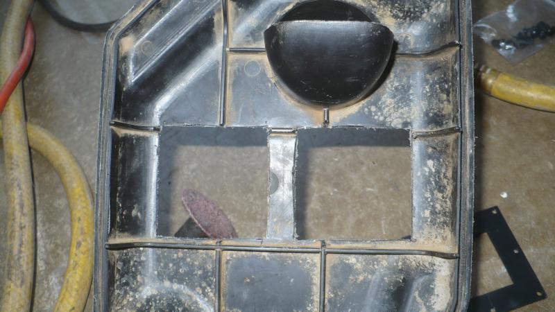

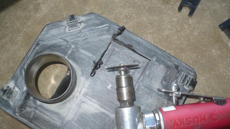

After this Pilot air box lid was generously donated by Mudbogger. I installed 2 Thunder TPI valves. These will allow me to go rich or lean when the ambient air temp changes. The lid was sunbeaten so I hit it with some 100 grit sandpaper, then cleaned with plastic prep, then rattled canned with some close to Honda red paint for plastic. Both valves will open and close in increments and are supposed to stay in that position when riding. Here is a link to some close up pics of the TPI valves.
viewtopic.php?f=4&t=12669

PostPosted: Fri Sep 13, 2013 11:28 pm
Nice work Marc,those look nice,great job
I hope those work out well for you at LS
PostPosted: Sat Sep 14, 2013 12:24 am
Looks good buddy
PostPosted: Sat Sep 14, 2013 1:04 am
Its gets chilly at night and in the mornings then heats up during the day at Little Sahara in spring and fall, so this should make tuning a little easier.

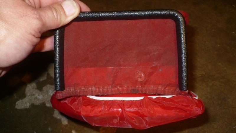

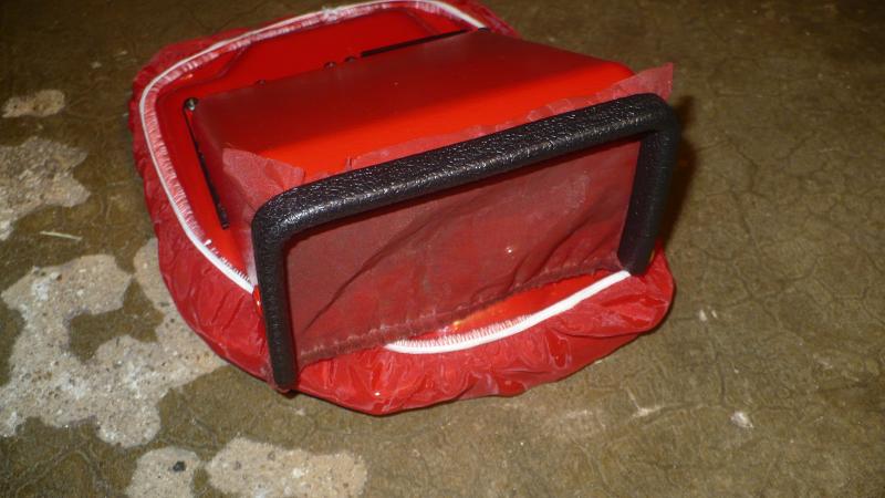

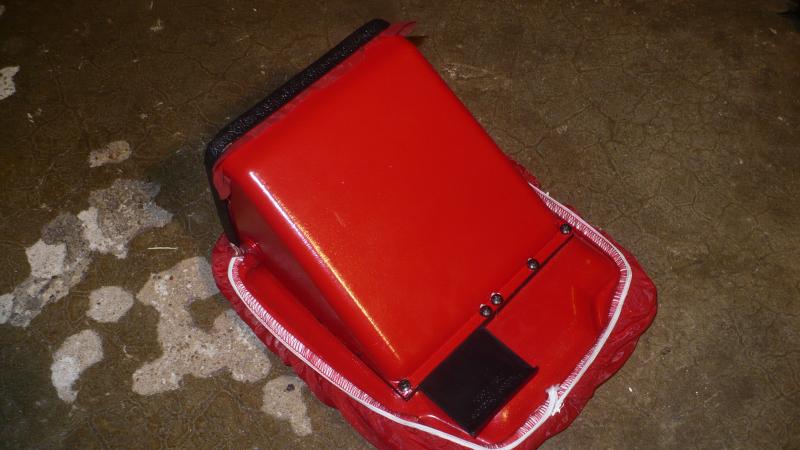

more modifications to my air box lid after some sand was resting on the outerware that is mounted between the lid and box. Im still able to open and close one of the vents without removing the piece of outerware attached to the 45 degree cover piece, i can access the other vent by removing the piece of outerware that I attached with some black trim.

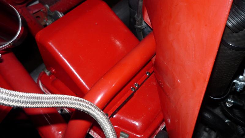

Lid installed
