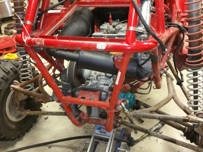

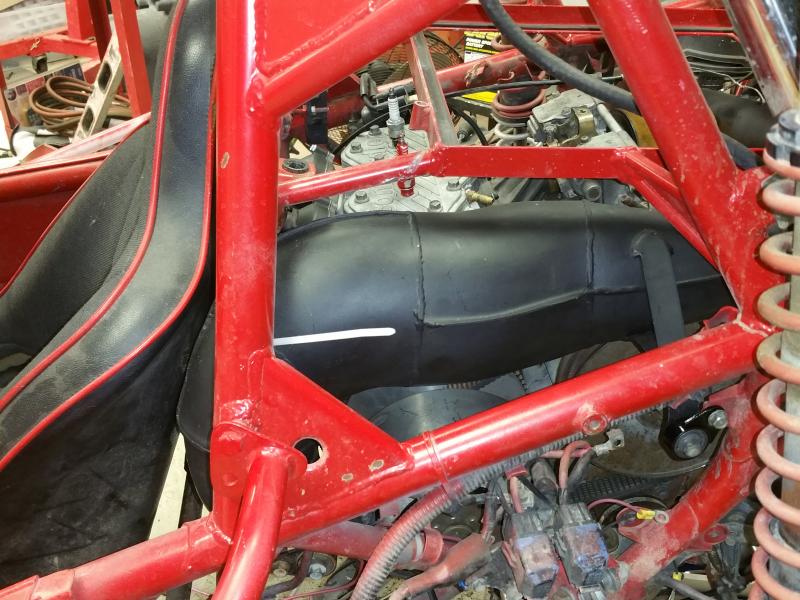

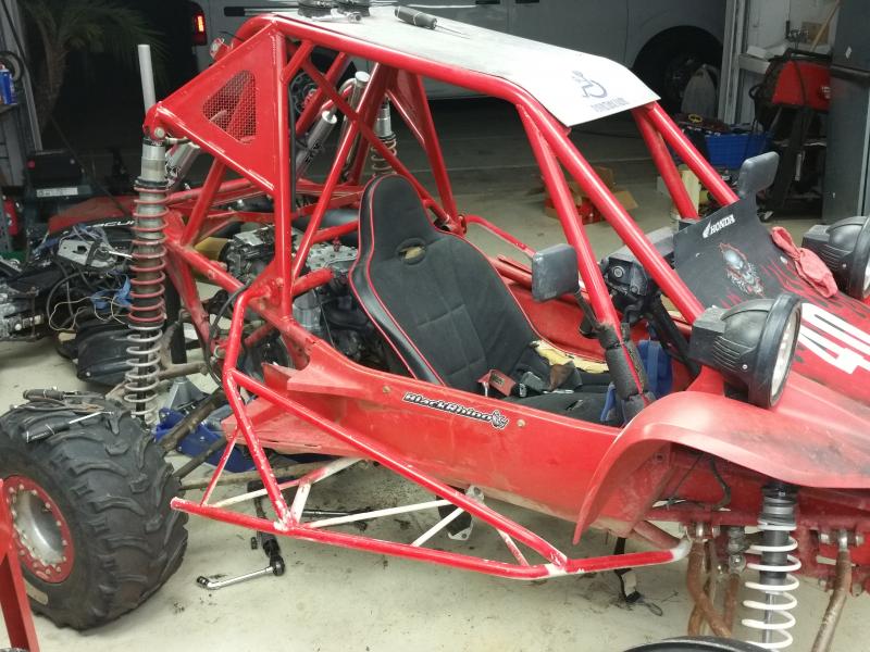

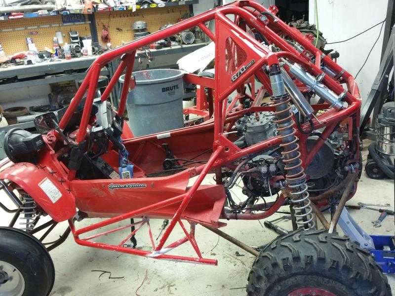

I decided to go with a Engine that I can use the correct carbs with. Farr Off road found a 600 ho Engine 2006 I believe. It has the same hp as the 670. I will need to refab the cross bars some but overall the install has gone great.

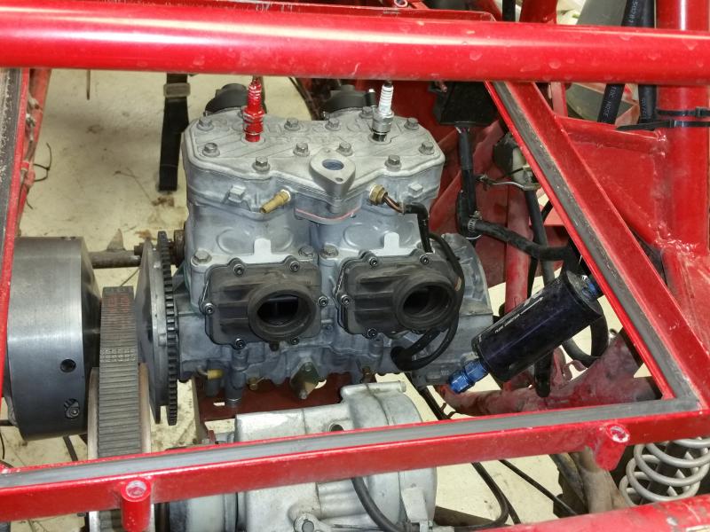

More

60 mxz 600 ho with 800 Reed cage and boots with 600 carbs. I think I have it down to run all the 670 electronics. Way easier. Farr off road is thinking the 670 and 583s are a thing of the past. If I get this running on the 670 stater and mag this is a way better Engine. More hp then the 670 too. I might look at what it will take to get the sdi going. Wiring the 600 with the 670 wiring was a piece of cake.
