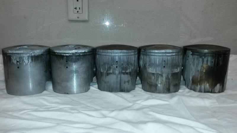

Here is my piston collection so far Baahahahaha.
Finished putting my brothers Engine together last night and will install sometime today.
Still have to do a vacuum and pressure test before I flash it up later this week.
Took the performance cyl off and now have a stock cyl on it that I got from BS.
Hopefully that will stop this piston eating contest and my brothers machine will run.

Well they are looking better down the line at least! lol I have more than that so I feel your pain brother.

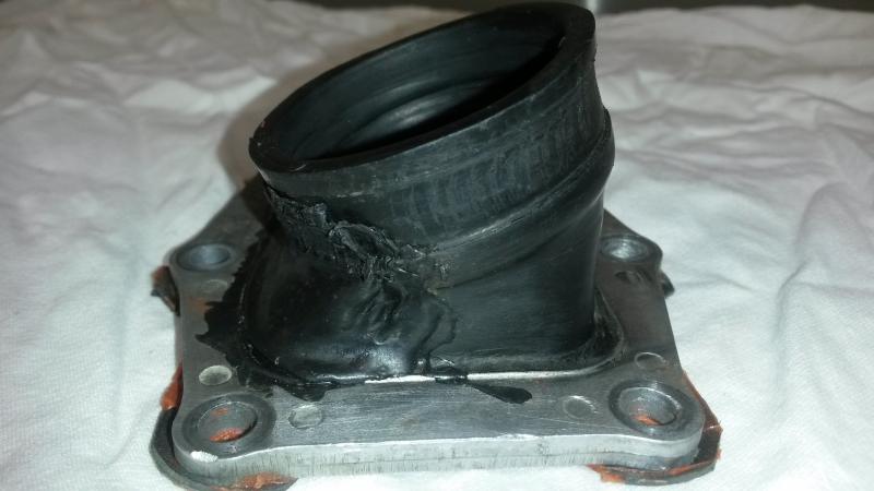

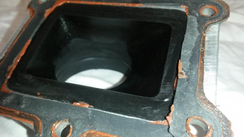

Well well well. Looks like I found the Engine issue and I feel stupid now.
I tried to do a vacuum and pressure test and they both failed bad.
As fast as I could vacuum or add pressure the faster it dropped. I could here hissing.
Managed to trace it down to the intake boot and I can't believe what I saw.
The monkeys die grindered the intake boot so that the 42mm Mikuni would fit. This is the
carb that the oddy came with when I bought it. I guess when they die grindered the boot they
must have poke a hole through and they covered it up with some rubber stuff. It looks like they
used liquid tape. I feel real stupid right now because I noticed these die grinder marks in the
boot during previous rebuilds but just didn't put two n two together. I also didn't notice the liquid
tape they used to fix it but noticed it now because it became unlaminated. Attention to detail I guess
I don't have as I am a heavy industry mechanic and everything is done with a torch and hammer LOL.
Usually I notice stuff. What a moron I am. Oh well I know now. When I read some of Hoser's threads
there are comments like "wrong nut or poor old gasket removal" , I usually grin a bit. Well the joke is
on me and it cost me money. If you look close at the one photo you can see the die grinder marks. The other photo shows the patch stuff they applied. Sorry for poor picture quality. The strange thing is during previous rebuilds it always pasted the tests. I don't put an Engine in unless it holds pressure for at least a half hour or more. My Engine on oddzilla #1 holds for days but this one on oddzilla #2 never held pressure for more than minutes.

P.S. the first two pistons in the picture weren't a result of the intake leak. It was because it had 170psi static and we ran premium gas (91 octane) instead of AVGAS.
 Post subject: Re: My piston collection
PostPosted: Thu Jun 19, 2014 5:07 am
Do you have your corresponding spark plugs to match the "pissed-on" congo line? :-)
Those first two pistons could have parts of melted spark plugs if that counts :-)

Ok enough BS you know you put that can of liquid tape on there just to mess with us.. LOL I have used Bed Liner before on a friends Honda 650 that we restored and he road it for years until a guy at a rally in SC wanted it more than he did and bought it. No joke I was on a ride one time and found a crack in one of the boots on my 750 and used a hot patch to get back home.. Now that was back in the day.. Thanks Billy
PostPosted: Mon Jun 23, 2014 12:17 am
You can't do that and expect it to hold on an FL350. It might work long enough to get you back to camp but it won't last for any longer than that. The carb mount is designed so that it flexes somewhat and any bubble gum and Band Aid fix will only fail and run the risk of burning another Engine down.
Ever watch how much an fl350 Engine moves when it's idling or when torque is put to the clutch?

Yup I agree and that's why I made a new intake.
Its not quite a "Daniflold" but I am gona give it a try. The price was right and so was the experience.
Engine is just completing the pressure and vacuum tests as I write this. Will post a photo of it in the next hour or so.

Got a question, why are you only drilling two holes in the piston at the bridge area? Are those not wiseco pistons? Just wondering. Thought I may have missed something... LOL Thanks Billy
