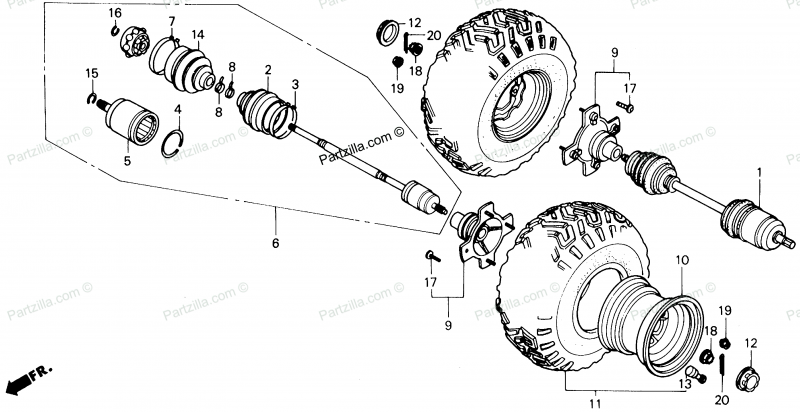

PostPosted: Tue Oct 22, 2013 11:04 am
the clip you need is part number 4 right? I will check to see if the inner joint includes the clip tonight and let you know. I'm almost certain it does not include 15 or 16.
I agree with H - it should be a common part, but do not know for sure.

yes I need one possibly 2 of the #4 rings/clips I'm betting an axle shop may have something as well but if it comes with the guts along with the cage and new balls I'll probably grab 2 while we still can

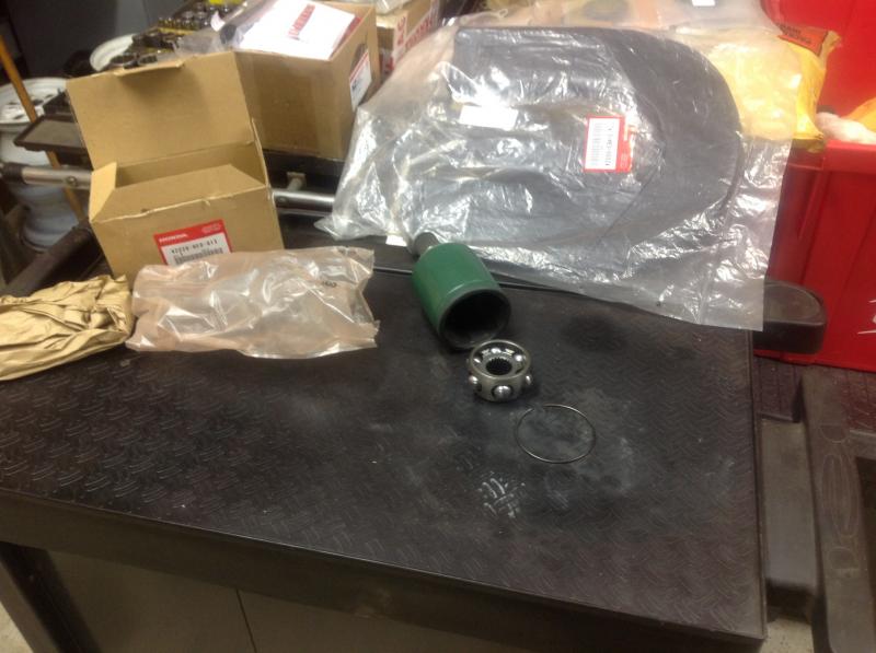

PostPosted: Tue Oct 22, 2013 8:45 pm
Clip does come with inner joint.
Well that's a beautiful thing!! I love the wealth of knowledge on this board.... Thanks again!!
