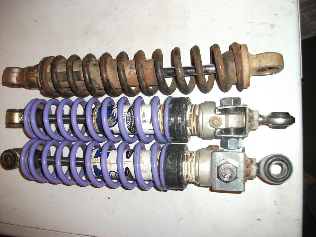

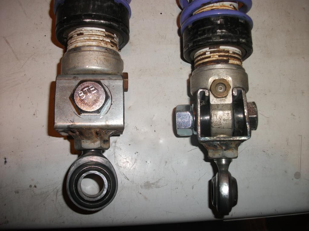

Pics of my modified rear shocks
They are only 1/2" longer than the stock shock, adjustable, and rebuildable

Uni-strut seem to make a good shock adapters how is the spring rate?

Spring rate is a bit light. Came off a snow mobile. But I'm only 160 lbs and I'm sure there are heavier rated springs for Fox shocks available.

PostPosted: Sat Jan 03, 2015 7:30 pm
Quote:
They are only 1/2" longer than the stock shock.
ONLY? :shock: That's enough to bind up your driveshaft uni joints!
Have you jacked up the rear end,rotated your wheels and checked that your uni's are'nt binding on their yokes?
If not,do yaself a favour.
If you jump and the susp goes full droop then ya can kiss goodbye your joints,then maybe your shocks as well.
Because often the escaped driveshaft will flay around and take em out too.
From memory you don't wanna be longer than 390mm eye-eye.

I did try that when I installed them. Not a lot of room, but no binding either. I'm pretty sure this buggy won't be seeing much jumping. Thanks for the tip though
EDIT: Just to check things out I measured the stock shock. It's a tad over 15" long eye to eye. (about 15 1/8")
130mm is about 5 1/8" So your 390mm max is about 15 3/8"
I'm right on the edge or a touch over that.
If that's the case, I can shave 1/8" off the nut and run the heim joint in to shorten the overall length
Thanks again for the tip

Modified a set of Fox shocks for the rear as I'm too cheap to buy the WORKS. PO had steel tubing as solid struts when I bought it. (figured I'd buy new shocks for it..... Remember when i said i didn't research this thing?)
