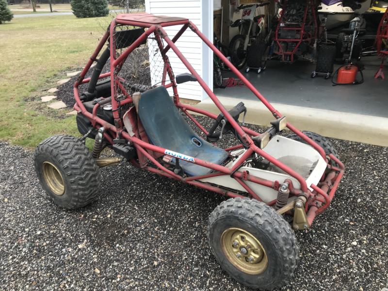

Well I had a oddy come up for sale about 15 miles from me and didn’t have any takers for 3-4 months. I finally got tired of seeing it listed and figured I would go check it out and throw him an offer if in good shape. Guy said it would rev but limited power. Carb was removed, guy thought the top end needed a rebuild but in my opinion the top end looks good - only a physical inspection so far. Neutral safety switch still connected and I’m guessing that’s the real issue. ALOT of dust, but this thing is in really great shape, ridden but not ridden hard. Has all the stock fenders, and in really great shape, I removed and will likely throw them in storage-don’t want to tear them up!
Cage and roof lid look straight so I bet it was never rolled or tipped over.
Front bumper not dented so this thing was not run hard I bet.
Several bits missing but that ok, minor stuff.
Looks like original tires. I wonder if it still has the original piston ??
Obviously kept outside by looking at that seat, probably under a tarp.
My money is on a possible bad belt or probably a seized clutch (Driven or main).
It has been sitting outside so there is a good possibility the shivs are unable to shift because they are rusted.

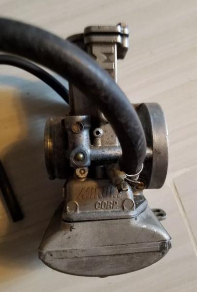

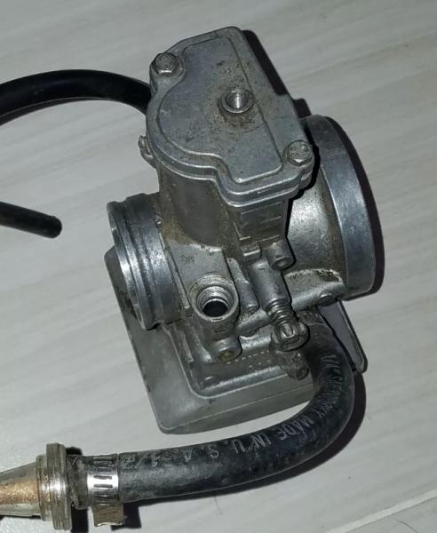

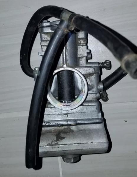

So quick question about this unit. The stock carb is pretty ugly, and I will try and clean up and will try and rebuild but I also thought it might be fun to experiment with some other parts I don’t have experience with. My better half grabbed this flat slide carb for this buggy. Is the only way to identify what model TM carb it is is to measure it? Shouldn’t it have some identifier somewhere? Also any advice when installing this, any other adjustments I will need to make? Any other specific parts I’ll need?

That is definitely a flat slide mikuni carb. An older one at that. You should be able to find other markings on it that will help determine the size. You can always measure it.
Do you know what machine the carb came off of?
Some things to check are what size main and pilot jet are currently installed.
What modifications will be done to the fl350. High flow intake, aftermarket exhaust, reeds, port work....
That will determine what size jets you will want to use and you will want to have a few on hand to tune the carb when installed.
I have a 39mm mikuni flat slide on one of my machines and it works really well. I believe that CO uses mikuni as well.

It will work on all the machines. You will need to change the jets to allow proper fuel/air mix for each machine. The jets add more or less fuel, depending on the machine, you adjust accordingly. YouTube some carb jetting videos to better understand.
You may need a kit to get your choke & throttle cable to work with this carb as the stock carb is a keihin.

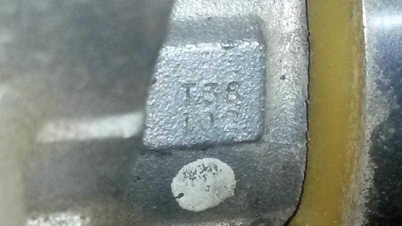

That appears to be a very early TM oval slide carb. It also has a very funky float bowl.
I don't think you can get certain parts for that carb anymore but I may be wrong.
Even jetsrus.com don't have any info on that thing.
The closest jetsrus has is this: https://jetsrus.com/carburetor/carb_mik ... parts.html
However the float bowl is flat on this one and not oval shaped like yours.
But the slide is oval probably just like yours is gona be.
On my new style TM flat slides there is a stamp on it that tells you which TM38 style you got. This is very important because there a several styles of TM38's and there is a 100 point difference in the main jets so you have to know which one you got or you will blow up your machine. I don't see any stamp on that carb you are showing there but if you clean it good you may see one. It appears to be vintage.
Below is a photo of the stamp on one of my carbs.

that's what I was looking for, some markings. I will clean it up, and see if it’s stamped somewhere on it. Thanks! I looked at your intake, looks like from a previous thread you custom made that, is that right?
I think what I thought would be a simple project might be over my pay grade!!! I agree it looks like that carb is vintage-I can’t find anything on it either. Bowl is a very strange shape.

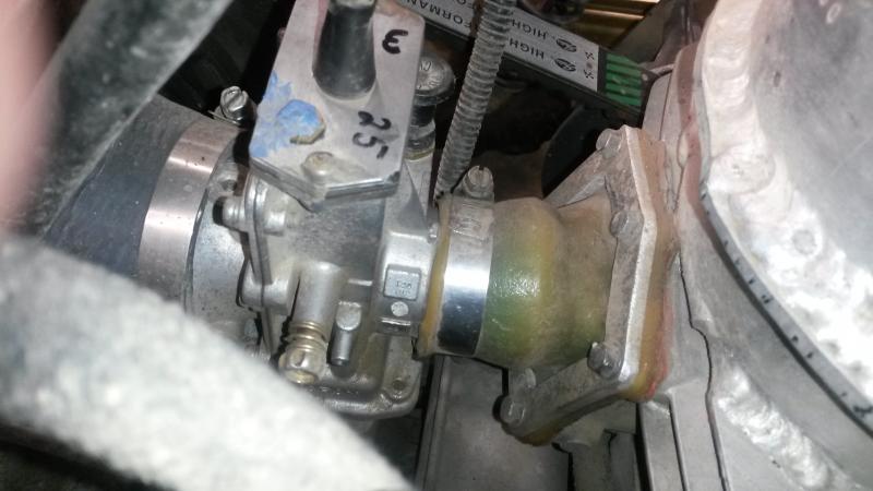

PostPosted: Wed Dec 26, 2018 2:46 pm
MGurgone40 wrote:
I looked at your intake, looks like from a previous thread you custom made that, is that right?Thanks guys!!!
Homemade intake --- that's right.
Made from vitaflex60 two part rubber. Same stuff they use in the movie industry.
