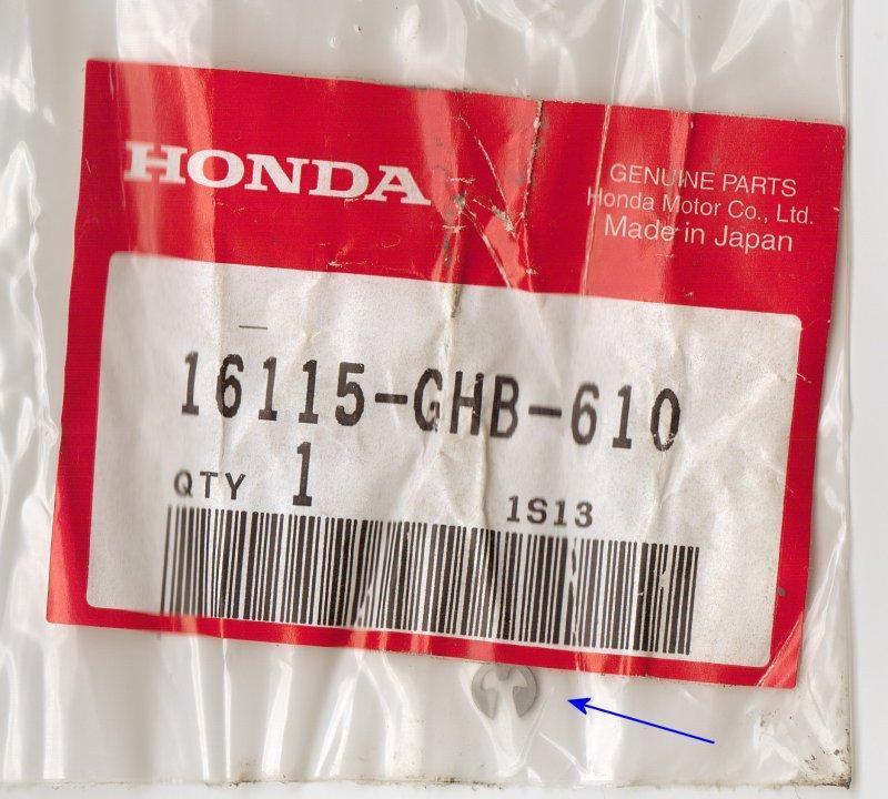

Ever loose one of these?
Get a spare today.... Service Honda says they are only 1.44 each
16115-GHB-610
http://www.servicehonda.com/parts.php

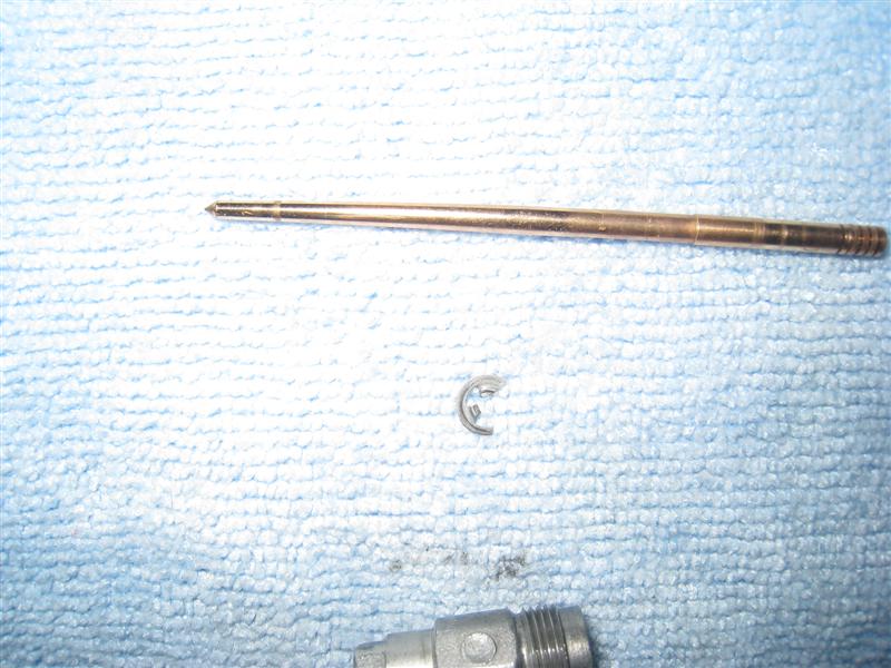

I needed a spare. That clip was the culprit for my DNF at the mountain Ridge GNCC. I was minding my own business halfway through 3rd lap when all of a sudden Im getting no throttle response. I thought I had lost the motor (( Internal Combustion Engine ? )) but was puzzled because there was no warning, and it would idle fine. My next thought was fuel filter or pump. I wasn't able to disassemble at the track due to the excessive mud so I waited till I got home for a good douche prior to dis assembly. I started with fuel filter and pump output test, both where OK. I next unscrewed the cap of carb and immediately noticed a problem when the needle was not present in the slide assembly. After removing the cap cover on slide I found 3/4 of the E clip laying in the slide. Problem solved, the E clip broke and allowed needle to stay in Jet instead of rising with slide causing motor (( Internal Combustion Engine ? )) to die because of lack of fuel. Replaced clip, reassemble and I am good to go rule at Ohio this fall...
PostPosted: Tue May 19, 2009 8:43 pm
Is that needle bent Mike?

Location: Upstate, NY
Needle is not bent and i have not located the missing piece. It is possible it came out when i unscrewed cap nut of slide but i cant verify that. Studying the slide i don't really see any place it could have gone unless it broke into small enough pieces to fall through needle hole in slide.
