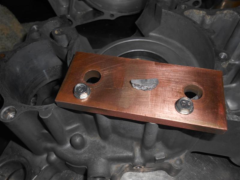

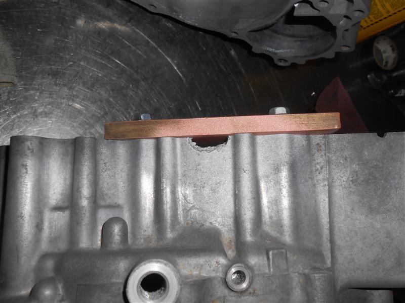

Copper bars were bolted to the cases to back up the edge where its welded.

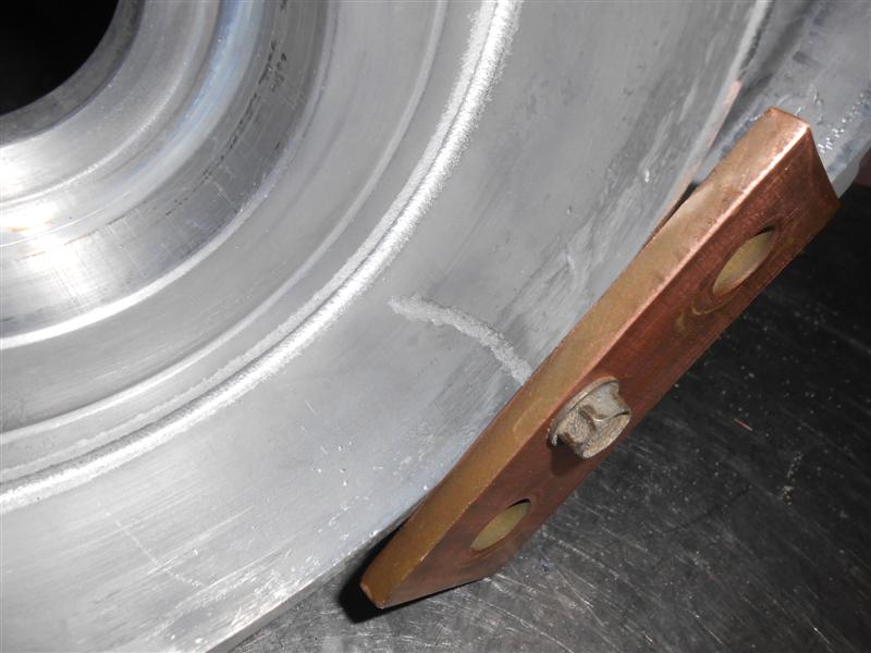

Small groove was ground into the case so you can follow the crack when welding.
Crack welded up
Hole welded up
outside

PostPosted: Fri Feb 22, 2013 11:18 am
Damn nice weld job there, sir! :-)
PostPosted: Fri Feb 22, 2013 5:40 pm
I don't think its welded in that pic? Just the piece sitting in place before welding.
Nice work Mr.H
PostPosted: Fri Feb 22, 2013 11:44 pm
Nice work Mr.H
dosent look like it

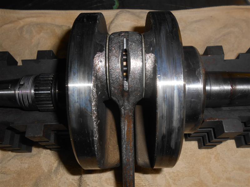

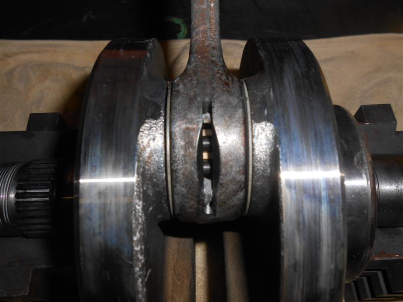

More pictures, the old crank see the parts of the old piston in the oil groove of the big end bearing, the crank is still good but needs a rod kit installed, might be able to reuse the old rod just take apart, use new pin and bearing remove piston parts?

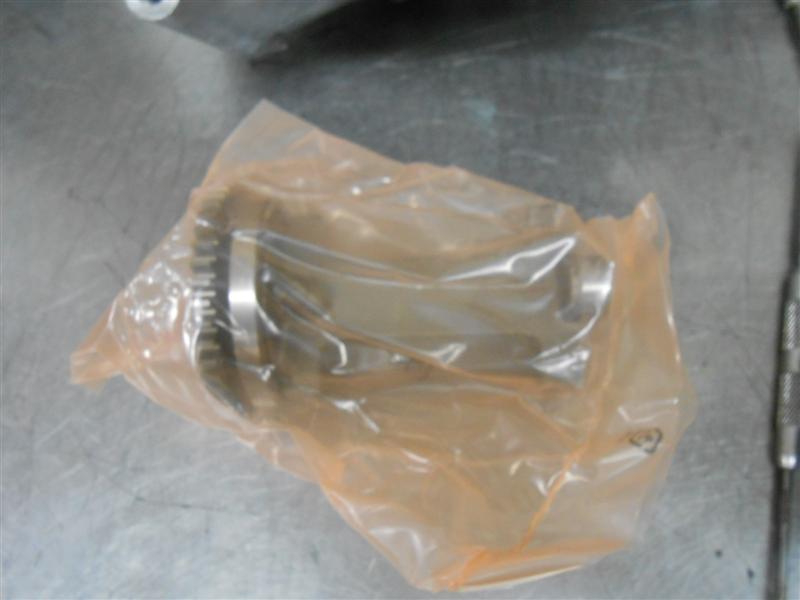

PostPosted: Mon Mar 18, 2013 12:37 pm

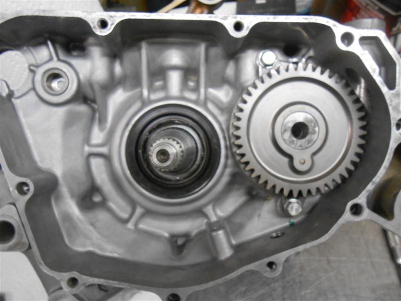

New balancer was installed.
PostPosted: Mon Mar 18, 2013 12:56 pm
Perhaps I just missed it, and as much as I love new parts, Why did you have to install a new balancer? What was wrong with the old one?
PostPosted: Mon Mar 18, 2013 1:13 pm
Old balancer was still good Steve wanted a new one installed, old one will be kept for future spare.
