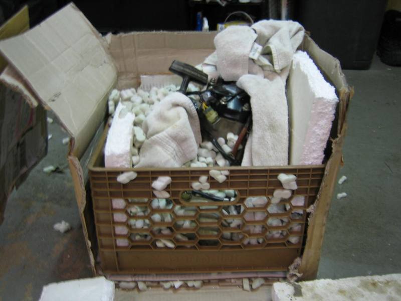

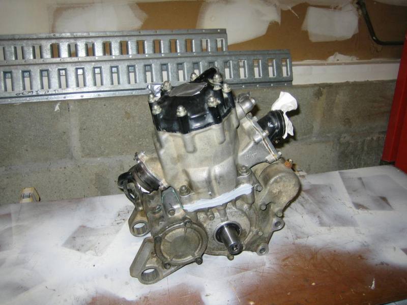

Here are some pics of the package.
I will update tomorrow once I reassemble and get her running.

File comment: Hoser enhanced motor (( Internal Combustion Engine ? )) fresh out the crate

File comment: shipped in the milk crate I sent the Engine in.

File comment: all nestle tightly popcorn and styro

File comment: see thick styro on top for protection

PostPosted: Fri Dec 01, 2006 11:35 pm
The box looks about like it did when it left here glad it made it and they didnt knock the side out, like the note I put on top :-)
When installing the metal plates that go between the rear of the Engine and trans make sure they are seated perfectly in the dowl pins before you tighten the bolts so you don't crush them, they can be a pain to seat, sometimes you get lucky and they just fall into place, I set the Engine in the Pilot then install the front bolts, leave them loose so you have some wiggle room and play to make the rear connection...

It was my lucky day......all seated perfect.
Last night motor (( Internal Combustion Engine ? )) was put in. All hoses and electrical are together. Need to put on the driven, the clutch, the seat and the pipe this morning. All goes well - turn key before noon.
