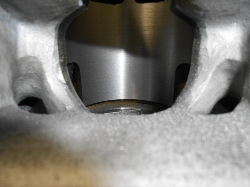

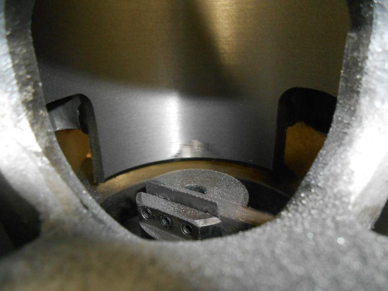

2nd cut at the very bottom of the exhaust side of the cylinder one small area here that I am not sure what caused it to be like this its not from piston wear perhaps happen during another poofkaboom in the past, part of a piston hit here or the rod made contact?????
Cleaned up fine in the end :-)

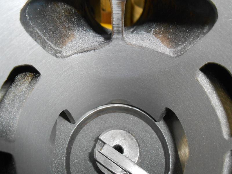

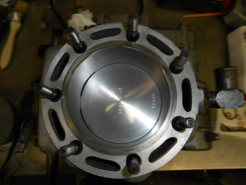

After the bore cylinder was honed, deck lapped to ensure it was flat, studs reinstalled, then assembled.

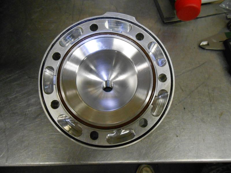

The new cool head came with two domes I installed the larger 66cc dome, grease was used on the orings per instructions

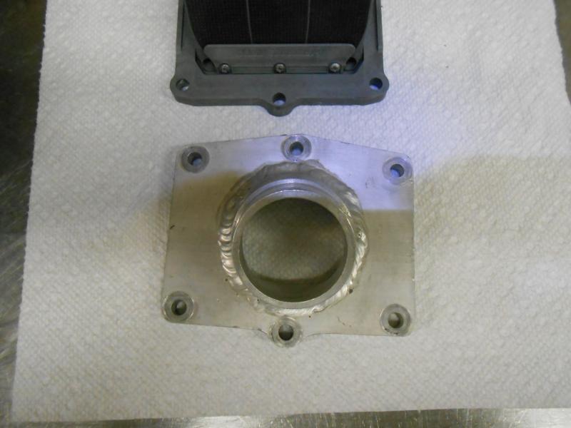

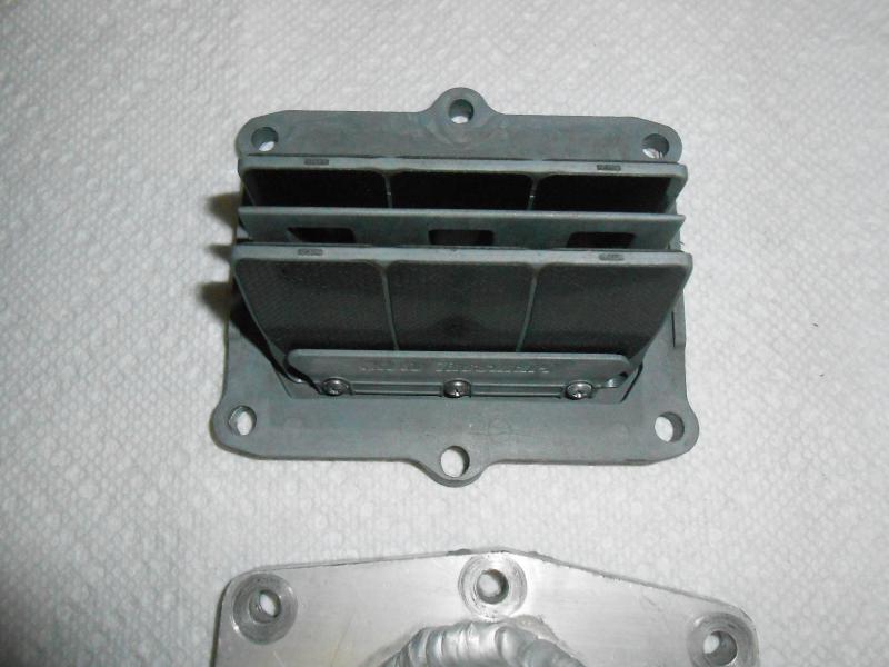

The typical ATVR home made intake is used, the reeds on the Vforce looked really good shape.

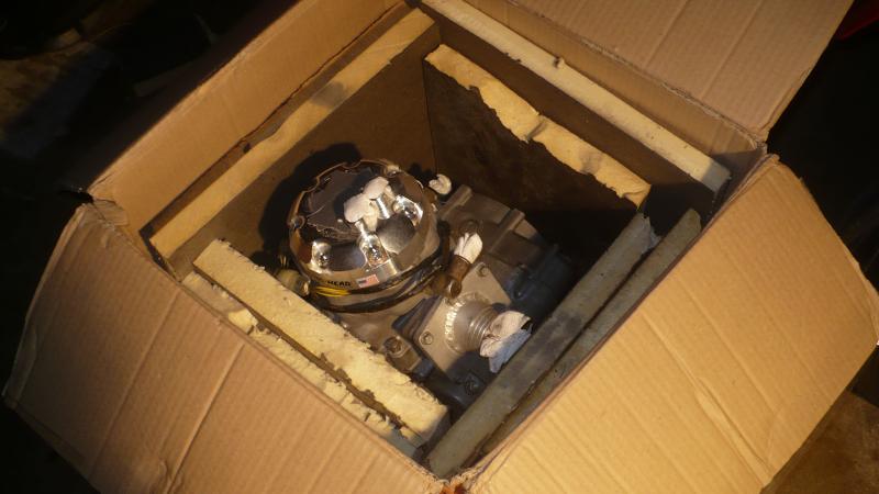

Ill have to see what hoses I need, I have a precooler radiator so one hose will not be needed. Engine arrived safe and sound, ill keep the packing for future shiping needs.

Glad it arrived ok I am always worried about shipping, I think the key is to use a box they just can pick up and throw around easily seems the most beat up p[packages I get are those easy to pick up like plastic tubs with handles.
No oil in the balancer case make sure to fill it up then on your first cool down from the heat cycle check the level again, takes a while for the oil to circulate around the cases and get behind the balancer gear. :-)

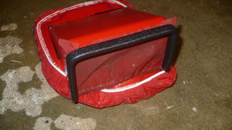

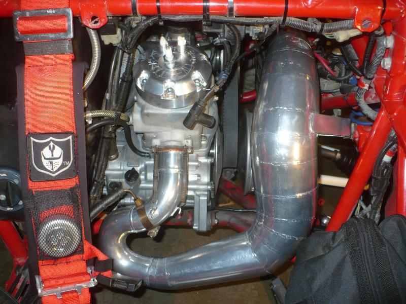

Heres my air intake set up. I havnt used it yet but at least I can close one or two of the valves if its a little chilly during jetting.
I bumped my main jet up from 178 to 182 for initial tuning, my needle is an EEG, I had so much trouble jetting on the last Engine I had to change the needle to get a richer mixture. So ill leave that needle in for now. Manual says use a BR8EG(NGK), for some reasone I was using a colder 9 plug on my last Engine?? Should I go back to an 8 on this one? The 8 should just get hotter to burn fuel off to keep from fouling right?

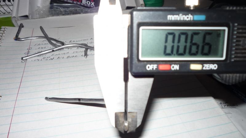

Update, had some time between ordering parts thought I would measure the squish. I measured from side to side instead of exhaust port and intake port, For kicks I might go measure the intake and exhaust side. Anyhow I measured .065 on one side and .063 on the other side. I measured twice and got the same results. I read up a little at the CR500 forums on squish clearances to see what those yahoos were running. .040 and .050 seemed to be the norm. Im wondering once I get the Engine "broke in" if that will change since the piston will swell some.
