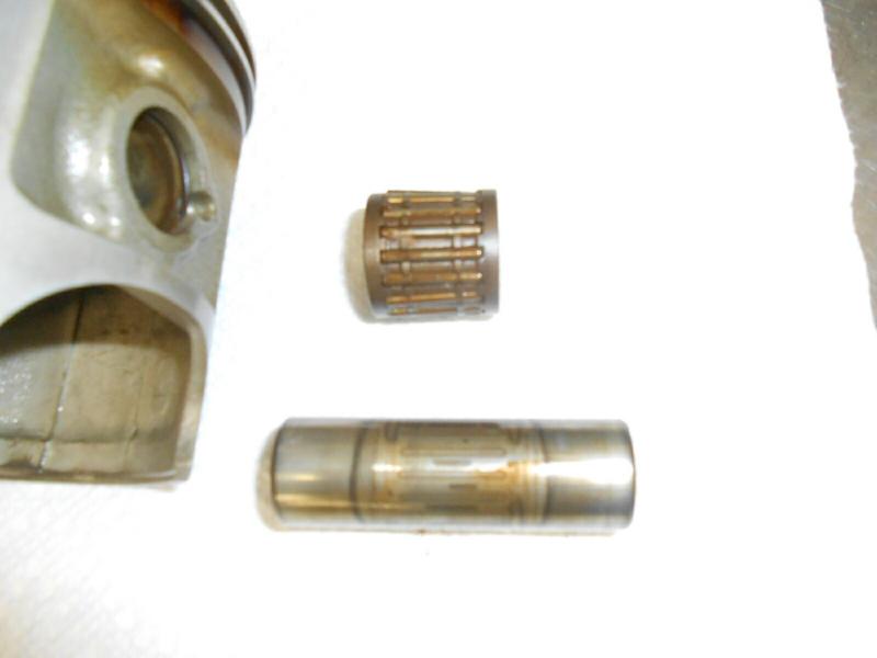

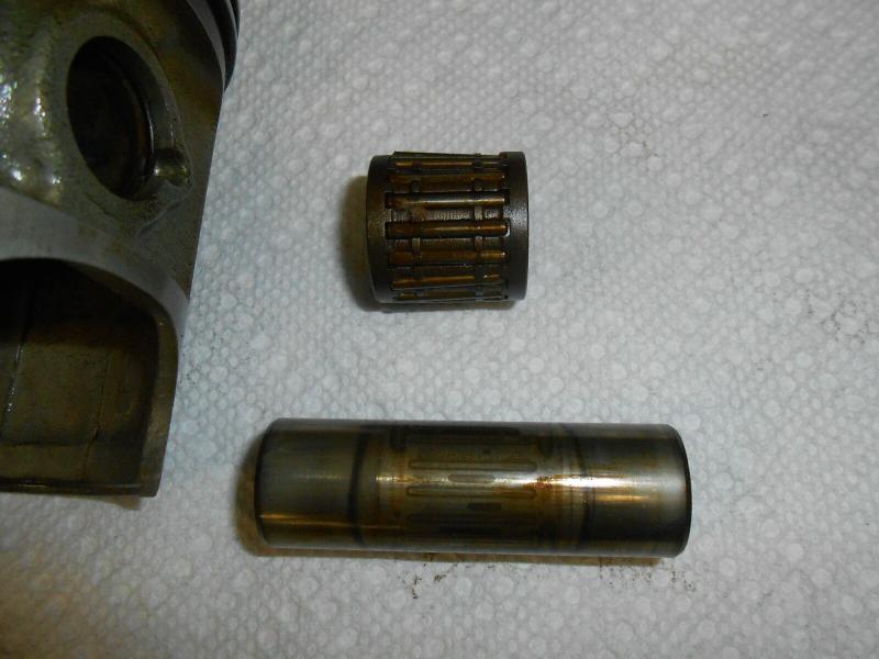

First thing I noticed when I took the top end apart was the rust on the top end bearing.

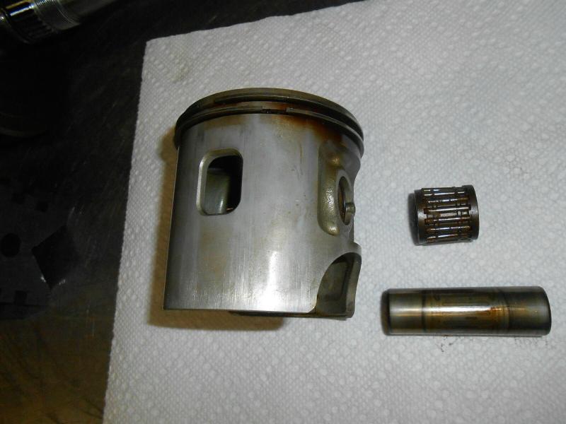

PostPosted: Thu Aug 15, 2013 5:36 pm
Piston has enough wear it needs replaced.

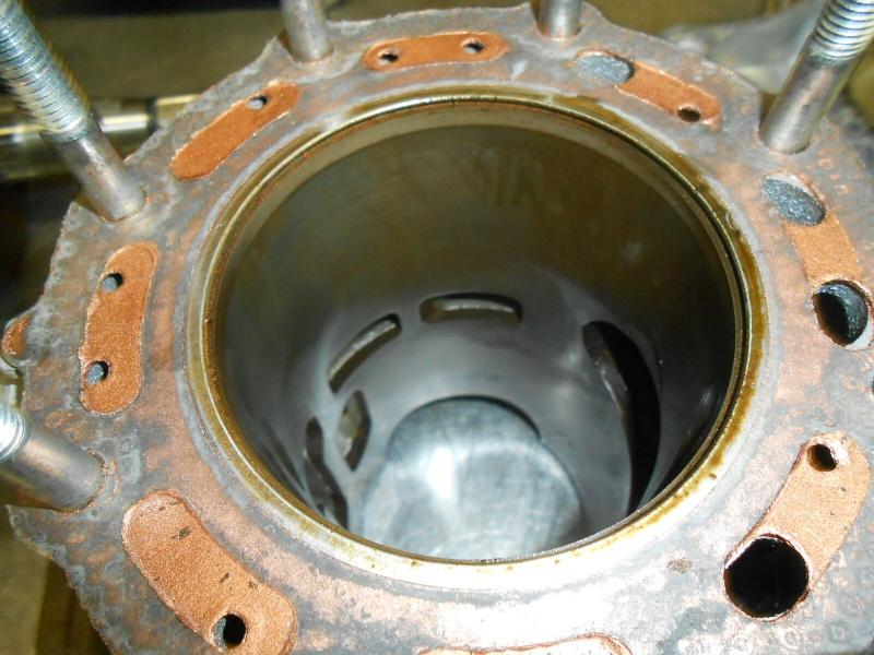

PostPosted: Thu Aug 15, 2013 5:38 pm

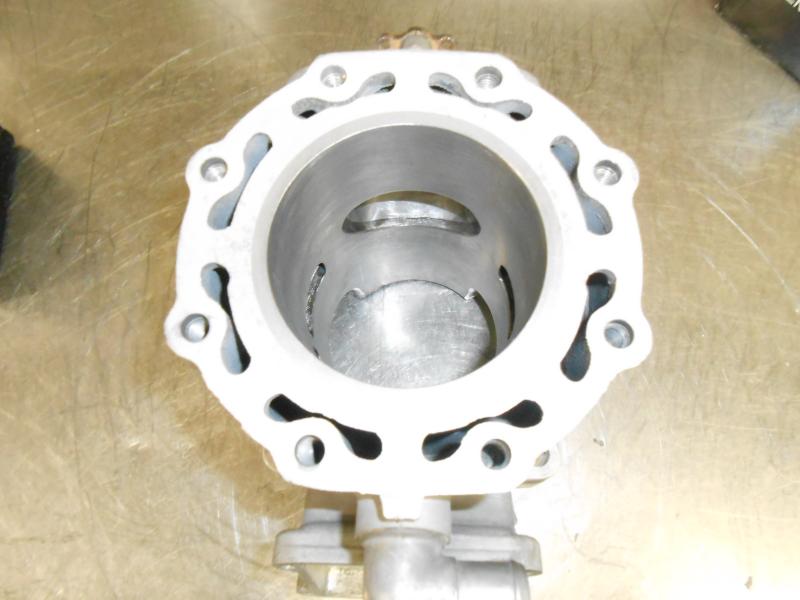

Still need to clean and hone the cylinder so can measure the bore condition.

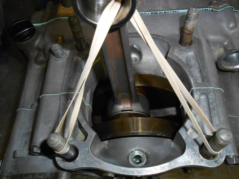

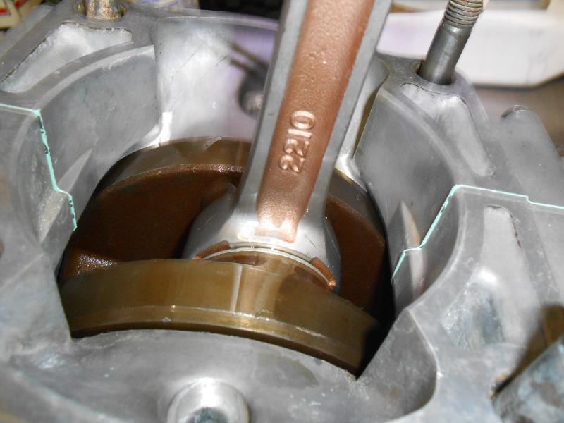

You can see the rust stains on the rod.

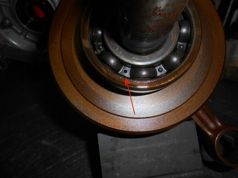

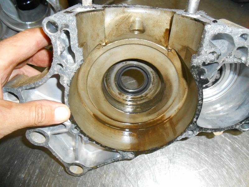

PostPosted: Thu Aug 15, 2013 5:43 pm

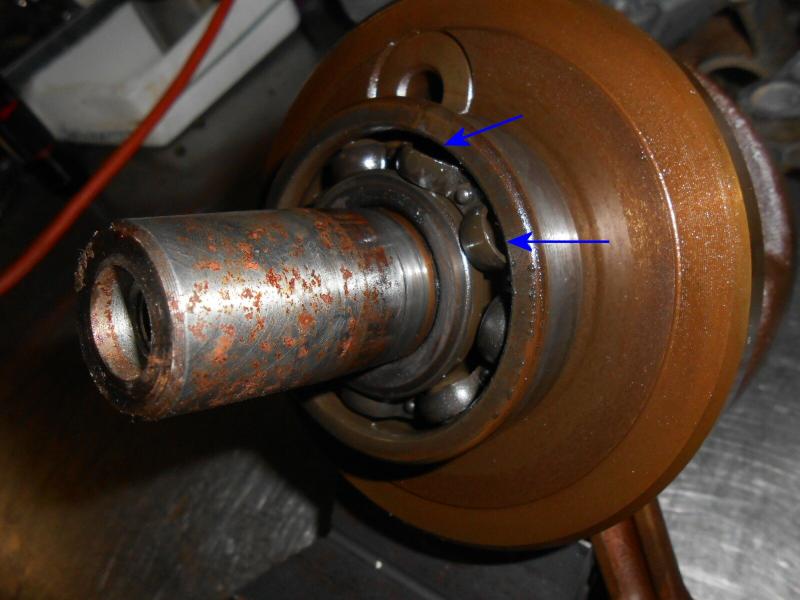

Clutch side crank bearing ball separator is coming apart one of the rivet heads is missing and probably what caused the damage to the head you noted.

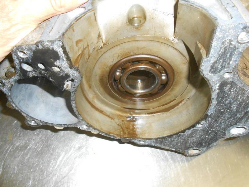

PostPosted: Thu Aug 15, 2013 5:50 pm
Plenty of dirt and shit inside the Engine.
Still a lot to do but the Engine needs a major over haul, I suggest having the crankshaft rebuilt their is plenty of play in it looking at the rust on the small end of the rod and on the crank itself I bet the lower bearing is rusted also.
Naturally both crank bearings will need replaced.
Full Engine gasket set
All 3 lower end seals (2 crank seals 1 side case seal) needs replaced.
Will also need a piston kit for the top end, will measure the cylinder tomorrow to see if it needs bored or not.
All the parts will be cleaned and closely inspected, lapped to ensure they are flat.
More tomorrow.

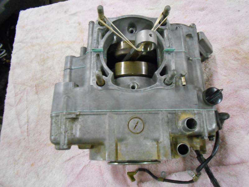

PostPosted: Mon Oct 07, 2013 6:48 pm

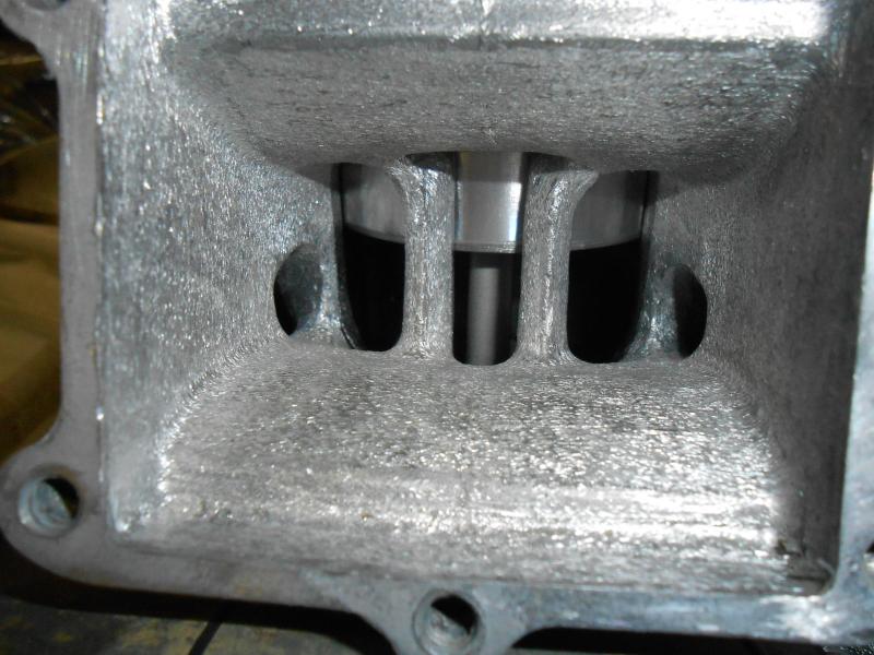

Quick update, your bottom end is assembled.
Got the crank back from Speedchaser he did a wonderful job rebuilding as usual, I performed all the normal case mods for better oiling that I perform on all my builds as well as remove casting flaws that impede flow, New crank bearings and seals installed.
Moving to the top end tomorrow.

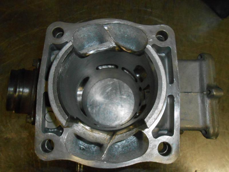

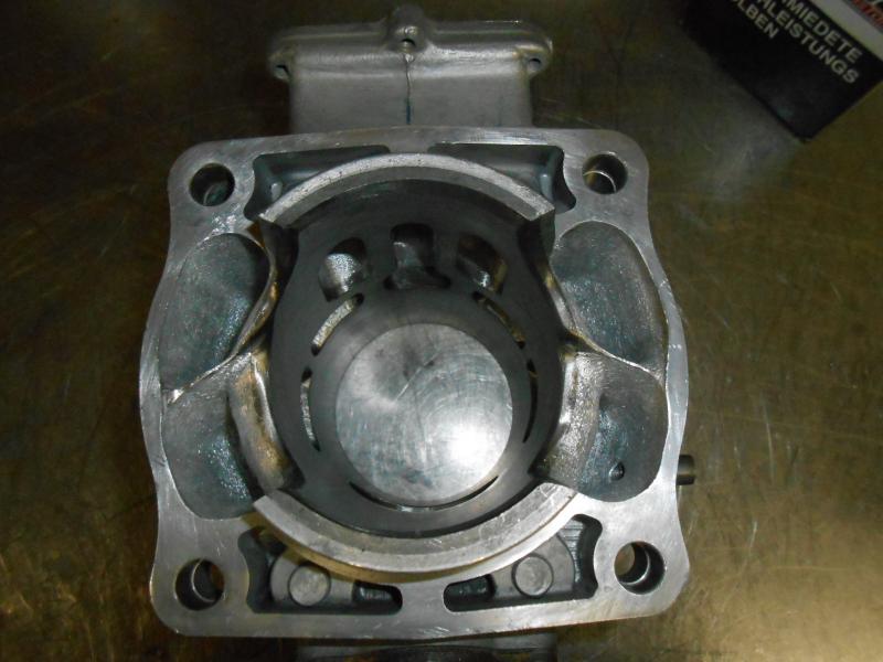

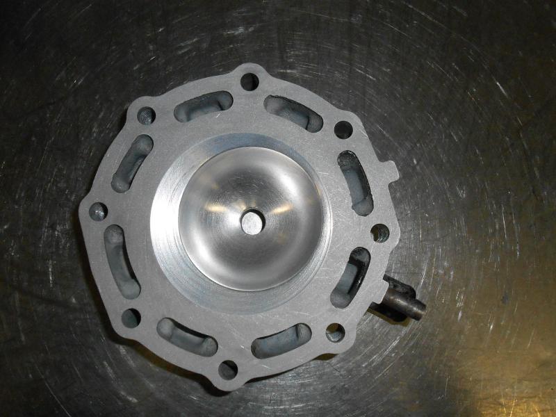

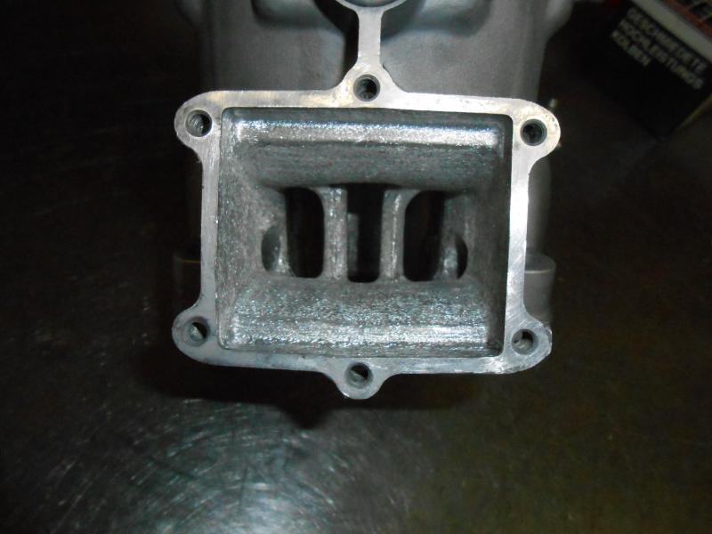

PostPosted: Wed Nov 06, 2013 1:20 pm
Update

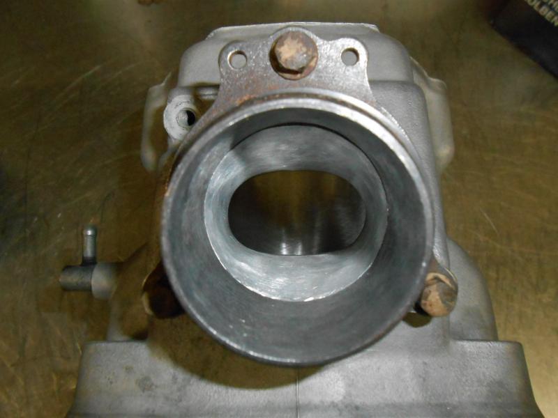

Your Engine is done, cylinder and head hoserized ready for action :-)

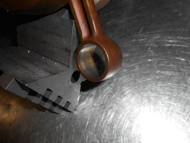

PostPosted: Wed Nov 06, 2013 1:25 pm
Close up pics of the installed HOT ROD installed by Speedchaser .
Looks like they take the standard rod then sand down the surfaces of the rod smooth have read this in tech articles on Engine building the theory is the forging process creates stress risers and micro cracks at the surface that after thousands or even millions of cycles (rod going up and down) they can turn into big cracks and the rod can break, when was the last time you seen a rod break in one of these engines?
A good practice in a expensive full race Engine that has tripled the HP and increased the RPMs quite a bit.
If I seen rods in this application breaking you can bet I would be doing the same plus having the rods crack tested.

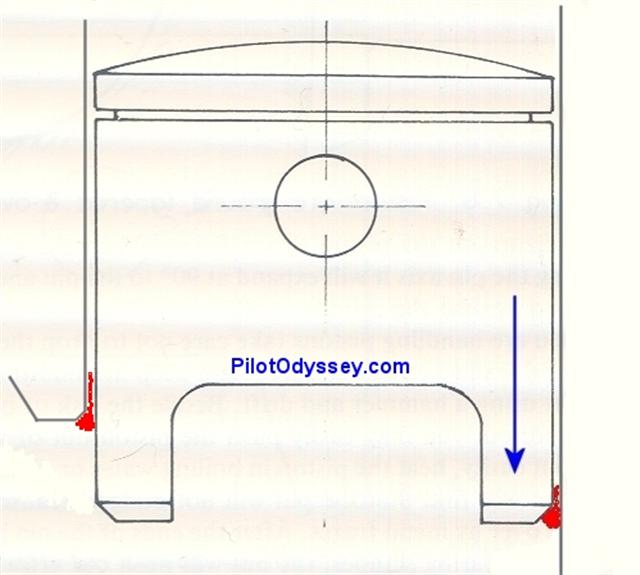

Bevel at the bottom of the piston prep (hoserized) rather than the sharp factory edge that acts more like a oil scraper.
Piston prep
With the bevel at the bottom blue arrow as the piston travels down any oil on the cylinder wall is scooped up where the bevel meets the cylinder wall creating a small reservoir of oil that is then deposited between the piston and cylinder wall not just scraped off :-) More info http://www.pilotodyssey.com/PO/viewtopic.php?f=1&t=3399

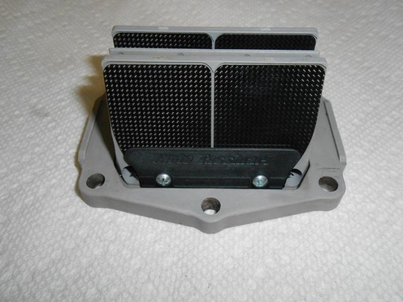

PostPosted: Wed Nov 06, 2013 1:37 pm

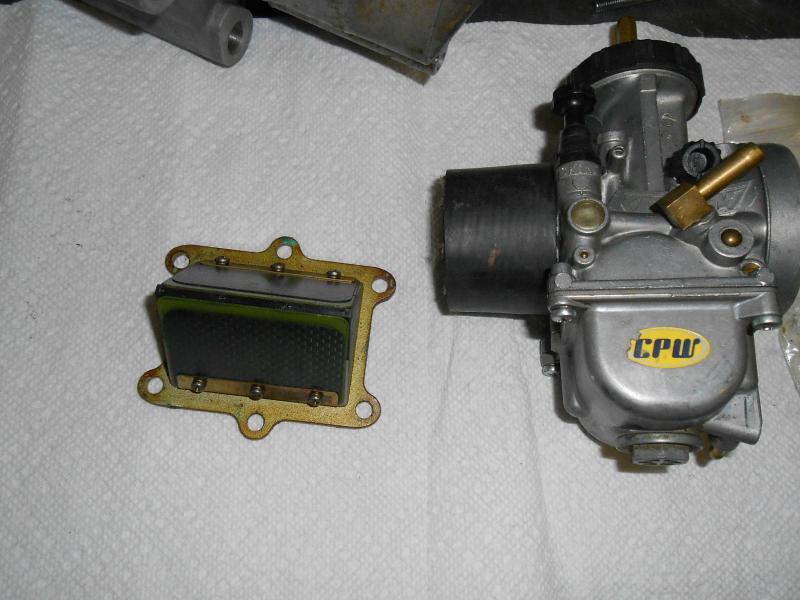

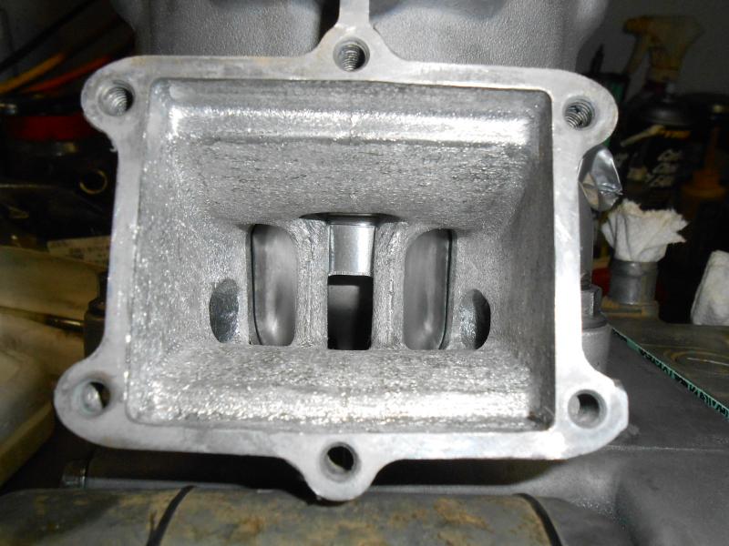

You sent another intake, manifold and reed cage and a 30mm carb.
Reeds on the Vforce look really good.

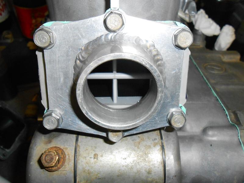

PostPosted: Wed Nov 06, 2013 1:38 pm
Intake manifold looks home made seems ok will make installing the 39mm carb easier :shock:

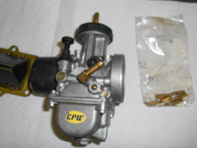

PostPosted: Wed Nov 06, 2013 1:40 pm
Carb came with a bunch of jets has a CPW sticker on the float bowl assume its from Carb Parts Warehouse ?
PostPosted: Wed Nov 06, 2013 1:54 pm
Here is what it came with I installed the 170 main and the 55 Pilot jet, it has CEJ needle I always ran a EEG in my hoserized Pilot engines not sure if the CEJ is leaner or fatter than the EEG ?
The slide was stamped 55 I found this strange usually they are just a single number like 5 or 6 wonder if it was accidentally double stamped at the factory? Or is this something new?
Something your going to have to investigate is the float in this carb I don't recall them being black plastic for the 39mm PWK's after I cleaned installed the jets assembled the carb I always blow in the fuel inlet tub then turn the carb over and see if the float needed seals, it appears the float is not moving in the carb fact is you can turn the carb over and cant feel it move you can shake the carb and it don't move ITS STUCK.
Remove the float bowl and the float moves and functions perfectly it appears that the brass vent tube that is in the float bowl is hitting on the arm of the float preventing it from moving AGAIN I don't recall the 39mm PWK having a black all plastic float I think someone has replaced the factory float with this one the floats I remember have a stainless arms with black plastic floats attached, their appears to be a clearance problem with this float in this carb I would call http://www.carbparts.com see what they know.
All I know is if installed as is its not going to work...
Some of my Pilot jetting info use only as a guideline yours will be different, http://www.pilotodyssey.com/currentjetting.htm
Some details on installing a 39mm on a Pilot a must read http://www.pilotodyssey.com/39mm.htm

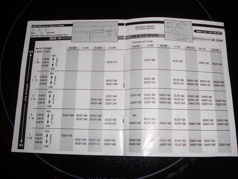

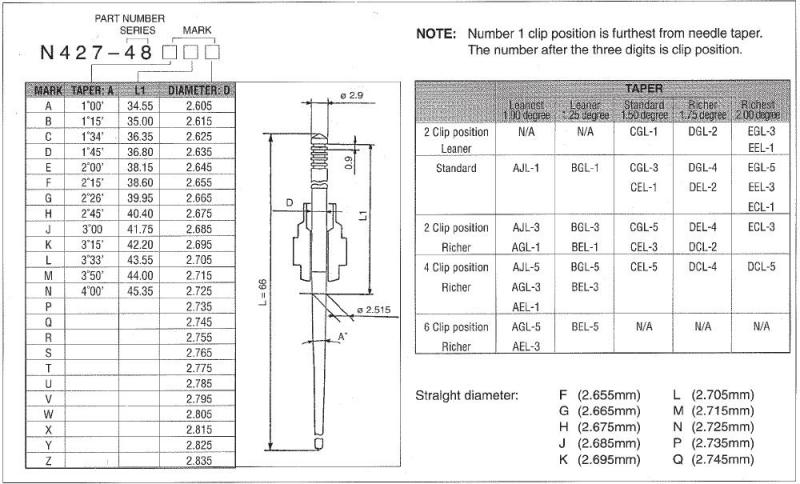

("H" from upper post) "Here is what it came with I installed the 170 main and the 55 Pilot jet, it has CEJ needle I always ran a EEG in my hoserized Pilot engines not sure if the CEJ is leaner or fatter than the EEG ?"
Sounds like the needle is a high intake velocity needle. Heres a pic of the chart if it helps.
