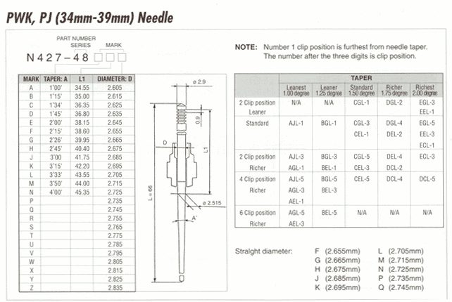

My Pilot  39mm PWK UP DATE 6-09-02
Changed the pilot jet from 58 to a 48
air screw 2 turns out
160 main jet
DGH  needle clip one notch up from center position
Number on the side of my carb 72RA4 NCQ
Notes: bottom end always has been real fat just trying to clean it up some, 48
made a good improvement, think I will stick with it, I also swapped needles with
the wifes Pilot (get the number of needle and put here) the needle in hers is much
leaner, works great in my machine!
Wifes Pilot 39 mm PWK 2-15-04
Slide is a #6
Needle is DGG on bottom notch
Rest is unkown at this point
New needle added to collection is a DGG 7-16-03
Wiggens  current base line jetting 18 Apr 2005
39mm PWK
slide #6
needle DGH set at the second notch from bottom
main came with a 160 installed a 165
pilot jet #60
Air Screw 1-1/2 turns out
