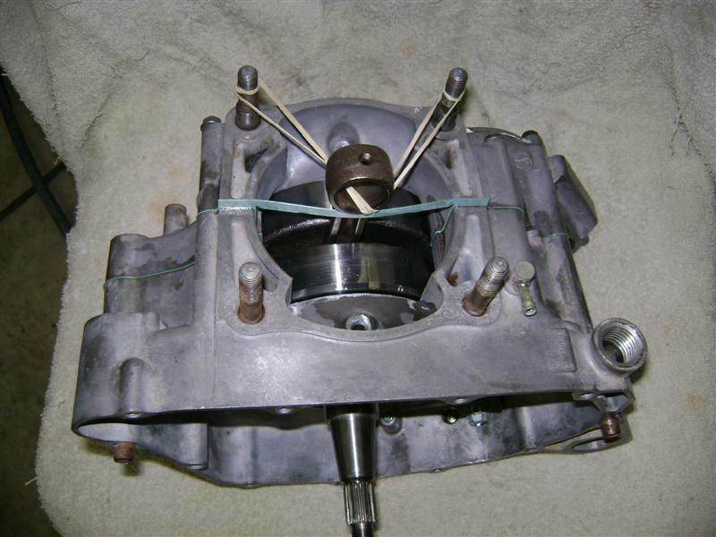

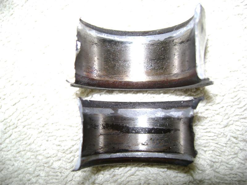

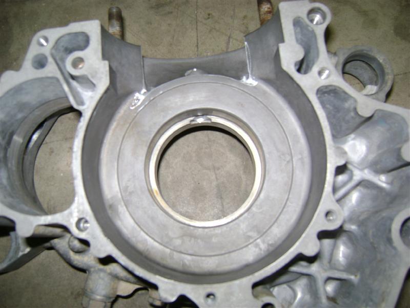

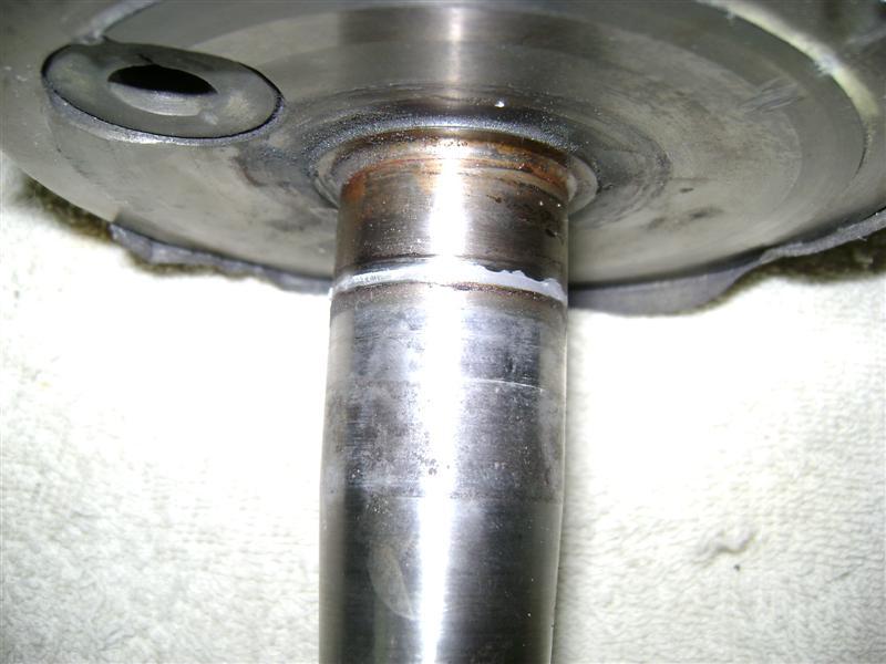

Started on hares spare basket case Pilot Engine, it came in a bazillion pieces.

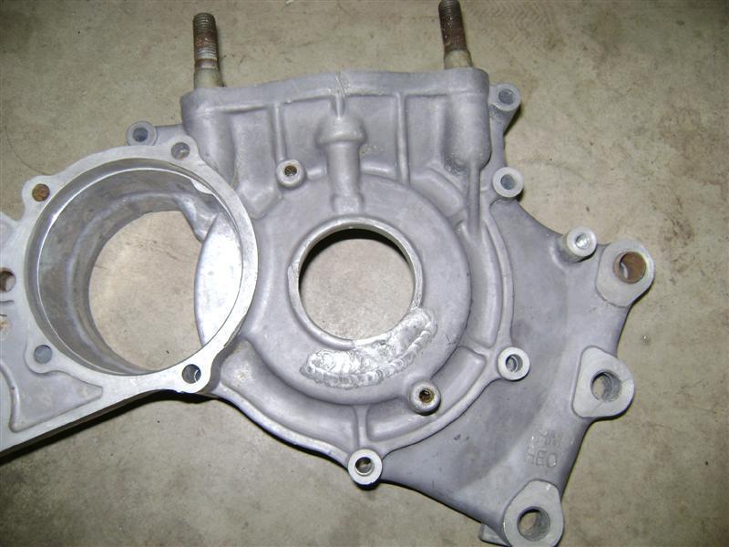

The case have had a weld repair on the clutch side by the crank, nice looking repair job.

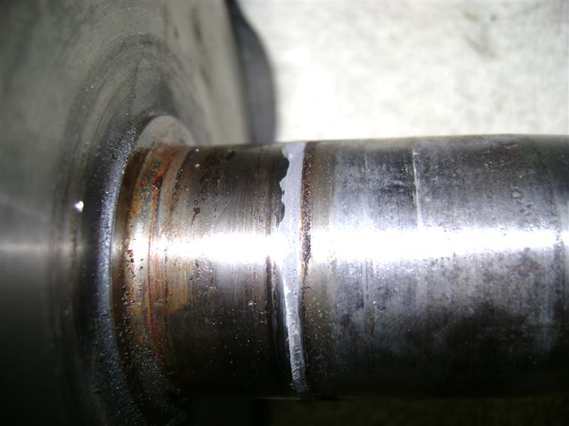

The crank is nice and tight but it came with a bearing fused to the clutch side I had to grind it off to remove.

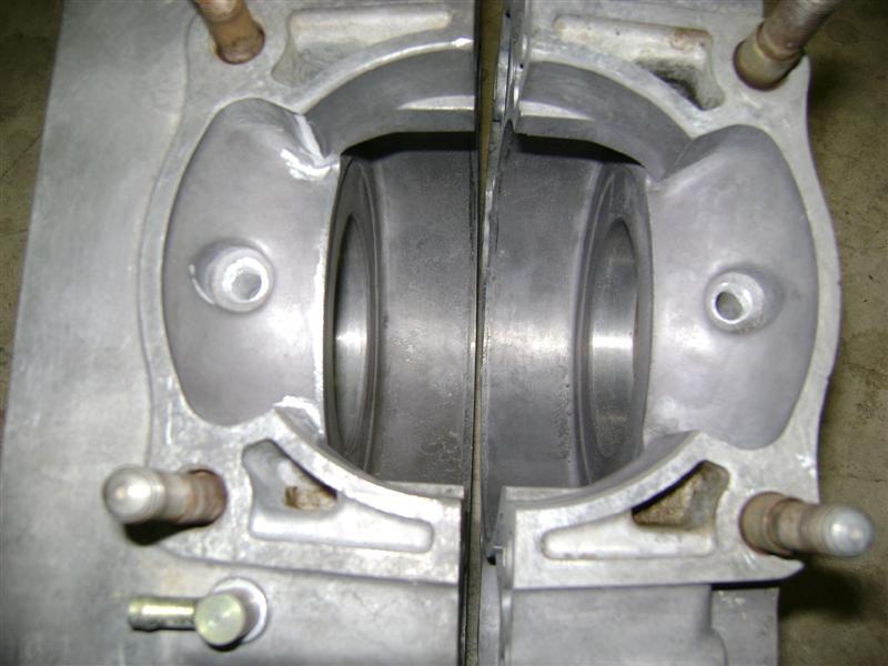

Looks like this Engine had seen a rod failure in the past you can see where the rod hit the cases, I hoserized the cases for better oiling and lapped them they are nice and flat.

File comment: Weld repair

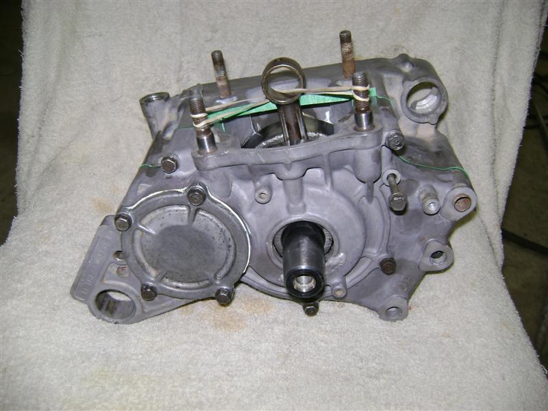

Crank installed in cases with new Honda bearings.

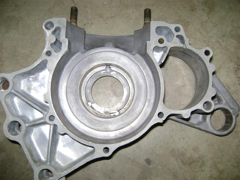

The right side case needs a few hours of cleaning up and rebuilding the water pump before its ready to install, all the rest of the parts are plenty dirty too. :-)
