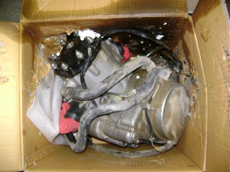

Packing was pretty good it was the box in a box thing but the Engine was allowed to flop around inside the inner box, no good, they also didnt drain the oil out of the balancer case.

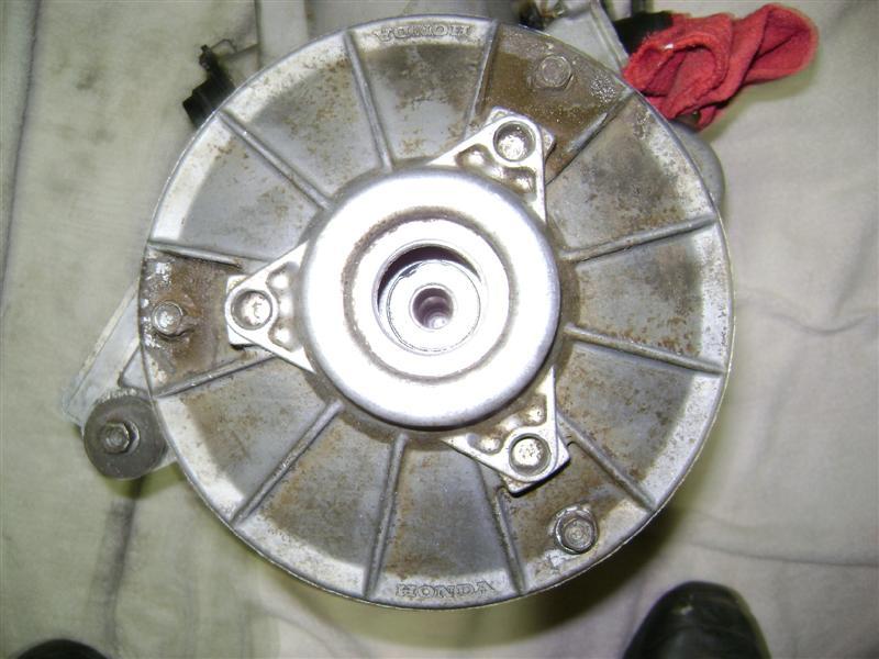

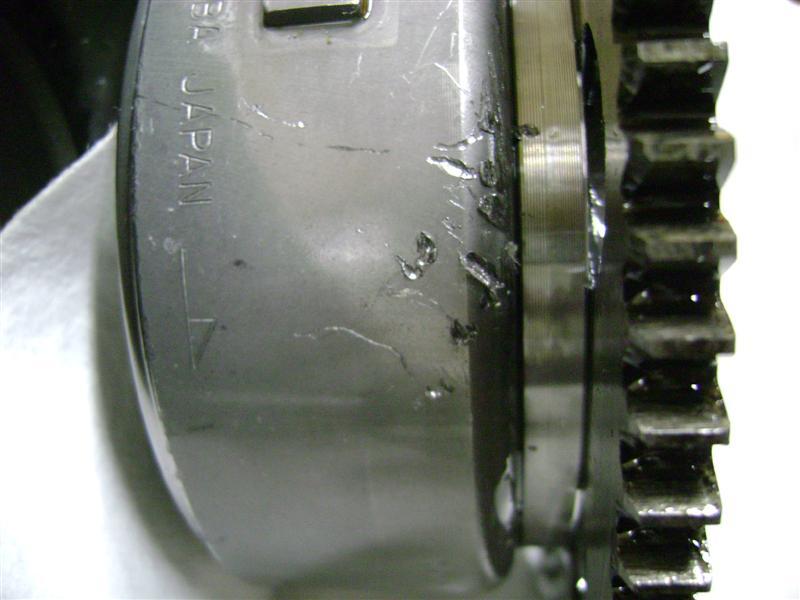

The Engine is pretty "COMPLETE" it even has the stock clutch, someone removed the plug and the bolt but the rest of the clutch is still their, its not worth much its well worn but still usable.

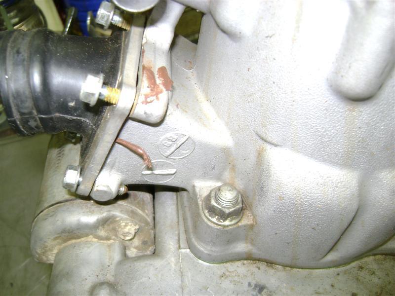

PostPosted: Sun Dec 07, 2008 2:37 pm
These are all as found pics, silicone queer did up the intake manifold pretty good, the reed cage is missing and 1/2 the bolts were as you see them.

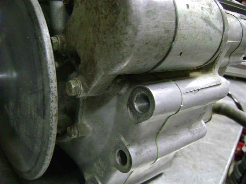

PostPosted: Sun Dec 07, 2008 2:38 pm

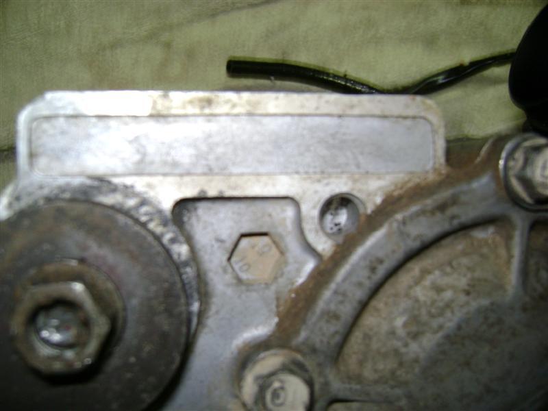

No dowel pins in the cases for the Engine mount, better order some so when this Engine is ready to be installed your sure to have them...

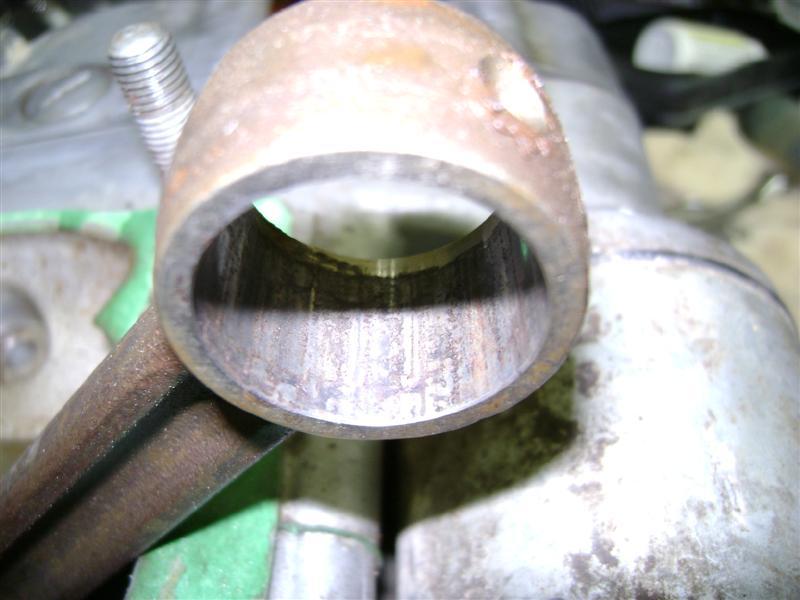

PostPosted: Sun Dec 07, 2008 2:39 pm

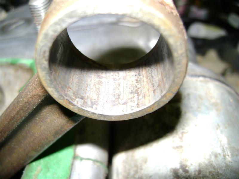

Rusty rod is never a good sign.

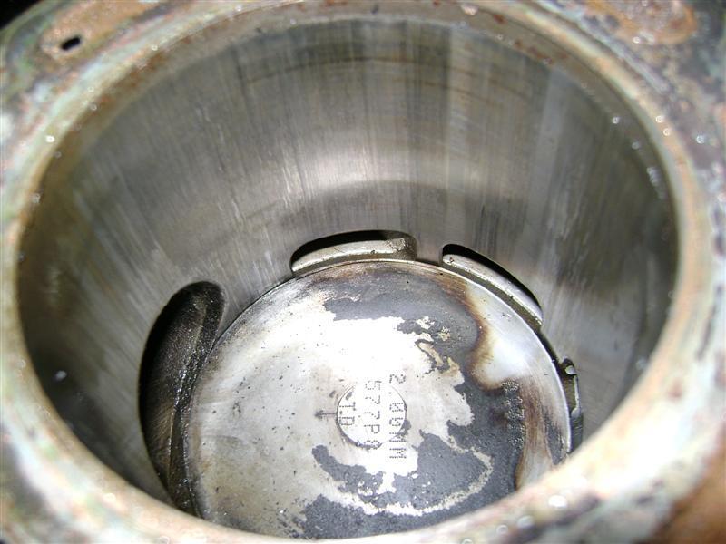

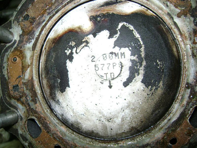

PostPosted: Sun Dec 07, 2008 2:42 pm

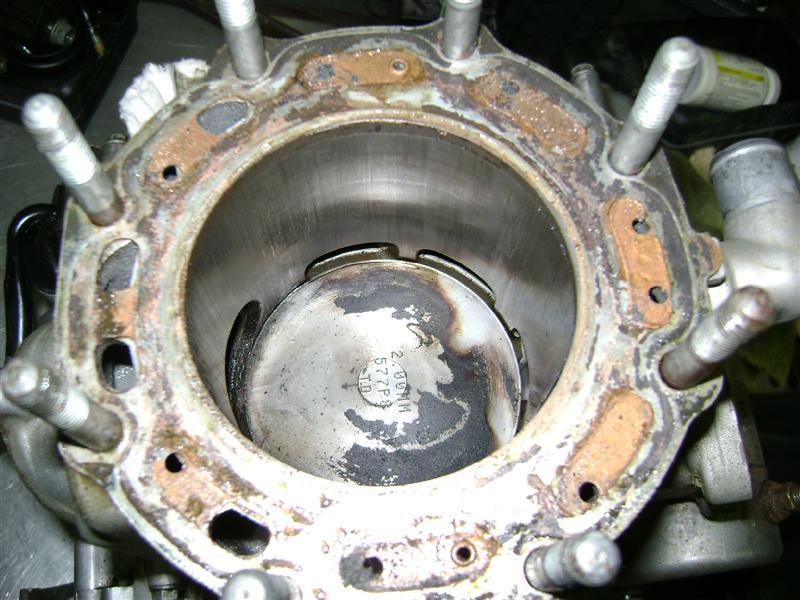

Copper coat on the head gasket 2.0mm over bore wiseco.

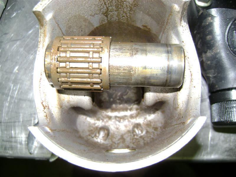

I had a hard time removing the wrist pin had to use the pin puller the whole way.

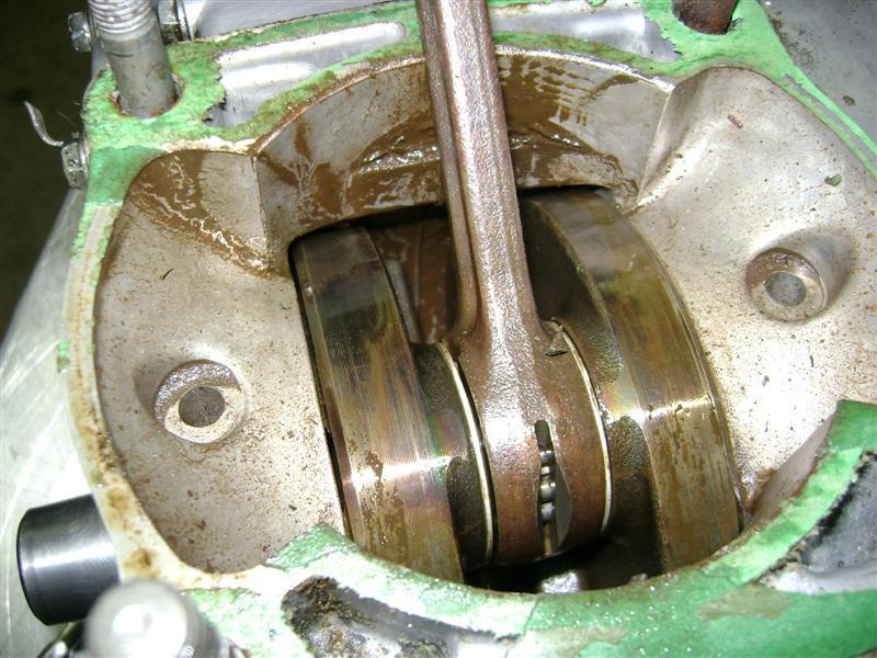

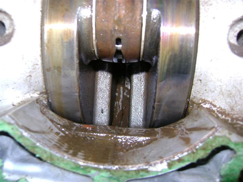

Time to go into the bottom end from the outside looking in it don't look pretty...

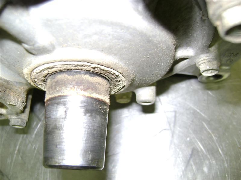

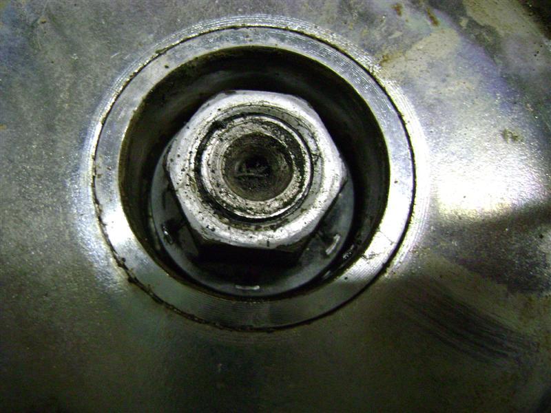

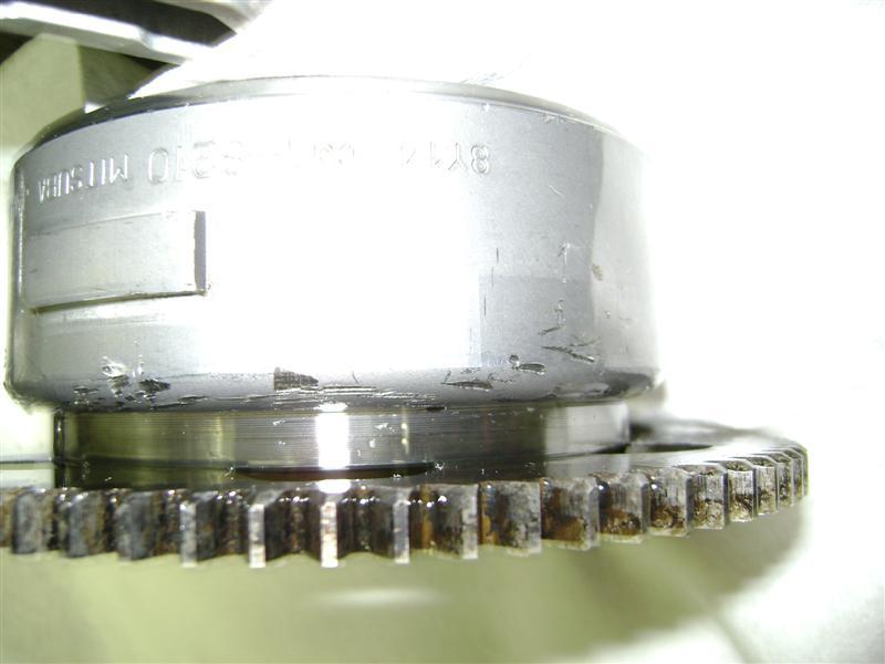

PostPosted: Sun Dec 07, 2008 2:47 pm

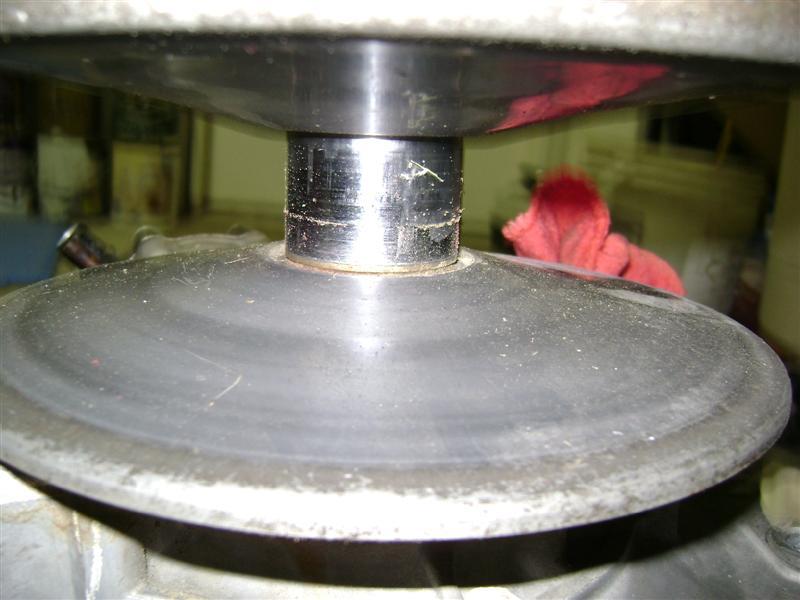

Someone used the wrong puller on this Engine you can see where they mushroomed the end of the crank, the nut came off real hard all the way....

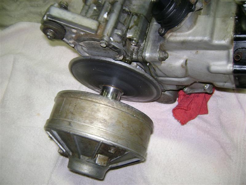

PostPosted: Sun Dec 07, 2008 2:48 pm
It looks like a caveman wheel puller was used at one time .
PostPosted: Sun Dec 07, 2008 2:49 pm
Once removed you can see they had a hard time trying to get the WRONG TOOL to work.

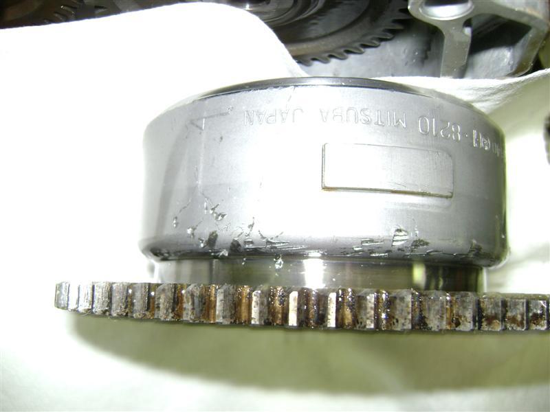

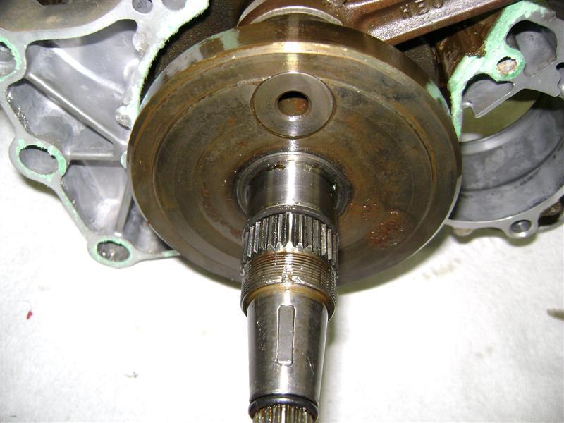

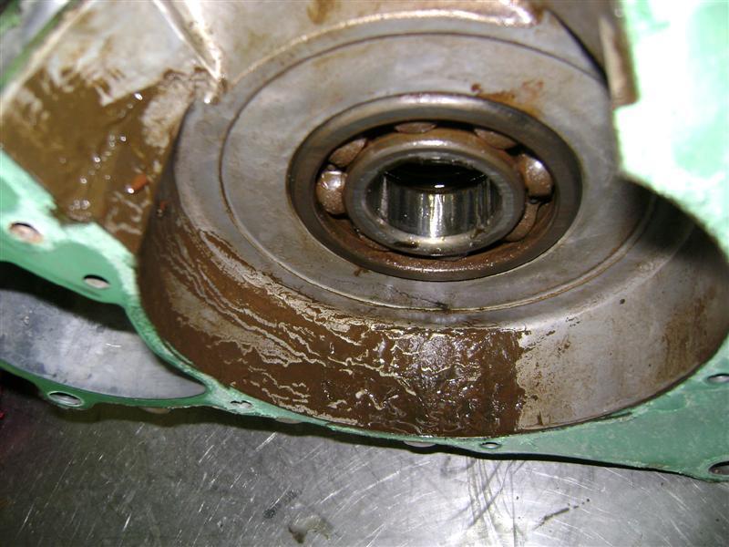

PostPosted: Sun Dec 07, 2008 2:51 pm

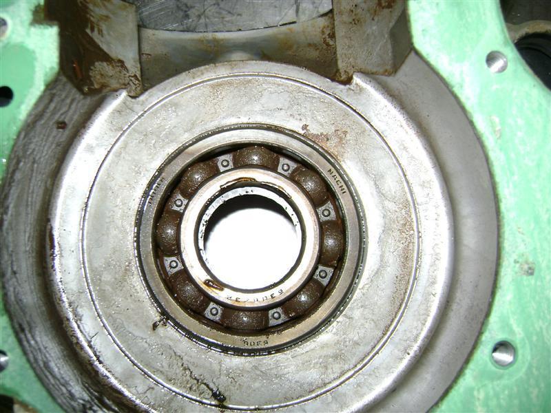

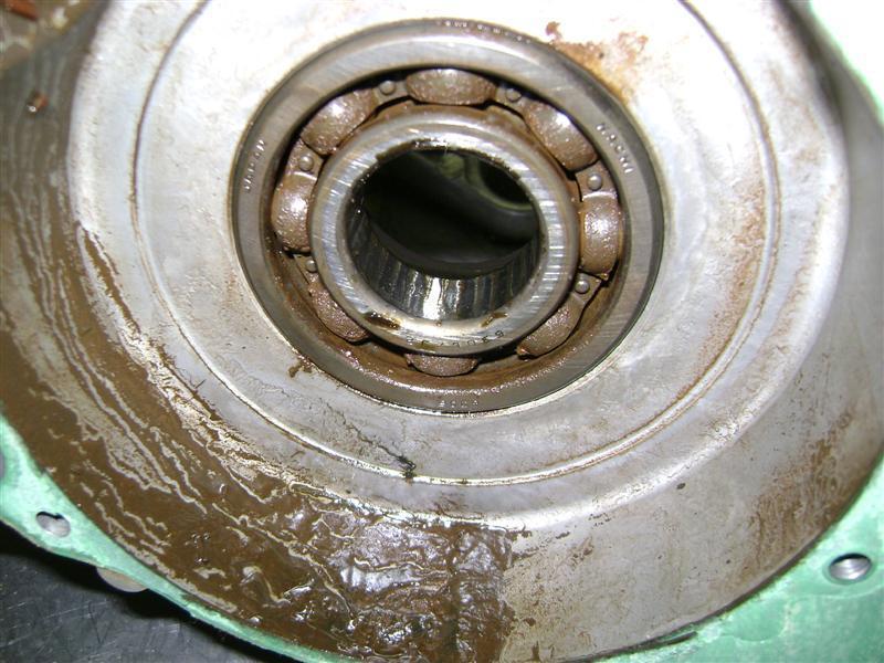

Cases split, rust on the bearings no wonder they felt rough when you turned the Engine over by hand...

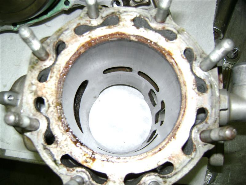

Top of the cylinder even had rust on it, the head was loose I assume the Engine quit running and they pulled the head then it rusted in storage?
PostPosted: Sun Dec 07, 2008 2:54 pm

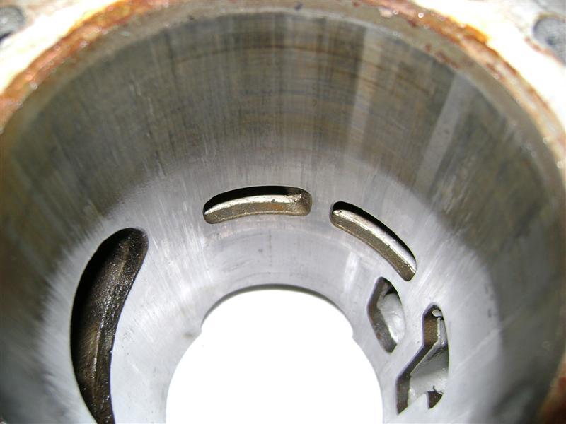

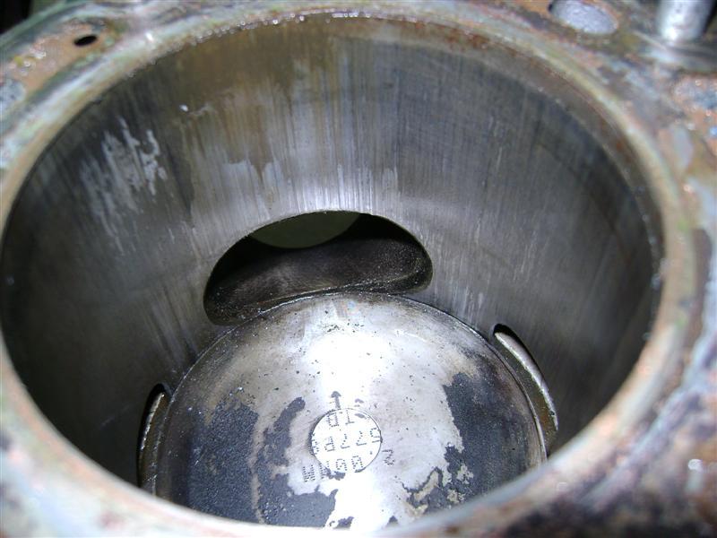

Bore looks like the Engine was run without a filter and sucked a bunch of sand, I would like to see the filter setup on this Pilot, cylinder on last bore, new crank cases I bet this engines owner had a long and expensive life changing parts...

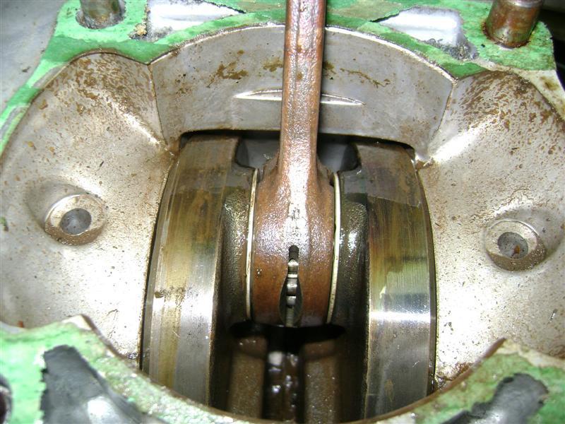

The crank has a blue mark on it, it looks like the big end of the rod bearing may have failed and the crank was rebuilt, I will take a closer look at it once I get it cleaned up.
