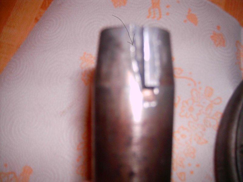

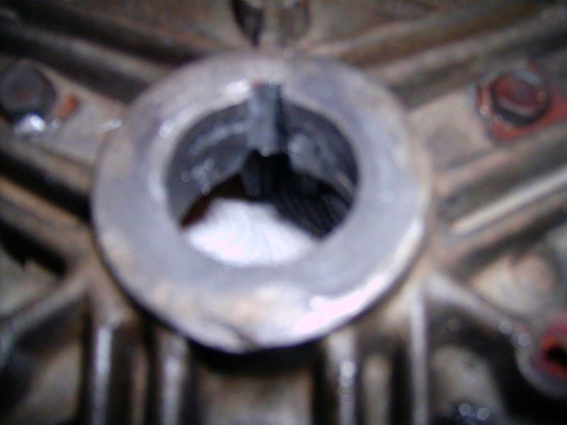

well got my second wind and started on it again.Fixed the carb and I would say the noise seems to be the clutch.Took apart clutch and the only thing i can figure out is theres something wrong with the way I;m installing key,but i don't know what.Look at pics,where key goes it kind of widened the grove where key goes and created a lip on shaft that I had to file down.Pics are blurry but i think you can tell what Im talking about.Put everything back together and tried again but it still sounded awful so i don't know what Im doing wrong
File comment: made lip on side where arrow is that I filed down

took clutch apart again tonite and put it back togther and i think I got it,bad news is the carb problem i thought was fixed is not.When idling gas is dripping out of somewhere,cant see where.Is it ok to remove airbreather and run Engine so i can get a better look at carb to see where gas is coming from?
