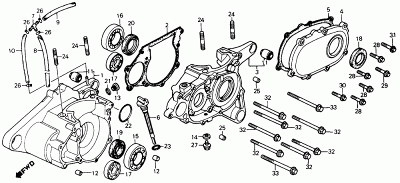

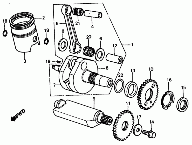

KIWI - you stated above that you put a lot of plain fuel in the spark plug hole. Given the fact that you were not running oil in your fuel - you have probably wore your Engine out. without oil to lube the moving internal parts they have probably gotten hot and have excessive wear. I believe I read you noticed a mist of fuel coming out of the fuel pump pulse line. That is probably due to the fuel you pored in the spark plug hole - the fuel has probably ran to the bottom of the Engine dissolving any oil that the poor bottom had left and I'm sure you internal Engine parts are now dry as a bone.
You probably need to deal with the fact that the Engine is shot due to no oil in the fuel. If you keep turning it over you will only continue to damage. Hopefully your crank is not ruined. It time for a rebuild. If you want to try it your self we will help as much as we can. If you need some one to do it for you may want to ask hoser. you need someone who understand the old school 2cycle engines. If your not using the fuel pump then the pulse line hole needs to be capped off. And I haven't even mentioned the damage running an Engine without a air cleaner can do.
I would say at least, you will need a bore job, complete gasket set, piston, rings, crank bearings and seals. You need to read the manual like I have told you at least 3 times. Price the parts you may need and go from there.
there are a lot of good rebuild post here and plenty of pictures - spend some time searching and reading this site.

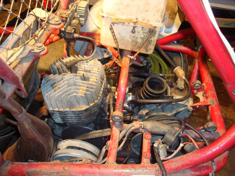

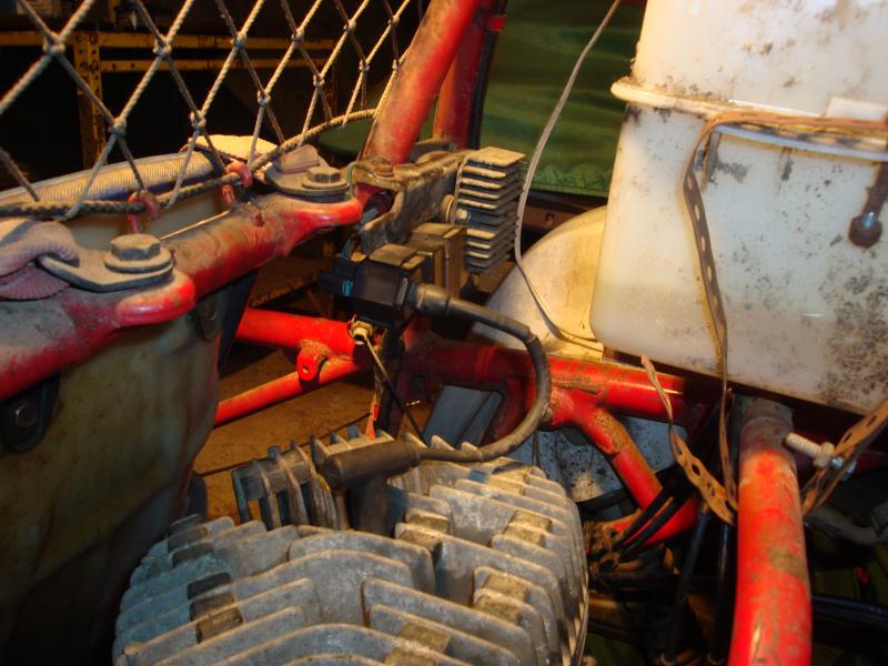

PostPosted: Sat May 11, 2013 11:43 am
Joined: Sun May 05, 2013 8:32 pm
Posts: 111
these are some of the pics... two or three more to come
