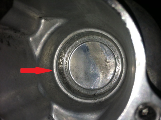

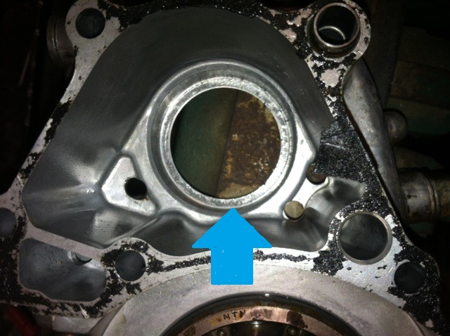

Ok I got my cases pretty clean or enough that the bearing area can be seen. If you look close you can see where there has been some movement. But I got the Loctite in today so maybe this afternoon after work I can get the bearings set, I also dropped my crank off at the shop so they can install the new rod and bearings and shims. So far so good for the day. Thanks Billy
File comment: Notice the area on the left.

Something to think about if using the Loctite cylinder retainer. Since I have not installed in an Engine I can only speculate that the bearing must be centered, Maybe before squirting the Loctite in the case, Set you case halves and balancer aside and ready for a mock up. Then squirt the Loctive install bearing, or per Loctite instructions, thec assemble cases. Leave assemble until loctite drys. Maybe set the cases in a fashion where the bearing is setting flat so that it dries centered.....Then again the bearing might just self center since were only talking about at most .01 gap. Anyhow just my 2 cents and some change
 Post subject: Re: Engine Rebuild
PostPosted: Tue Mar 18, 2014 7:29 pm
Posts: 363
Location: Anniston, Al
Stix I'm with you on the alignment, but I got lucky and they fit pretty tight. BUT one of my crank bearings fell out when I bumped the case on the work bench. So I went ahead and sealed all of the bearings. When I ordered the parts from odatv1 he sent everything and the (hard to get) double lip seal fit great but I have four O-rings that I am going to have to find out where they go. I installed the one that fits in the balancer side spacer but I haven't removed any others. If you know about any of them please give me a holler. Thanks Billy

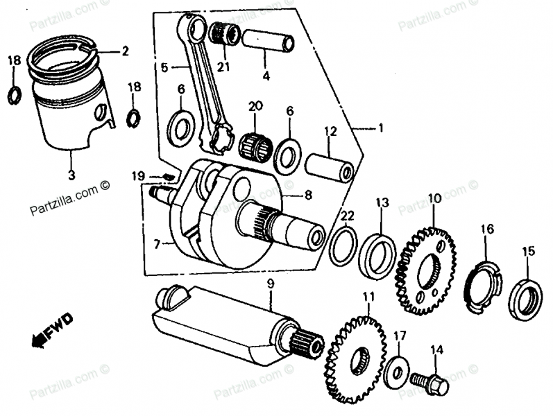

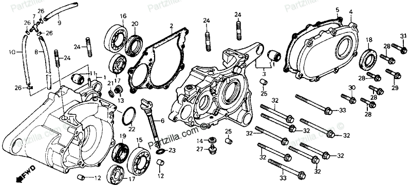

Looks like 21(alternator cap), 22(balancer?) and 23(dipstick) for first pic of crankcase diagram and the 22 for crankshaft. Not sure about the 4th O ring, been a few years since Ive been inside the 350 Engine
