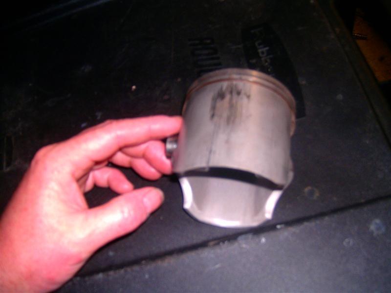

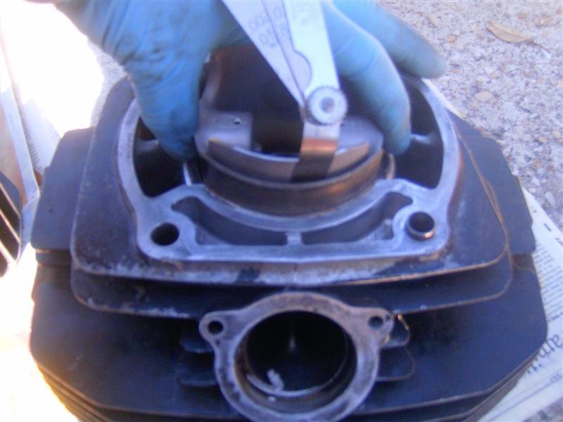

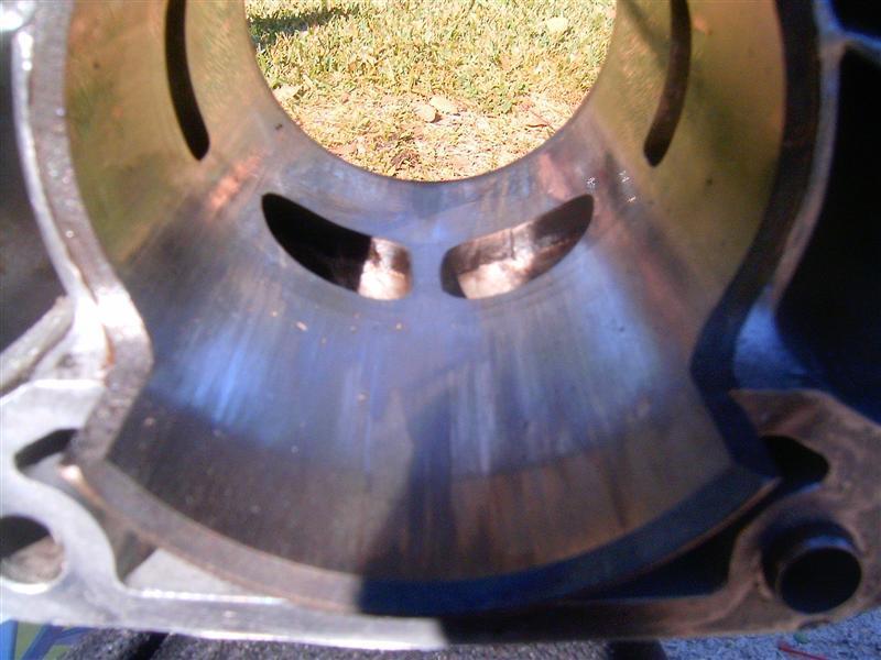

heres some more pics,just cleaning them up now,getting old gaskets off and stuff
Did the quick and dirty method for cylinder check,thickest feeler I could get in was .003.Like I said before,I don't know what I'm doing,will be taking it to a professional sat

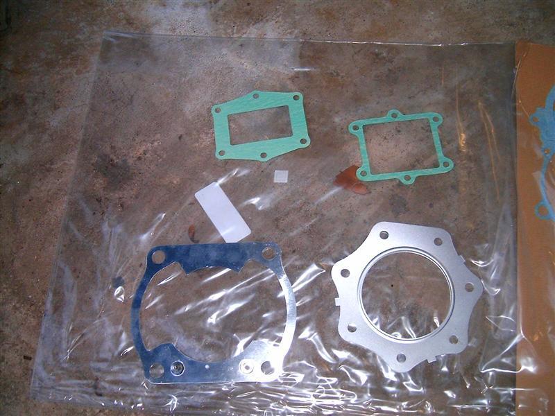

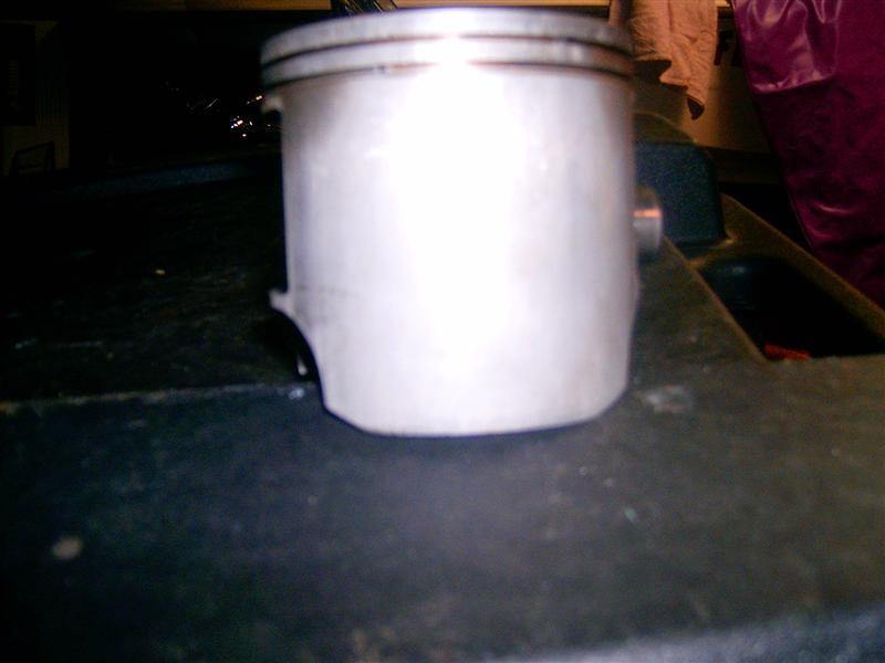

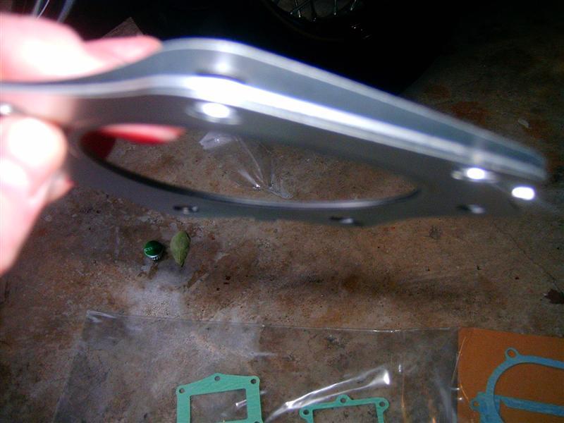

got my cylinder back today so will be starting soon on it,had some questions before starting
1.does the piston face the exhaust port where the holes are drilled in piston?
2.do you put something on the cylinder to hold the gaskets?
3.ordered the complete set of gaskets from service honda,the bottom gasket is just one metal gasket but the top gasket is 3 stuck together{see pics}I think ive read different views on how many gaskets to use,so need some advice,
thanks again to hoser for all the help

PostPosted: Tue Apr 14, 2009 1:53 am
Posts: 1346
Location: Benson, NC
1. yes, the purpose of the holes is to help lubricate and cool the bridge in the exhaust port to keep it from swelling. That is the hottest part of the cylinder and a common source of seizures in stock motors. There is usually an arrow on the top of the piston as well that points to the exhaust port.
2. I have never used any type of sealer or such on the head or cylinder gaskets. Not sure if they make anything designed for use in those areas.
3. Most will just use one of the thin outer layers of the head gasket when running the stock head. Aftermarket heads have smaller domes and can create high amounts of compression so using the complete gasket is better for those, I just learned that one the hard way. see my recent seizure thread.
viewtopic.php?t=5330
which ever you go with just check the compression and see where you are at. using the full gasket will lower the compression and using the thin part will increase it. I think stock is around 130 or so ???? some one will correct me on that.
Turbo is right too, make sure you use a torque wrench when tightening the head nuts back up. They are very easy to over tighten and strip out the stud hole. Also learned that one the hard way :-) I got mine from northern tool for $35 bucks or so, and it is a must for working on atvs of any kind.
