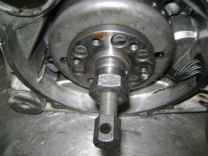

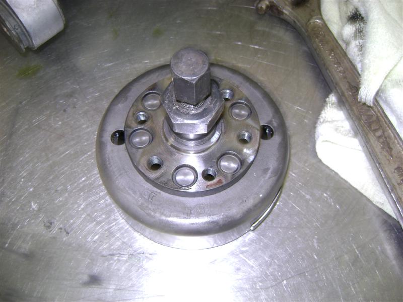

Ok back on Fatcat's Engine weather too crappy to ride so no use rushing Mudbogger's LT Pilot I have all the parts I need for this Engine so I want to get it done besides it looks like he is about ready for his Engine back. viewtopic.php?f=5&t=9906

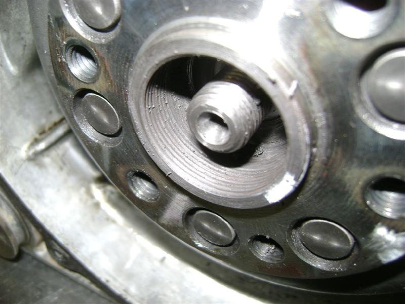

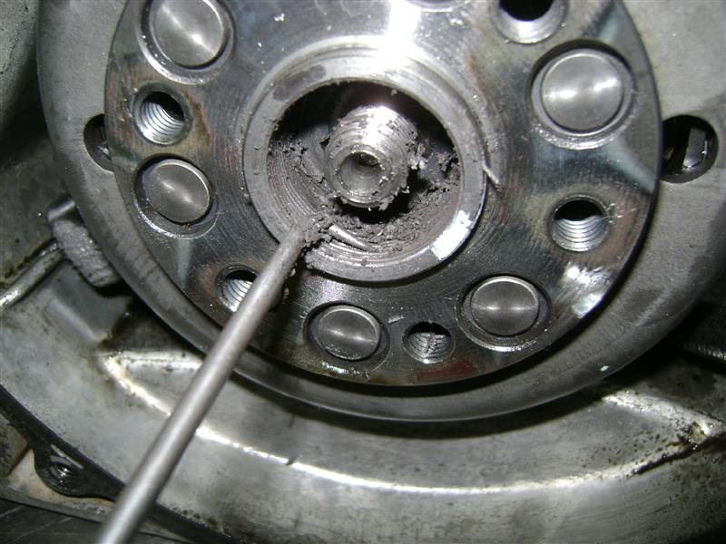

This thing with the flywheel threads missing has been pissing me off so after thinking about it since our last discussion here about flywheels I decided they have to be their and they ARE they were just neatly covered with a mixture of oil and dirt!
Lesson learned check to see if threads are filled up with dirt.
Flywheel pulled per service manual using the specified tools. Skillbilly acts or caveman tools not required :-)

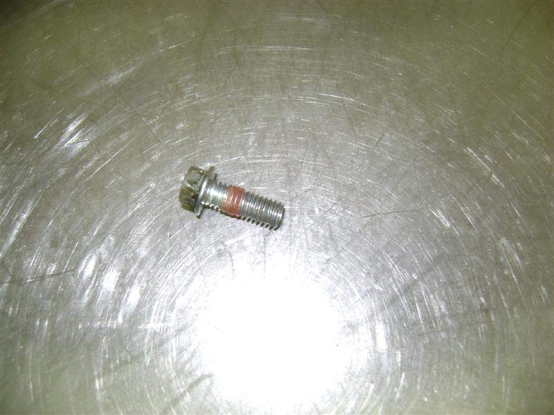

Bolts that hold stator require loctite you can see the factory applied...

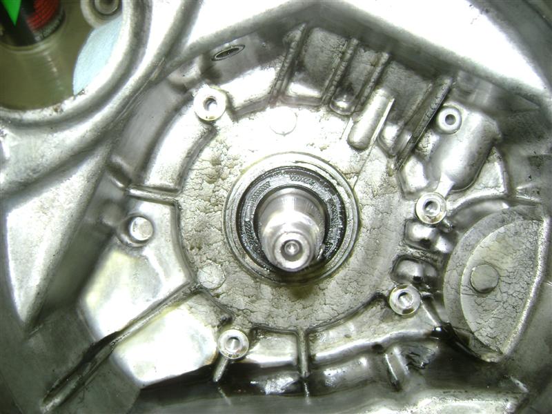

Stator removed so can clean up oil slick, the stator assemble will just be wiped off with clean paper towels no solvents or cleaners will be used for risk of damage to winding coatings.
350 crank seal replacement.

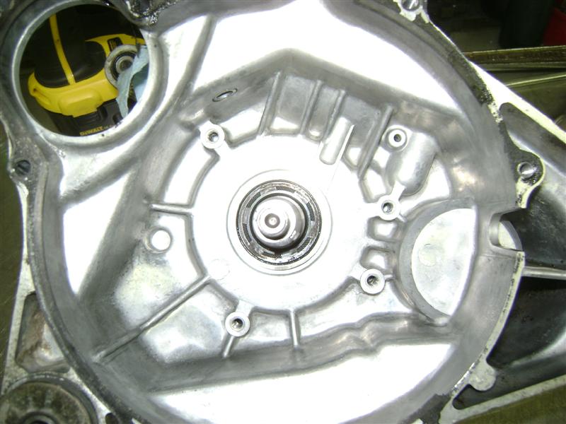

Cleaned.

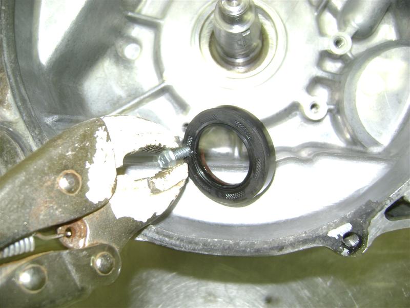

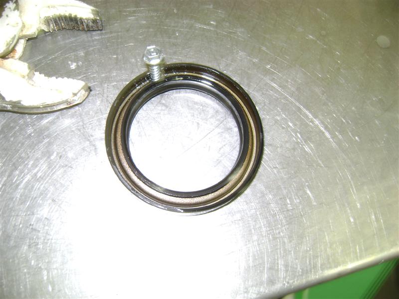

Carefully run a screw into metal part of the seal then pull

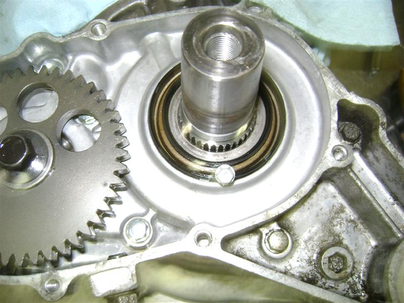

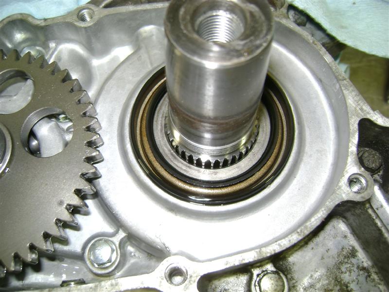

On to the clutch side seal replacement remove the clutch then the cover then the big nut and drive gear to expose the seal notice the metal side facing out.
PostPosted: Sun Apr 15, 2012 12:53 pm
Run a screw in the seal and pull it out.

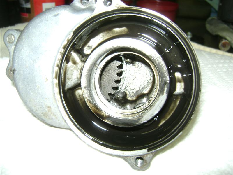

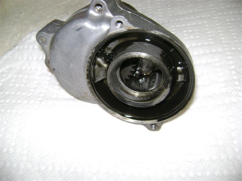

All three seals replaced, took the starter apart it had a little oil inside so I cleaned everything up by just taking clean rags and gently wiping the oil off didnt want to use any solvents on the armature or permanent magnets I did use some of that electronics cleaner on the brush assembly.
Some as found pics.

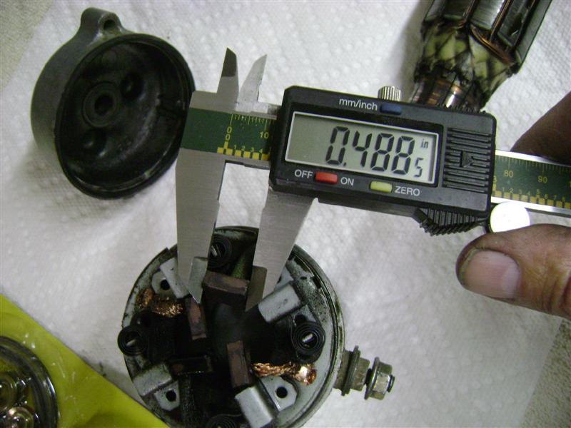

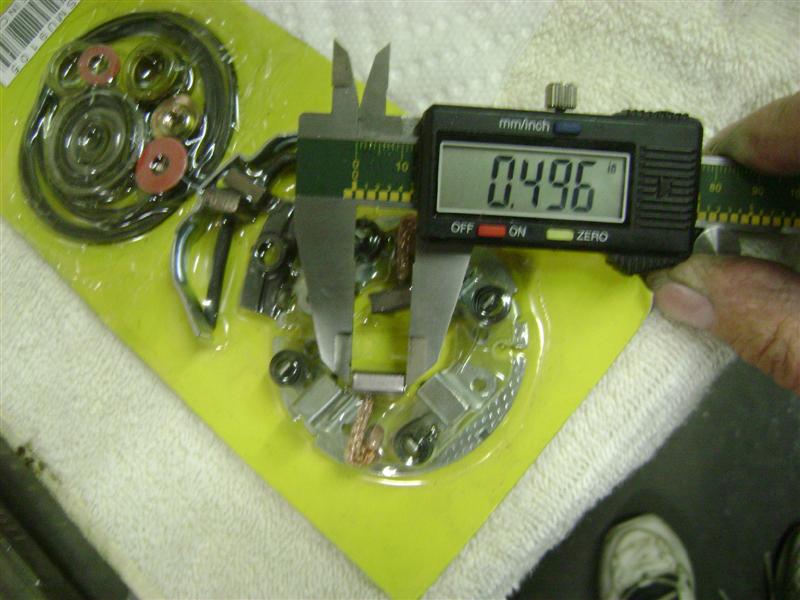

Measured the old brushes and the new brushes almost no wear on them no use replacing, the bearing and bushing was in good shape so was the O rings so saved the rebuild kit for future use just cleaned everything up really good lubed the bearing and bushing then reassembled.
