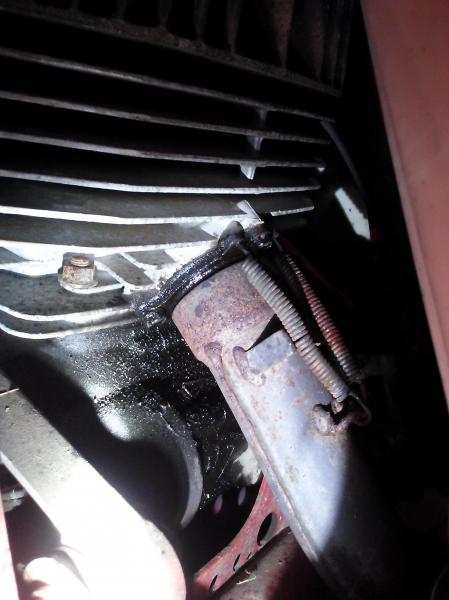

This might be a dumb question, but I was checking my exhaust manifold to measure for the pressure test, when i noticed the oil leakage. Picture may not be the greatest, but would be any concern? Should I replace the exhaust gasket?

PostPosted: Fri Aug 17, 2012 8:41 pm
http://www.pilotodyssey.com/Siliconesealer.htm
that's the unburned gas/oil

PostPosted: Sat Aug 18, 2012 1:55 am
your leaking between the pipe and the manifold. Remove the pipe and clean both the inside of the pipe and the outside of the manifold and go get some yamabond from the yamaha dealer and put a layer on the inside of the pipe and the opuside of the manifold and reassemble. Make sure you use enough to stop the leak. works great for all my machines
PostPosted: Sat Aug 18, 2012 6:53 am
It will also be much quieter. Mine was leaking at every connection. Last sunday I resealed my pipe and it really made it quieter. I had some concerns with this though. Now if I seal the point where this sludge is running out(which I did) where will it go? In my silencer? Will it eventually plug it? Will it just blow it right out the silencer? All gains? Is nice not seeing this junk on the floor under my buggy but I know its got to be going somewhere. Maybe im over thinking it? I can get myself in trouble with that at times. I'm not concerned about rust since it's oil, just that It might cause another problem later. Thoughts?

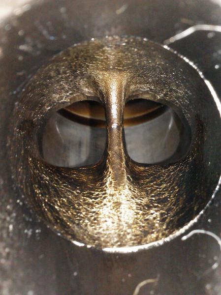

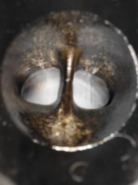

I don't think i have a carbon issue, because everything seems clean in the exhaust port. Here are pics to make a call.

PostPosted: Thu Aug 23, 2012 6:44 pm
Address the rust in the gas tank.
Almost looks like some vertical scuffing on the cylinder wall in the top picture on the intake side of the cylinder?
Also looks like a brown tint on the cylinder wall like blow by from the rings or is that just the oil ?
