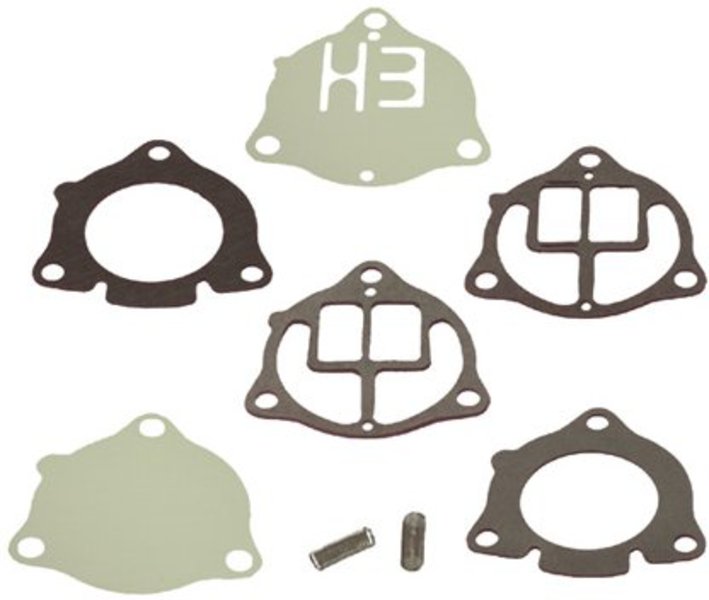

PostPosted: Fri Aug 01, 2014 10:41 am
No need to buy a new pump, rebuild the one you have.
Winderosa makes a very nice rebuild kit for the FL350 pump. I have rebuilt 2 of them and they work just fine.
