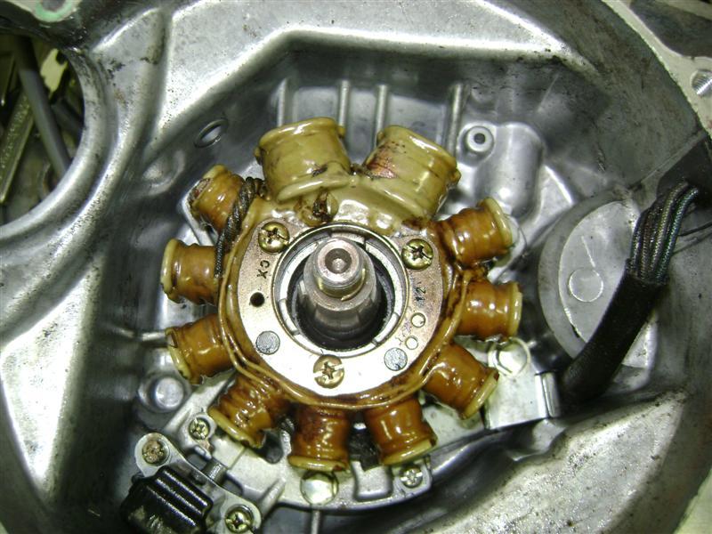

Pulled the flywheel popped right off using the correct puller, noticed part of the stator is discolored a little, lighting coil windings getting hotter than the ignition windings?

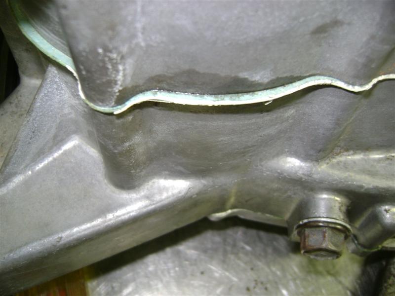

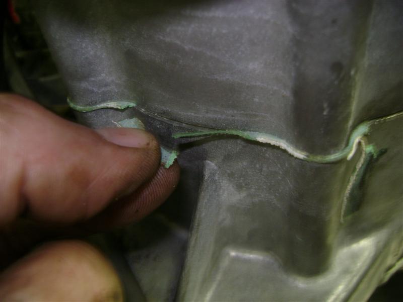

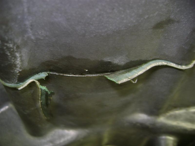

You can see the gasket sticking out of the cases that probably why Turbo could not hold pressure on the leak down test, right now I ASSume when the big end rod bearing failed the rod then made contact with the cases and spread the cases just enough the gasket no longer has compression on it, will know for sure once the cases are split.
File comment: Can pull it out with my fingers

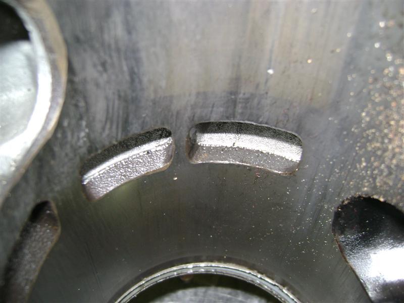

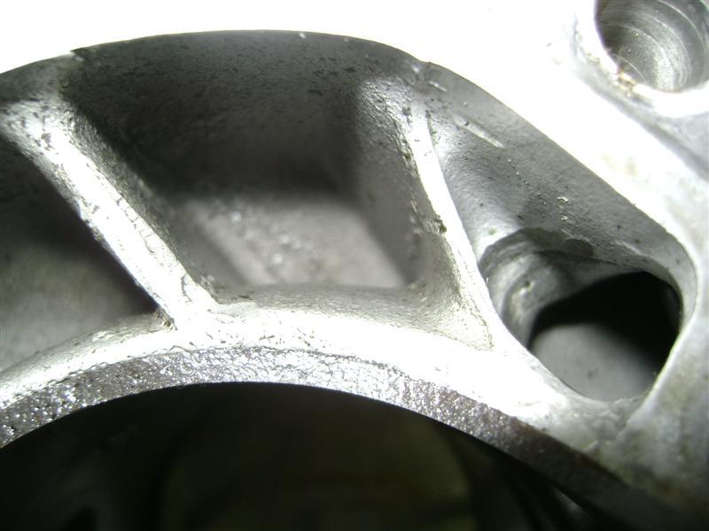

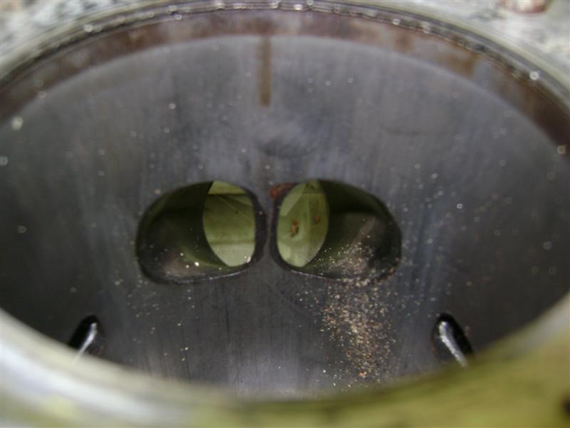

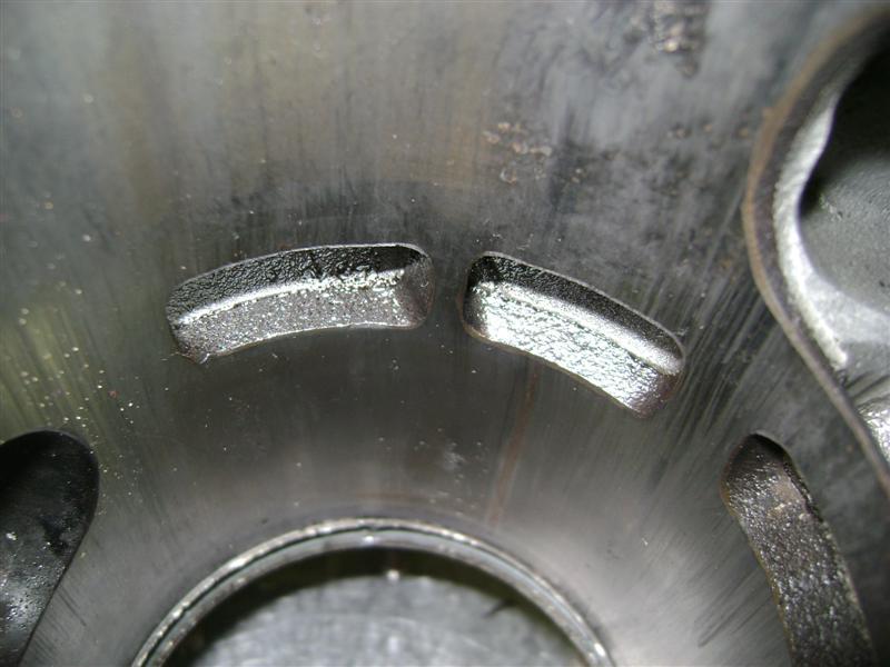

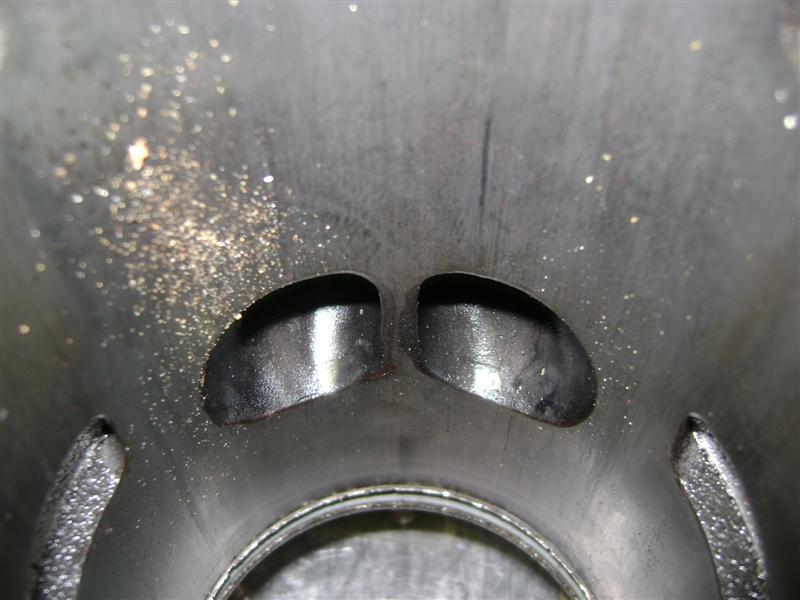

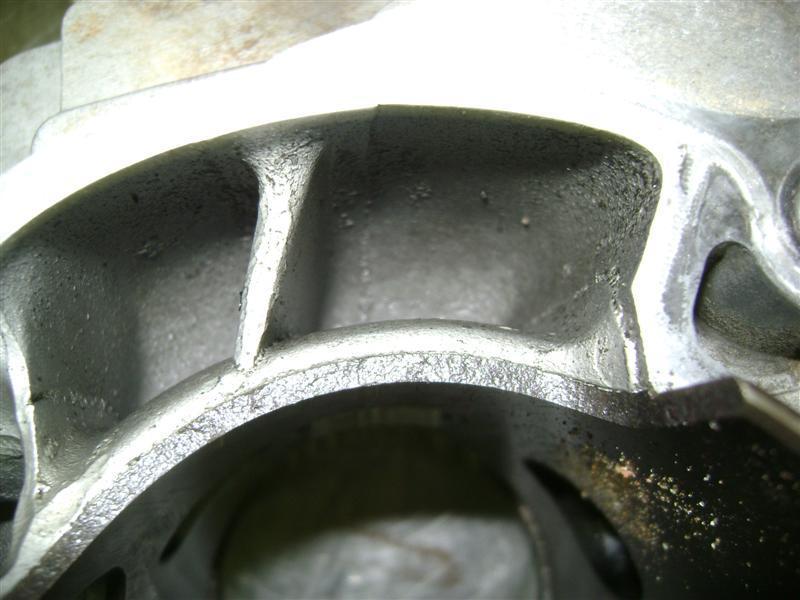

This cylinder was supposedly ported by ATV Racing?
The only thing that's been done to this cylinder was the exhaust was modified slightly, hope you didnt pay for "porting" this is not the FIRST cylinder I seen that came from ATV Racing that was allegedly "ported" .
File comment: Transfer port roofs never been touched.
File comment: Transfer ports not touched.

wow never new the cases could distort like that and not crack

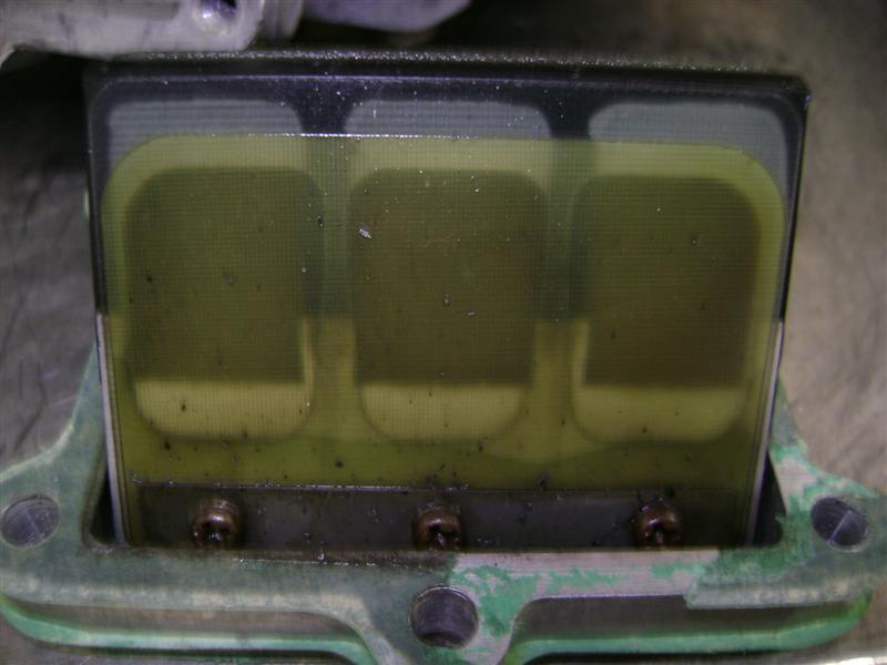

Stock reed cage with boyseen reeds

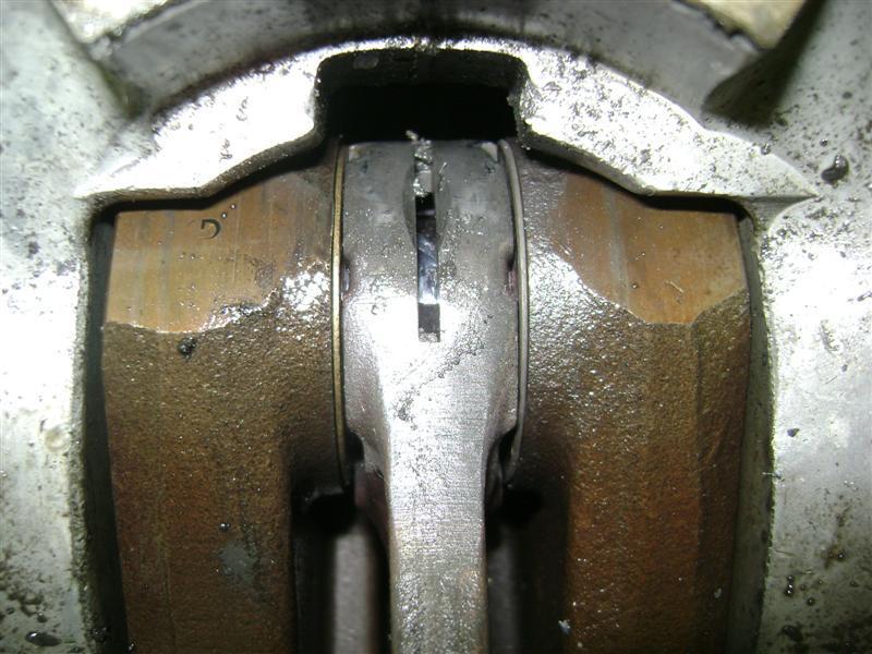

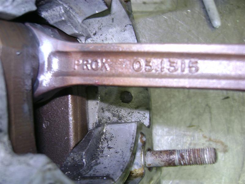

Rod is toast time to find another crank or figure out who to send this one to for a rebuild.
PostPosted: Fri Sep 18, 2009 5:58 pm
PROX rod was installed the last time, is the HONDA rods still available?
FL350 replacement rod kit ProX Connecting Rod 03.1315
Our Price: $68.44 http://www.powersportsuperstore.com/Pro ... lick=35177

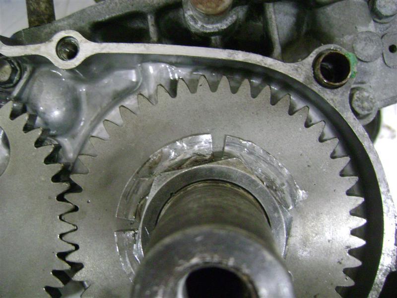

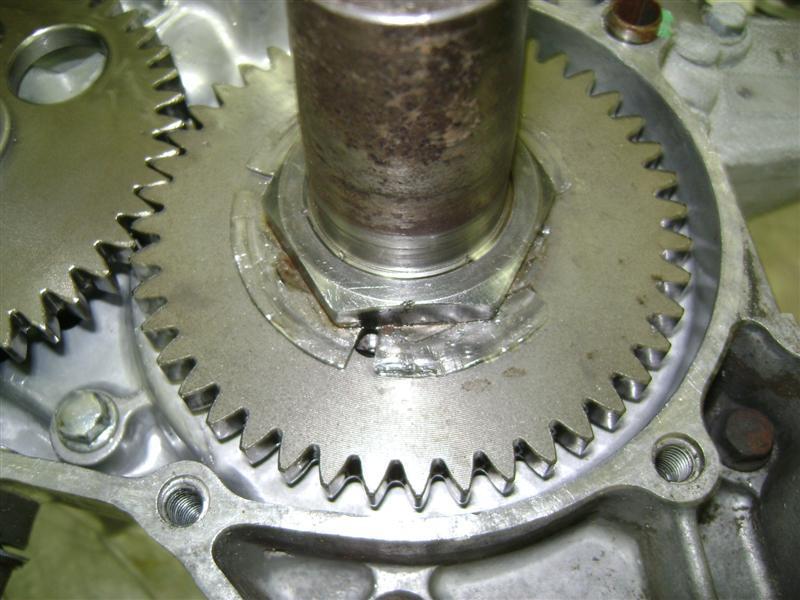

Balancer cover bolts were not very tight maybe TuroTexas had already removed them?
Also noticed the large nut on the crank was not staked.

hoser can those cases be saved after distorting like that

Usually the gasket surfaces can be lapped down enough they will seal perfectly once again, wont know for sure until I get them apart and see what the real damage is.
I removed the balancer cover, and tried to remove the big nut so I left the backing down...

Pic #3550,does'nt look like much of a bridge left! :shock:
Plus it snakes! :shock: Would not be very good from keeping the ring from wanting to turn.

I hope you didnt pay ATV Racing for 'porting' or 'trail porting' because they spent about 10 minutes cleaning up the exhaust, heck they didnt even match the exhaust port, signs they just don't have a clue!
Some place I have a port map of a stock FL350 I will see if I can find it and see what changes were made to the exhaust, it looks like it was raised and they might have even lowered the floor a little, don't look like they made it any wider.
