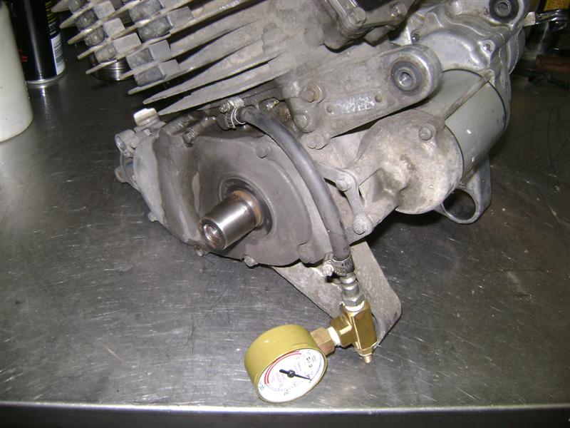

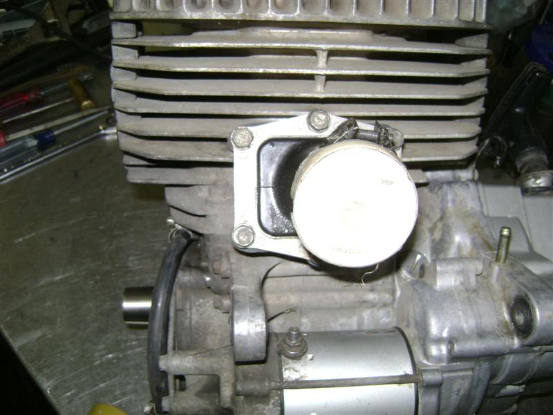

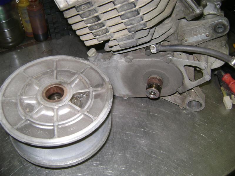

Anyways first thing needs done before taking this Engine apart is it needs pressure tested, the clutch needs removed so I can tighten the clamp for the hose for my tester, then the intake and exhaust plugged up.

The Engine held 10 psi for 10 minutes no leaks to worry about so time to pull the top end for inspection.

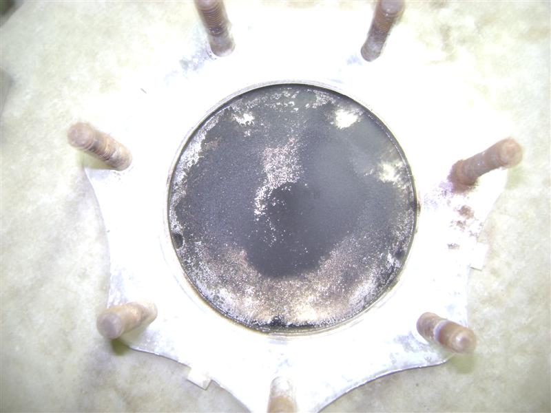

Top of the piston cylinder still on.

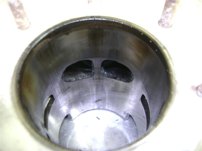

Cylinder has some slight scuffing.

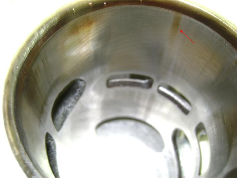

PostPosted: Mon Apr 09, 2012 1:47 pm

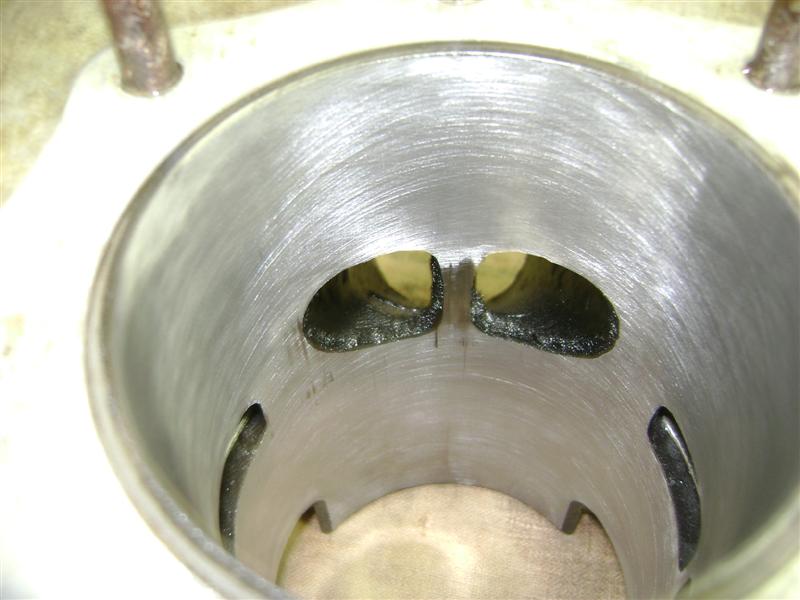

It was run a while with the low compression see the brown stain on the cylinder wall that is blow by, the Engine suffered a mini seizure that looks like it started at the exhaust bridge had they drilled the lube holes per the installation instructions I doubt we would be looking at the inside of this Engine.

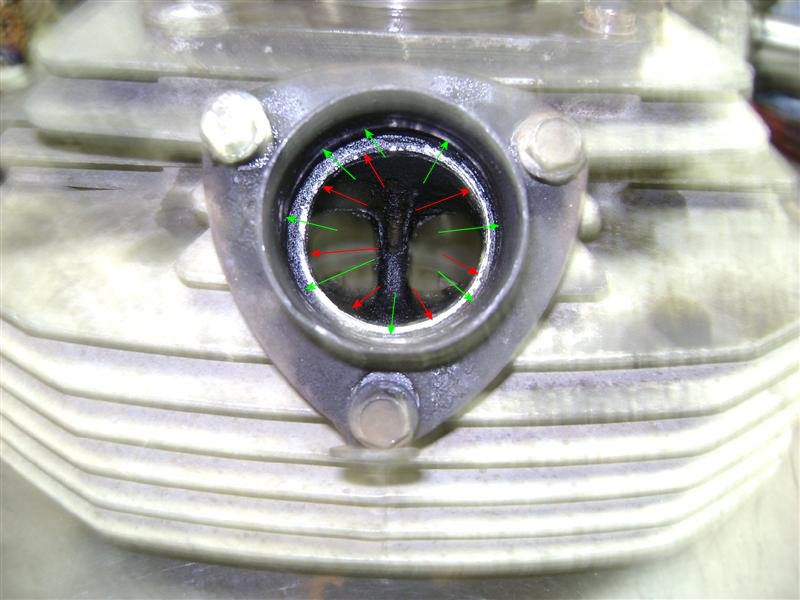

This Engine has a after market exhaust manifold I assume its for a DG pipe see how it does not match.
If this pipe was going to be run with this Engine for the life I would modify the exhaust port tunnel to match the pipe to improve reverse flow and performance, if you ever went back to the stock manifold it would not match because its smaller.
The RED arrows are pointing to the opening in the exhaust port tunnel on the cylinder the GREEN arrows are pointing to where it needs ground out to match the manifold.

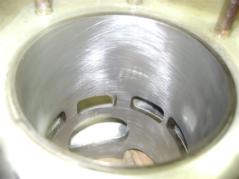

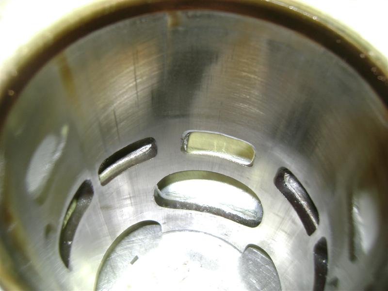

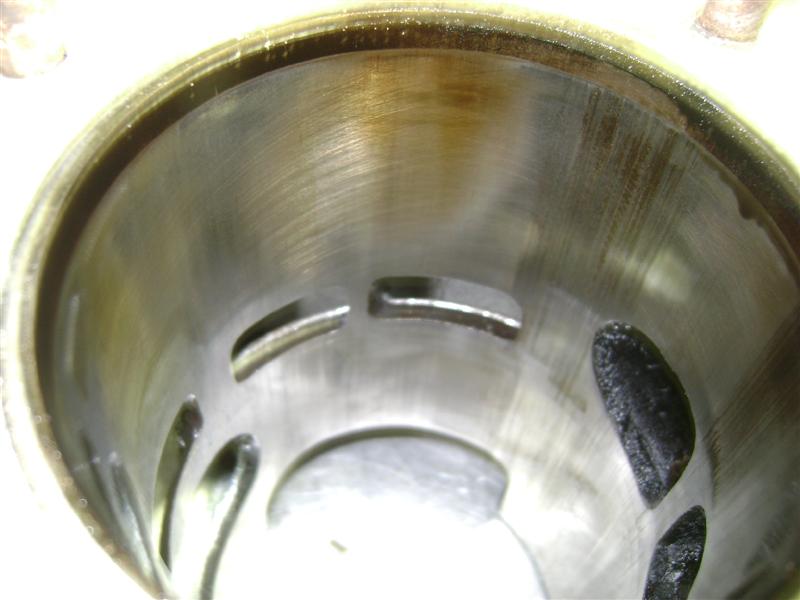

A lite hone of the cylinder with the Sunnen AN-112 ridged stone hone shows slight scuffing to match the scuffing on the piston, the bore is amazingly straight.

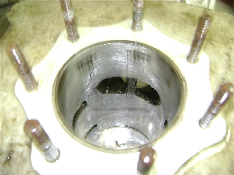

PostPosted: Mon Apr 09, 2012 1:59 pm
After a little more hone the cylinder cleaned right up except for a little scuffing to the side of the exhaust port and on the exhaust bridge itself, if this was my cylinder I would install another piston kit and run it, your only real concern for ring seal is above the exhaust port where the cylinder is under pressure soon as the piston starts to uncover the exhaust port the cylinder pressure starts to rapidly drop off when you lose gas pressure you also lose ring seal anyways, see this Ring seal and heat transfer for more info viewtopic.php?t=1269

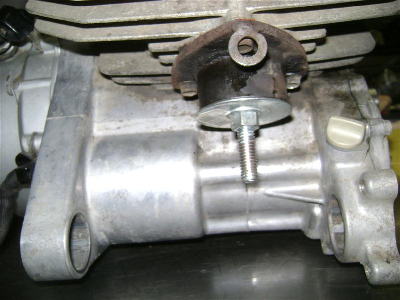

Bottom end has plenty of oil nothing really abnormal found other than oil is still migrating to the starter side of the Engine through the vent system please read this service bulletin Honda released years ago. http://pilotodyssey.com/350sb.htm Starter info viewtopic.php?f=26&t=5939
Red arrows pointing to the oil that flows to the mag side of the Engine.

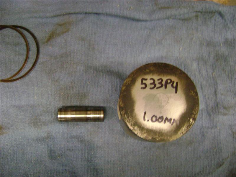

The piston kit Nelly needs to order is a 533P4 that is the numbers on top of the current piston
You also need to order a new wrist pin bearing that does not come with the kit and a top end gasket set.
You will want to shop around for a piston kit the prices vary quite a bit from place to place.

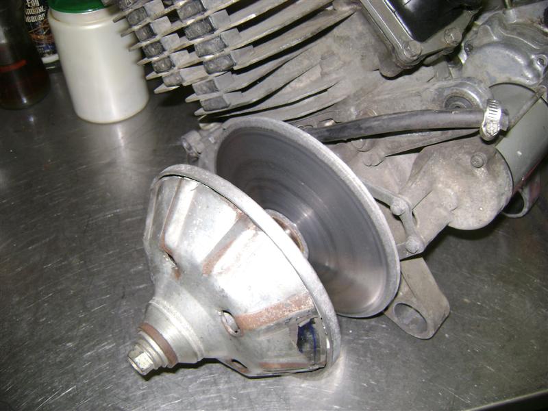

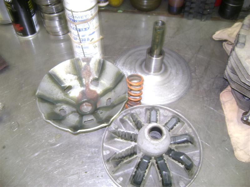

I also cleaned up the clutch and lubed it with the comet clutch lube but did not reinstall the clutch since it blocks the area required to properly install the pulse tube for the fuel pump you need to make sure that tube is on 100% right and no leakage most them Honda clamps are hard to tighten when the hose gets as old as it is you might want to replace the Honda clamps with a regular hose clamp of the proper size for the line.

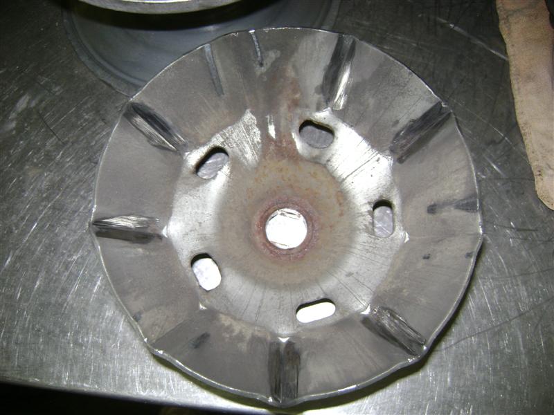

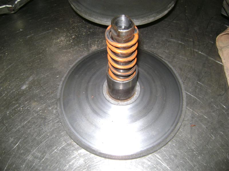

PostPosted: Thu Apr 19, 2012 4:59 pm

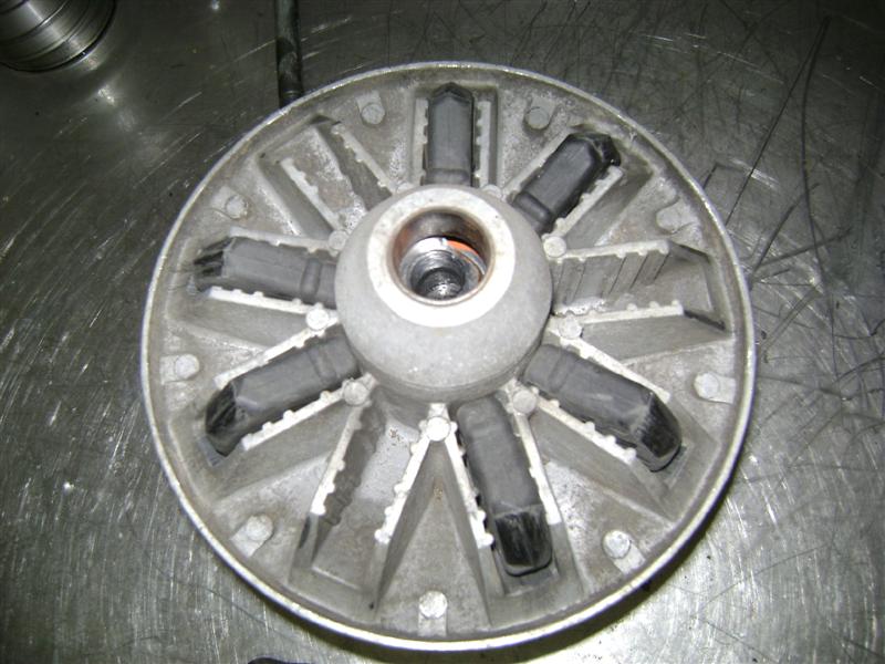

Some clutch pics
File comment: .
All cleaned up, lubed up ready to install
