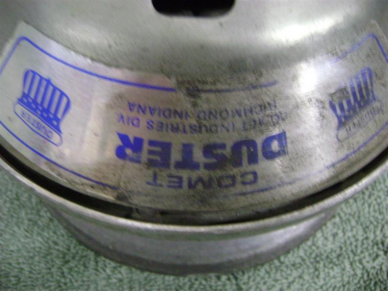

Where are the 94C guru's how does this clutch come apart for servicing ?

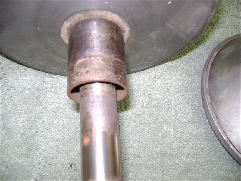

Are you trying to get to the pucks? If so, hold the clutch a couple inches above the workbench with the stem facing up like shown in pic 6101, grasp it by the "outside" movable face , then tap the stem(threaded part)(pic 6102) downward,I use a wood dowel or something as my BFH. the stem will seperate from the puck pressure plate(part with Comet Duster Label/manual calls it the "outside cover") allowin access to the spring and pucks. Good luck w it
PostPosted: Sun Feb 14, 2010 12:29 pm
Yup trying to get at the movable parts so I can inspect, clean and lubricate them, I will give it a go, also so tpreed can see the inside and know how to care for it in the future, thanks!

I have one of them clutches in my shop it has a white plastic bushing the later clutches has a impregnated bronze type bushing that needs no lube, I talked to Harold at HRD about the bushing and he laughed and told me to throw the clutch away buy new, his typical reply is to buy one of his new clutches lmao, its why I don't like him, anyways if I ever go to use this clutch again I will remove that plastic bushing and make a new bushing out of graphite impregnated bronze (think that's what the newer bushings are) and try it, right now even when lubed its hard to slide the movable face off the shaft of the fixed face.

No doubt it was a BAD idea, I've never seen one with anything other than the nylon.
When it was cold it worked well, but after it warmed up it would bind, wet sand it a bit and the binding went awat, but then oit would pick up particles of sand and with the extra clearance the sand would become impregnated in the nylon and start the binding again.

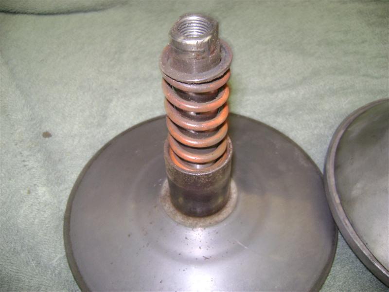

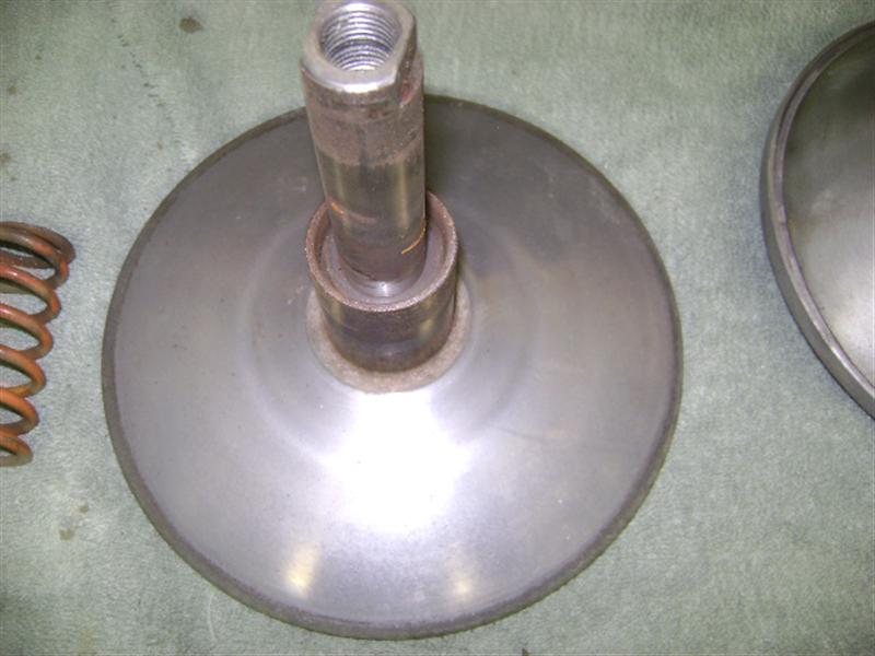

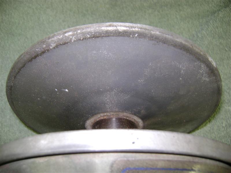

Here are pics of it apart, what parts get the comet lube?
File comment: 6 Pucks installed

I ran this clutch on one of my old fl350's. Randy from odysalvage told me to coat the pucks with comet lube, let them dry and do it again, both sides. I had those same pucks in the same position with the white spring (higher stall than orange), seemed to work pretty well.
