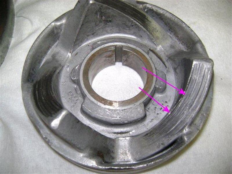

Here are pics of my 90D driven, any suggestions whilst I have it apart?
I assume the deep grooves are from dirt between the cam slippers and cam?

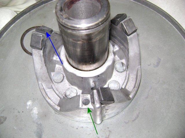

PostPosted: Sun Apr 22, 2007 5:49 pm
One slipper was missing, others are showing signs of wear.

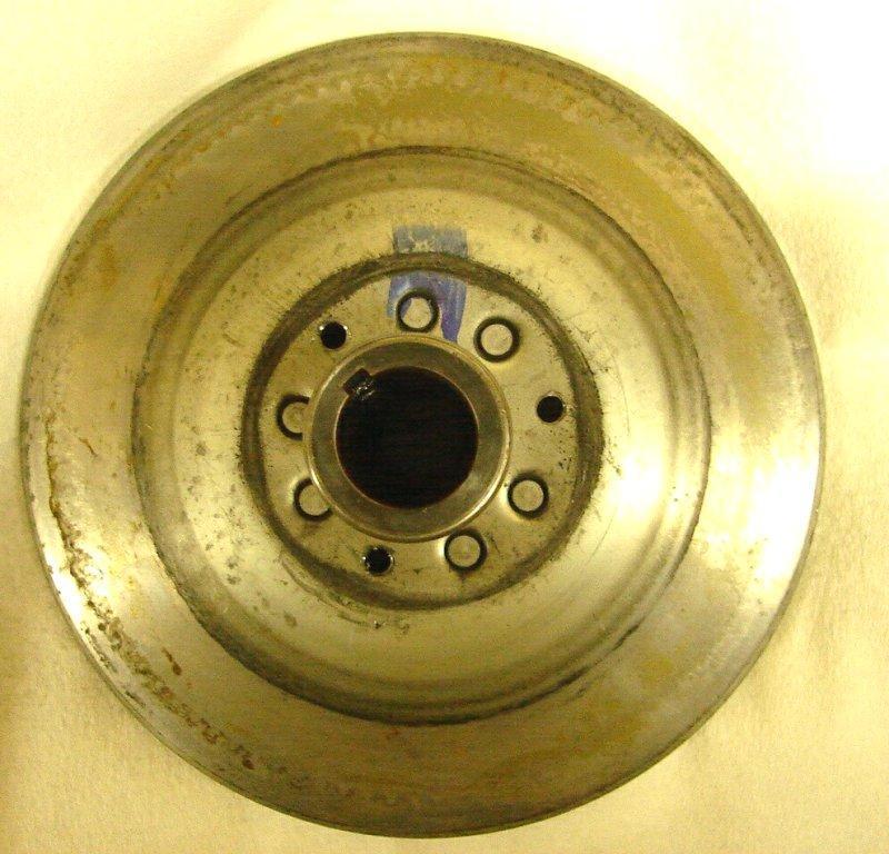

PostPosted: Sun Apr 22, 2007 5:54 pm
When I installed this new I marked the face to see how far it shifts out.

The snap ring grooves wear on this clutch and it is important to put it back in the same direction that it came out - it should have a curved surface to it- I use a piece of 18 gauge wire and wedge it between the snap ring and the housing of the helix. With this and my adjusting shim/washer that fits inside the helix up against the snap ring and wire I have not had anymore problems with the snap ring coming loose and popping the clutch apart on the trail.
