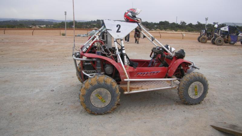

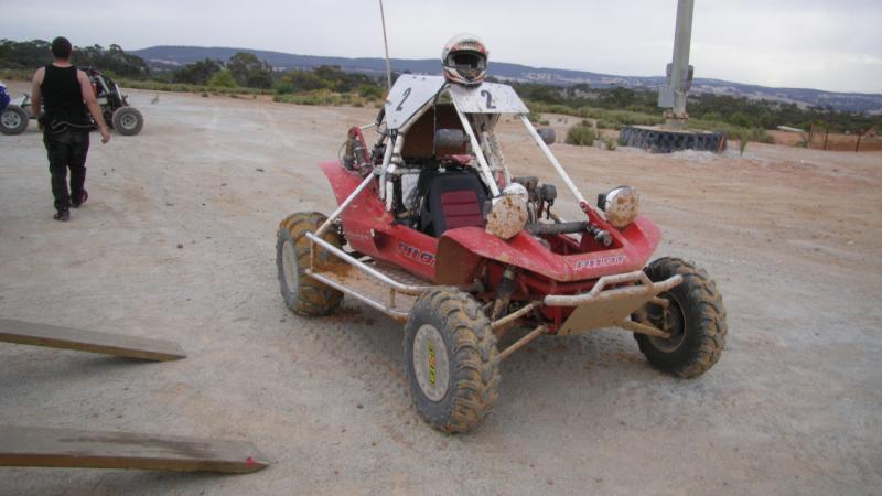

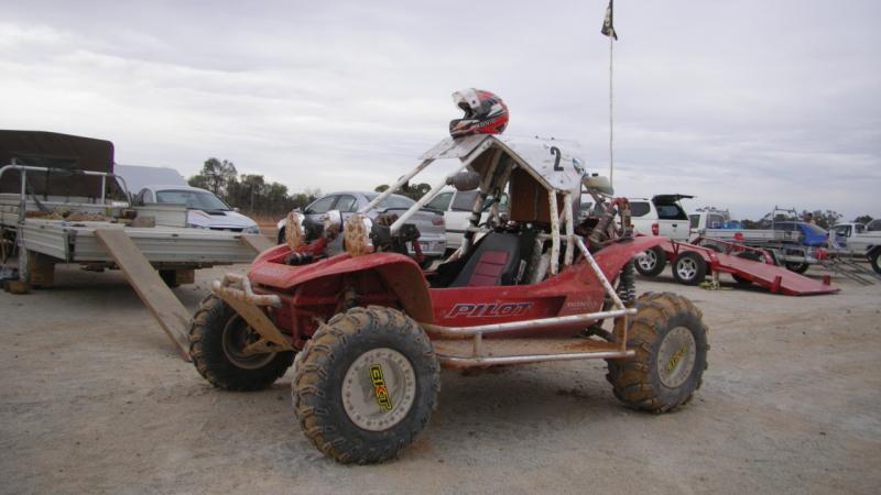

Well I went racing this Sat arvo at Northam Speedway,Downunder,and obviously had a ball.
Overall the FL800 went CRAZY,but steering was a major prob....basically I could'nt! :-)
The acceleration rate was awesome,but letdown by the mega understeer,everything I gained in the straighter bits I lost in the turning attempts.
The front just wanted to lift all the time,and made the understeer worse.
Trying to control(or dare I say drive this MoFo) :shock: was a fun but frustrating challenge.
Wayne you have made an awesome Pilot here,mega thanks Mate,just needs some changes/mods to suit the twisty,short track racing,Vs the wheely beasty you designed for.
I have'nt had so much fun or had Pilot wheely comments at the track EVER! :-) It was a hit!Take a bow Diablo! Image
Need to bias some power away from the rear to the front.
I'll be installing shorter shocks to lower the front,and swap front wheels maybe from the Drak-21-8-10 Vs 25-8-12 currently.
I can say conservatively that I was losing 1-2 secs per bend/turn,about 100yards per lap easy due to not being able to turn.
The rear brakes are now shot,in my last race was in the lead,when the rear LHS hand brake pulled all the way in on one of the back corners,had to wash off the speed by going wide and up/around the berm,barely made it.Persisted for another couple of laps,till I decided was just too dangerous,so pulled off onto the side of the straight about 50yards before the finish line.I thought I had another couple of laps to go,found out I was on the last of our finall 10 lapper slapper and only needed to coast to the finish line 50y away.What a !@#$% D' Head I am!!!!!!!!! :-) Hey don't agree so easily!
Need to do a CSI on the rear brakes,could'nt even lock them up ever,but need to for rear end steering.

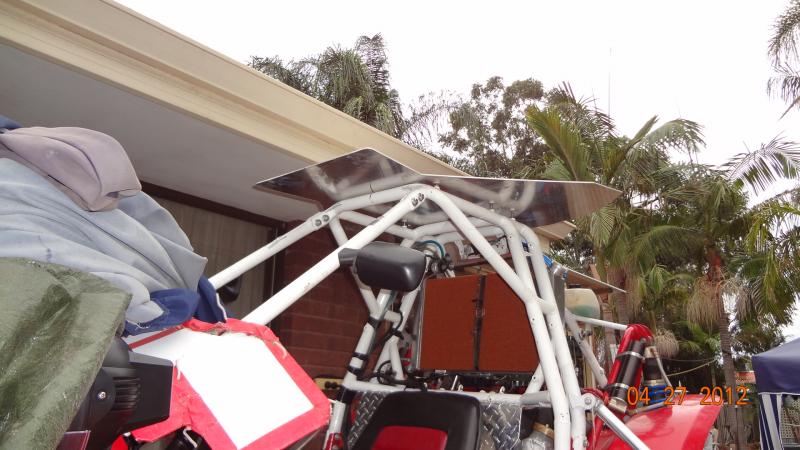

Anyway here's some pics of the skid lid,nerf floor,poly carb rim covers that I made up for the races,still need to do hood etc.
I'll post the race vids asap after uploading.

Ran into the same problem with my Pilot and its one of the reasons I have my 440 detuned rather than full out, I detuned mine by using a single 38mm carb and a 2 into 1 pipe, stock the Engine I used was suppose to be 85-92 HP 85 HP with dual pipes and dual 38mm carbs, 92 HP version was dual pipes and dual 40mm carbs
The 2 into 1 pipe I bought made 92 HP on the dyno on a more modern 440 Engine, I was told my setup should make a honest 75 HP
Not sure you want to detune that monster I bet its a blast other things I did to make my Pilot turn a lot better was to put more sag into my front shocks, they are also on the softer side when I turn my Pilot its so soft it leans like it needs a front stabilizer but that was the whole idea of setting up my shocks like this, when the Pilot leans it transfers more weight on the front outside tire and the Pilot turns like its on rails, I avoid bottoming out the front shocks because they are the FOX air shocks and I have the oil level set up where the spring rate rises real fast as the shock approaches the end of its travel, like to see guys with a spring over shock do this....
When I installed my shocks I made the upper mounts adjustable I currently have them set higher in the mount this lowers the front of the Pilot MOST guys like to raise the front of the Pilot higher in the front than the back, not sure why more bling homo crapola they think it looks cool? By keeping my front lower in the front I also give up a little ground clearance but more weight is naturally shifted to the front and my Pilot drives like its on rails, guys wonder how I blast through tight trails so fast :-)
don't get me wrong with this 440 many times I still have to let off the gas momentary to allow the weight to shift forward so I can steer.
Your on the right track try installing shorter front tires.
Can you add more sag to your front shocks?
If your not doing a bunch of big air jumps where the chances of nose diving is a issue try adding about 20 lbs weight to the front of your Pilot it will really help the steering, get a old pillow case or just use your wifes, put about 20 lbs of sand (weighs about the same as 30 cans of beer?) in it throw it in the front of the tub put your feet on top take it for a ride you will see what I mean.
I would love to have the power your Pilot makes in mine, not sure what I would do with it all but I bet its fun, had my 440 Pilot out yesterday in the grass doing power slides :-)

Hoser nailed it-"when the Pilot leans it transfers more weight on the front outside tire"-this is why the Briggs built cars are WIDER in the front than the back.
In no order...
You need more grip in the front and less in the rear to get the car to rotate better.
Anyone in your club have scales you can borrow?Try to get the weight more even front to back.(also as Hoser said)Probably not easy on a pilot.You definately don't have a power problem,add some weight!
Less agressive shorter rear tire?I don't see a problem with the front tire diameter,just the ride height.
With you in the car ready to go,front control arms should be almost parallel to the ground.
How about leaving the Engine and tuning with the clutches for power delivery?

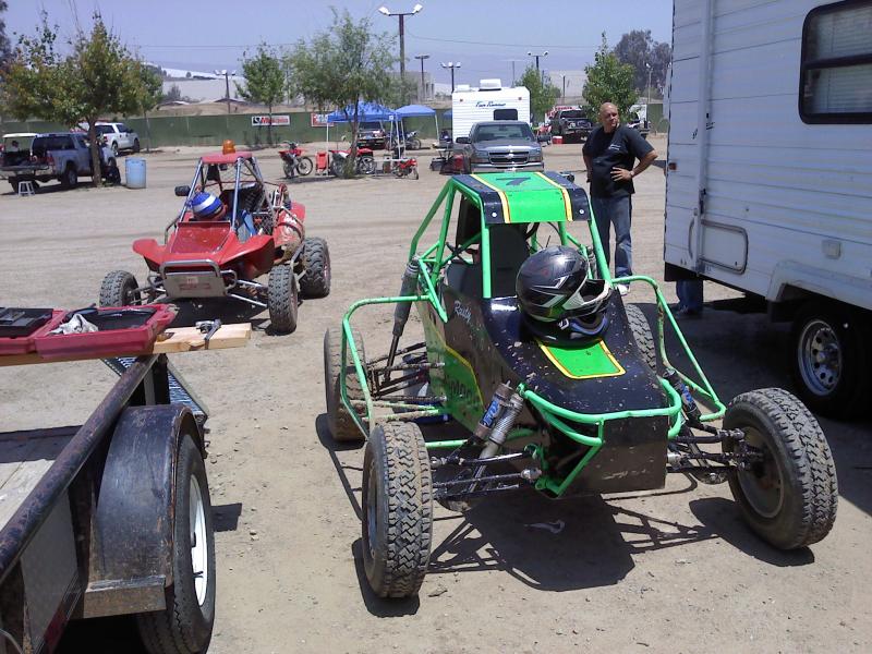

PostPosted: Sun Apr 29, 2012 12:01 pm
Take a look at the front arms(and everything else!) on Shoubadabas car.

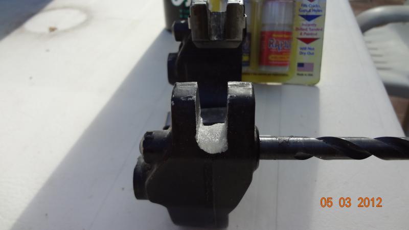

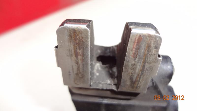

Took the rear Pilot caliper off this arvo for inspection,but prior to,also checked the yoke brake handle for travel and was back to firm?Must of got too hot?
Anyway,I removed the guide pin first whilst the caliper is anchored,the lil cover screw was a bitch!
Then removed the 2 caliper mount bolts,tried to jiggle it outa there,fought me the whole way,nearly gave up,then the lhs pad fell out,more jiggle,and the rhs fell out.
Only then was able to pull out the caliper.
They are both wasted,and showing uneven wear,both in alignment and L to R thickness.Common I suppose,always seems the same,guess it's the wear marks on the guide pin not providing the necessary even slide.
The parking brake adjuster bolt was also way out.
Was lucky to find in my blokes-shed a new pair of EBC FA111 Kevlar pads new,still in the package on my peg board.Totally forgot about em.BLISS! :-)
I'm hoping just a general service,new or slightly rotated pins for fresh shaft contact,will do the trick,also a fluid flush and refill.

When you over heat the brakes the fluid will boil creating a bubble of brake fluid in the caliper when you try to brake the master cylinder does not have enough volume to compress the bubble then the fluid and provide you with braking, once the brake system cools and the brake fluid cools it condenses back to a liquid that you can compress so your brakes go back to working normal.
Here is some pics that shows the common places the caliper wears out http://www.pilotodyssey.com/rearbrakes.htm Speedchaser has fixes for most of these problems . Follow the links in this thread viewtopic.php?t=4011
Few tips for you on the Pilot-Odyssey caliper, one the dust screw is usually a screw that has a slotted head no screwdriver really fits well and its a bitch to remove, before trying to remove take a small hammer and tap it a few times to shock the threads so they brake loose easier.
Once you get the dust screw out throw it away, take a old brake pad hanger pin that is worn out and cut it off close to the threads this is your NEW dust screw you can actually remove in the future and you need one less tool for working on the brakes.
Another tip is you don't have to replace the worn pin you can simply slightly and carefully grind a little off the taper part of the pin so when you tighten up the pin the worn part is now indexed and facing another direction that is not worn, grind a little then install it in the caliper with no pads see what way the worn out area is now facing....
Make sure you put never seize or a high temp grease on the threads so they will come out after 100 heat cycles and all the mud and dirt gets too them...
If that was my Pilot I would do two things, remove the Pilot caliper and save it for a spare or sell it to someone that needs one then I would buy and adapt a after market caliper that has more brake pad material than the Pilot does, IMO the rear pads don't have enough surface area for even a stock Pilot.
Another option I would look into is installing a second small caliper on the input shaft of the trans and have both calipers tied together so both are providing braking you would be splitting some of the load if the piston sizes are too different sized in the calipers you would have to use a proportioning valve between the calipers? Not sure how that would work...
Not sure about their but here their due to all the bikes wrecked here in the USA daily their is a ton of street bike calipers that sell cheap you could probably use one of them I would check on the cost of replacement pads before picking a caliper.... Try evilbay or local salvage yards

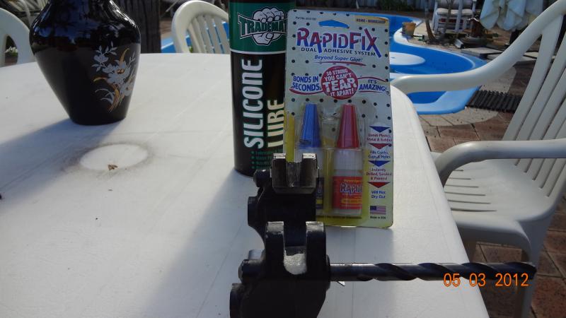

PostPosted: Thu May 03, 2012 7:51 am
Thanks Nick/Wayne.
Well here's today's update.
Worked on the rear caliper this morn before I went to work.
Was going to use Kneedit(2 part epoxy sausage type bonder) but remembered that still had some RapidFix.
This shit is good,easiest to work with as I suffer from dermatitis...it cracks me up! :shock:
I used an appropriate sized drill bit shank(pre-sprayed with release agent)into the caliper sliding/floating bore to hold the shape of the orig housing.
Dries rapidly! :shock: :-)
Then installed it all,used silicone tits,I mean grease on the sliding pins etc,then flushed out the ol fluid,and that's where it got interesting.
After removing the master cylinder cap,then the white plastic rectangular shape rubber gasket keeper,I found the anti-condensation rubber seal/bucket to be fully stretched all the way down?out! :shock:
I am sure this is due to the over-extension of the piston from the totally worn out pads,and dragging out/vaccuming the fluid and the rectangular rubber gasket thingy down..

Then I started on the front armour-gettin'.
Remembered I still had the ol white one I made years back,to use as a pattern/template.
This one will allow for the central Tacho,not sure how it's finish up yet till I gin around with it a bit more.

PostPosted: Sun May 06, 2012 7:36 am
More pics.This is the first prototype,will mod as I go along.
