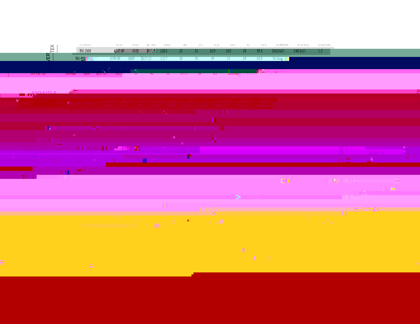

can you find a different rod ?
or over bore a stock rod to fit ?
look at a seadoo pwc 1997 650 the rod is very close with a 20 mm small end piston pin bearing is 20x25x22
SpeedChaser :-)

Good idea Speed, nice to have options. I had not thought about that...but I am still going to be short for a wide enough piston. There may be a few other big bore piston models(91.50mm???) but then I got to start watching for wrist pin to dome distance(deck height?). The whole thing was an experiment, air cooled jug so would not do well on long runs anyway. I was originally looking at milling down the CR500 jug. I still like the shorter rods rev over the longer rod trq...but that's just me. Again, thanks for the inputs!

What catalog are you getting those screen caps from ?
I will have to look I will post the whole thing if I can find it again
hot rods
http://www.hotrodsproducts.com/ProductSearch.aspx
use the request a catalog button its in pdf
http://www.pro-x.com/eng/default.htm?catalogue.htm~ProxMain
