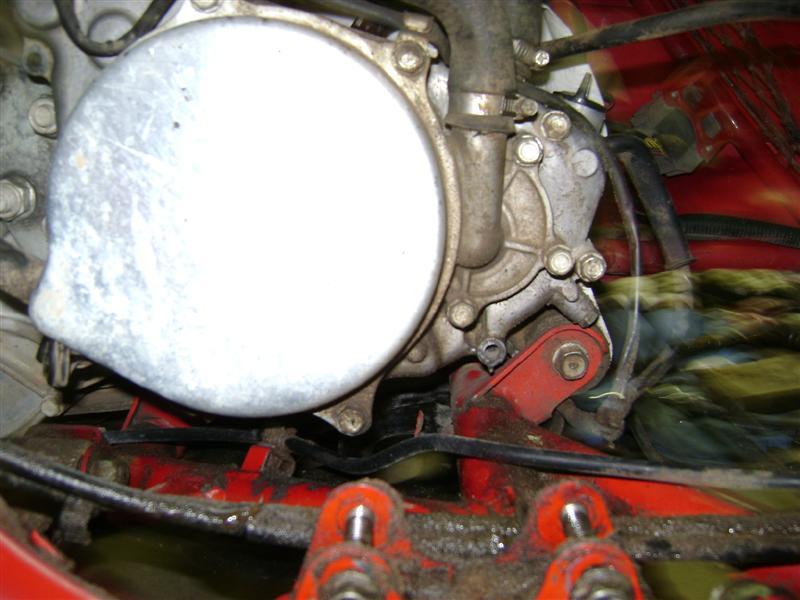

Removed the Engine today, see the missing bolts in side case, all the bolts on this side case were thumb tight I assume the missing vibrated out.

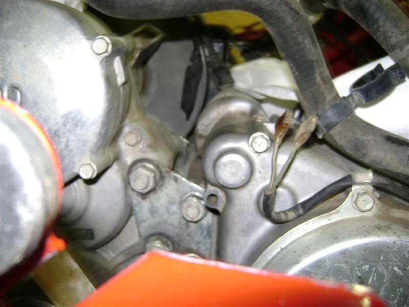

PostPosted: Wed Aug 13, 2008 6:44 pm

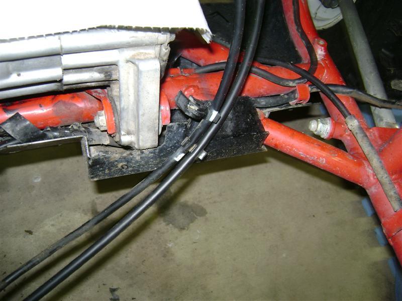

Wiring harness run wrong location

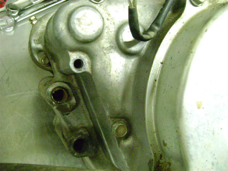

PostPosted: Wed Aug 13, 2008 6:45 pm

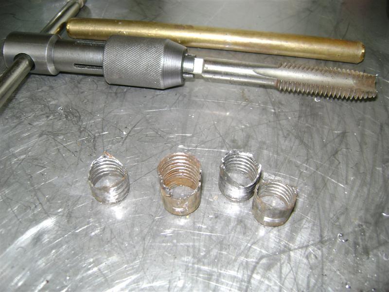

With all the Engine mount bolts loose all the dowel pins are broken

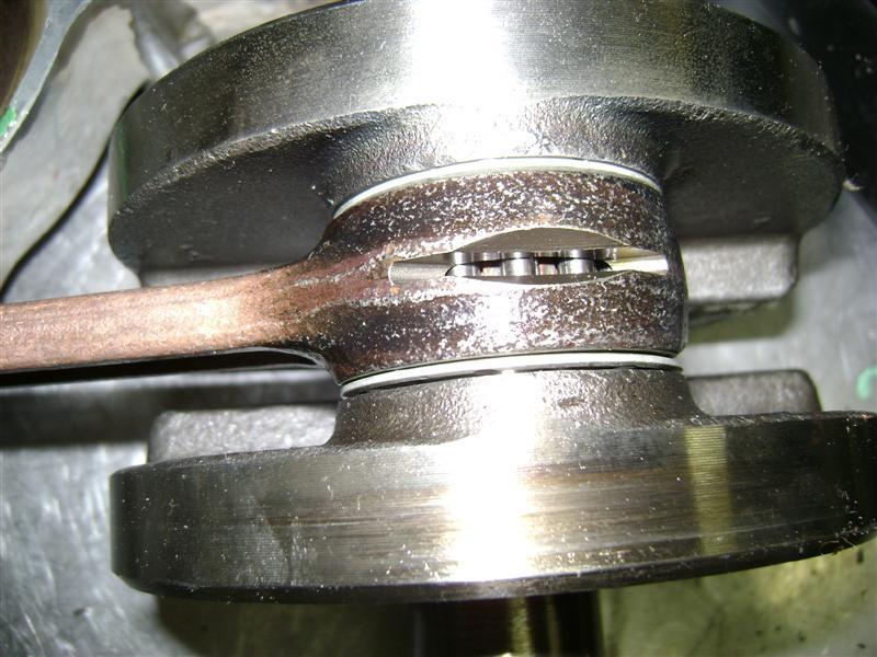

PostPosted: Wed Aug 13, 2008 6:47 pm

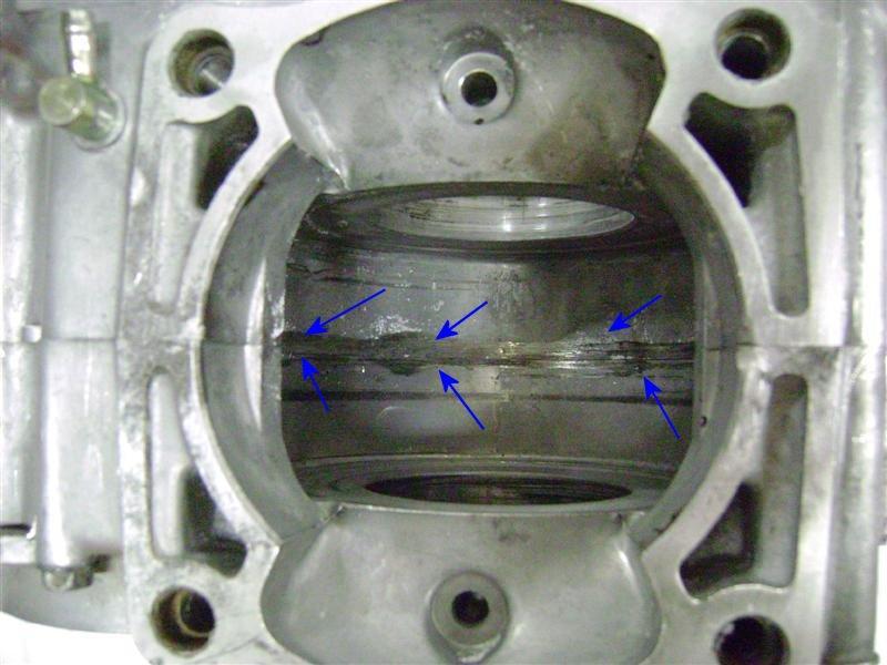

Crank cases split funky carbon around the bearings, crank looks rebuilt I assume the big end bearing failed and that's what damaged the cases.

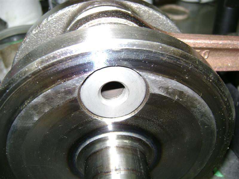

Both ends of the crank have the carbon crap on them but the crank looks rebuilt nice and tight.
PostPosted: Wed Aug 13, 2008 6:51 pm
Crank pin looks set to deep and not flush, I will measure the over all width of the crank to see if its right and check run out .

You can see where the big end of the rod made contact with the cases at one time.

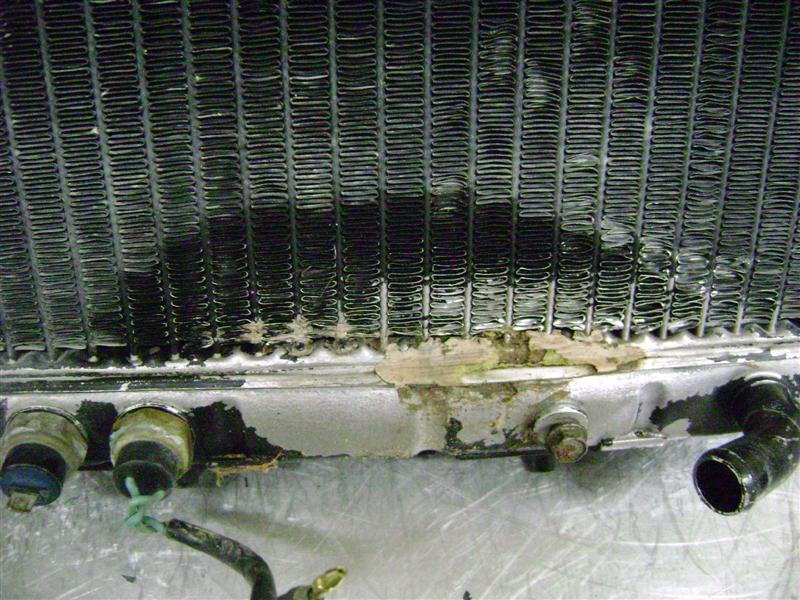

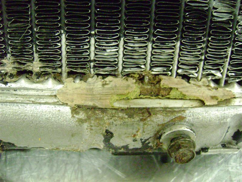

Onto the radiator, looks like someone had straight water in the radiator and it FROZE, it split the seam at the bottom, someone tried to patch with something that is no kidding like old bubble gum...

PostPosted: Thu Aug 14, 2008 3:33 pm
Bubble gum removed you can see the split, I would send this to Hares buddy to have it welded?
OR can any radiator shop weld aluminum radiators?
Let me know it needs sent out ASAP so we get it back right away.

Broken dowel pins removed what a PITA I had new dowels in stock so installed new in your Engine and trans...

Hi Hoser-rad shops can reweld that-I have had it done in the past.Do you have a local guy around by chance you can bring it too?-if not I will contact Hare via the chat and see if his guy can assist us.

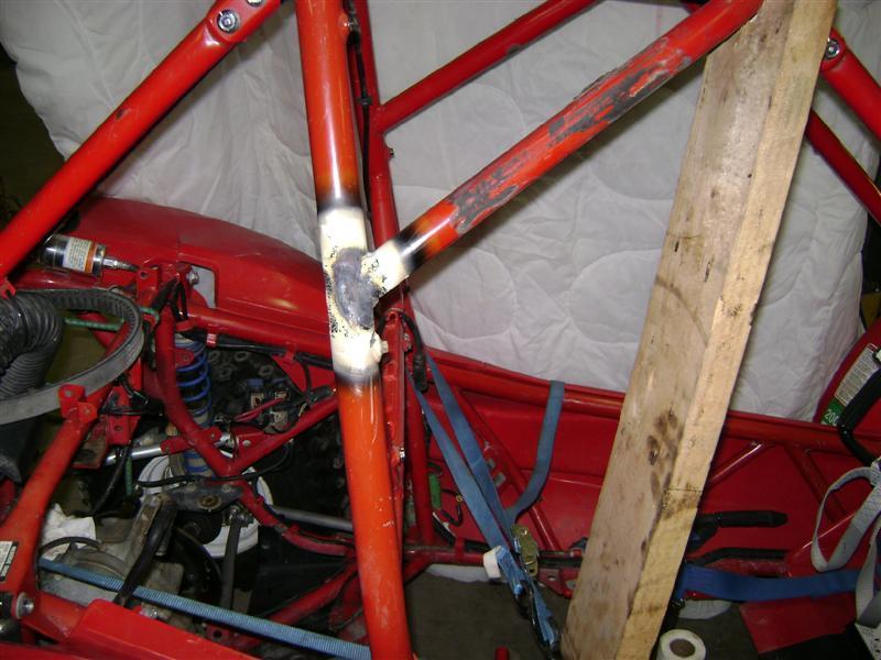

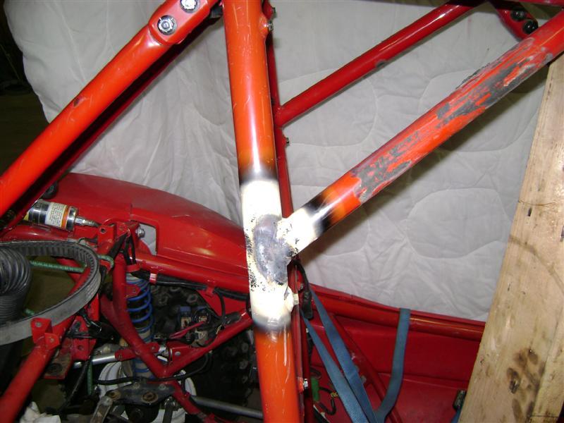

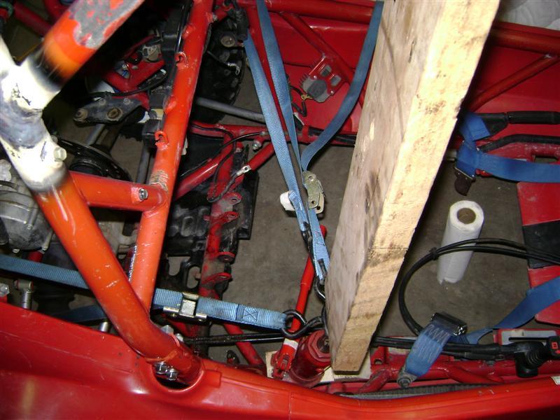

Straighten the cage today, lots of heat and a little jacking...

PostPosted: Fri Aug 15, 2008 7:44 pm
nice deal-looks alot better-the wood whats that used for Hoser?Does that support the upper roll cage bar from taking the load when bending?
PostPosted: Fri Aug 15, 2008 8:17 pm
Wood (2x6) has a jack under it that's how I pushed the cage back in shape, blue straps are to steady the jack .
