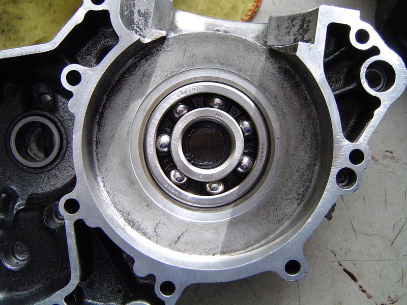

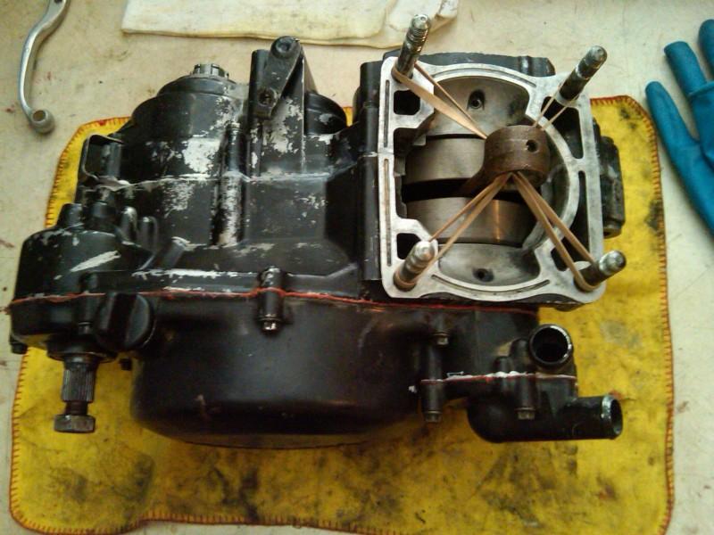

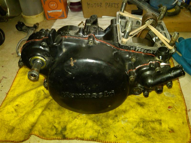

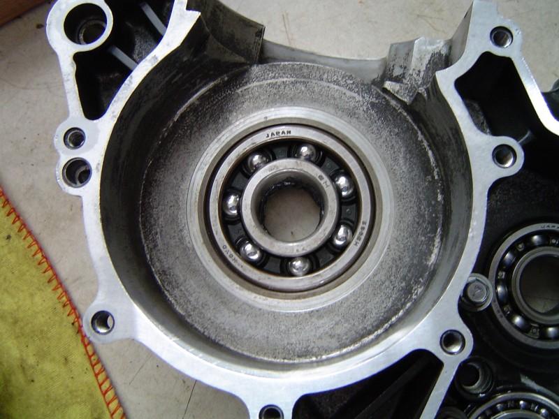

Got parts in for this,so I started on the bottom end yesterday.I lapped the case halfes, then washed them in soapy water and installed the crank seals and bearings in both halfes.Lapped the head, this took some time as it was not flat,I found using some water on the paper worked wonders to help the process.Heres some pictures.I will install the crank, and shfit drum, gear shafts, and the shifter into the right side today-heres some pictures.The side cases have had a bit of material worn off in areas from some MUTT using a "wiz wheel" air tool to take the gaskets off, so I might have to lapp these alittle more in areas to get them perfect.If you see something please let me know!!
The crank runout was at 0.01 so that's well within manufacturers specs( 0.02-0.10) and the side clearance as well spec's in under so it will be re-installed as well.I'll have the ring gap and piston to wall clearances posted here in a bit.I was wondering though-the parts are cold, should I take them inside and have them warm up a spell before checking the gaps/clearances?Will there be a difference it them?

File comment: new OEM bearings and seal installed, case lapped

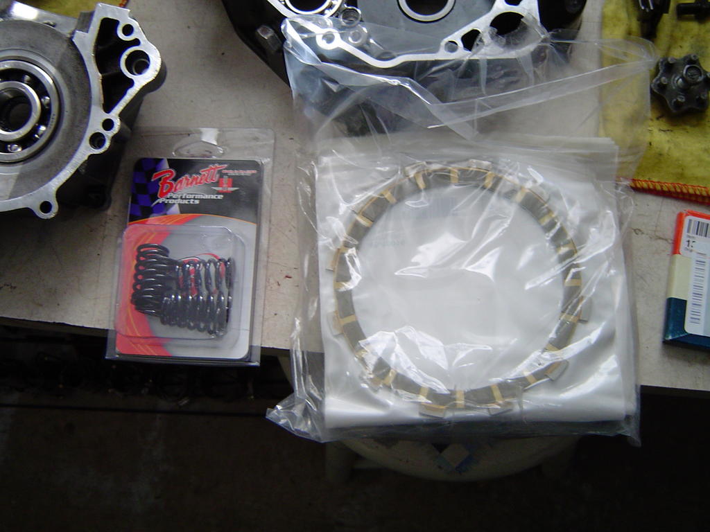

File comment: new EBC clutch pack

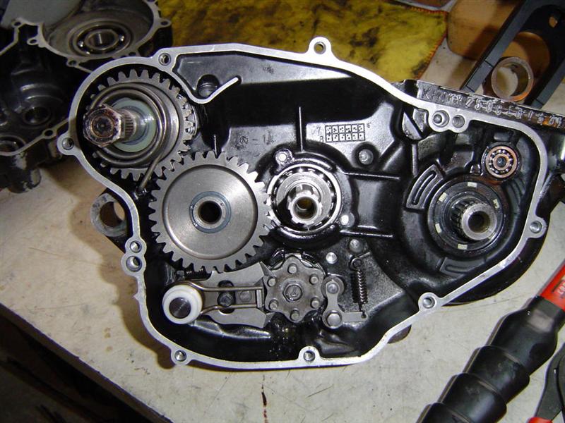

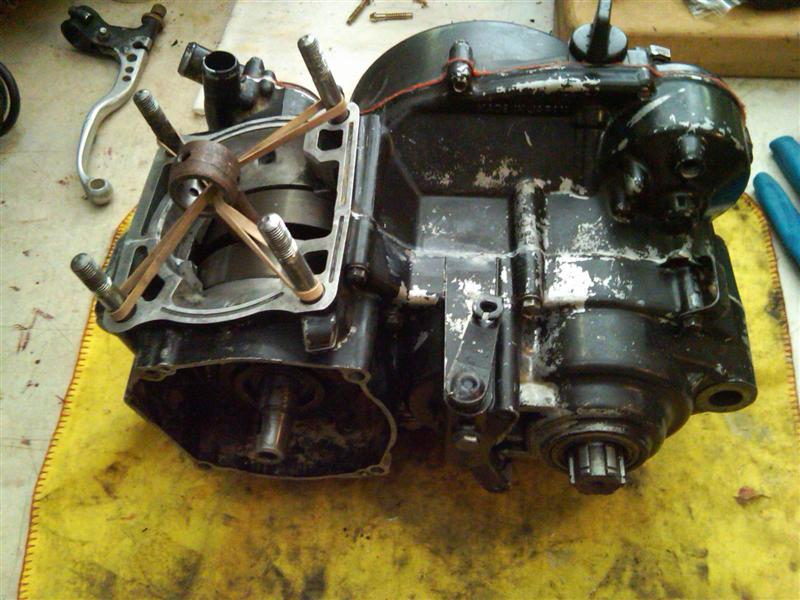

Got some work perfomred on it today-crank in,trans installed with hardware-kicker in with gears-here some pictures.
I measured the ring gap and piston-jug for clearances:
ring gap for both rings set just below the skirts 0.4mm (as per manual that's stock)
Jug top is 69.58mm
jug bottom is 69.82mm
Piston top is 69.55
Piston bottom 69.75mm
that's gives me 0.03 piston wall clearance on top and 0.07 on the bottom with the new OEM jug and Piston set.Standard as per manual is 0.049 - 0.059mm.

PostPosted: Sun Feb 14, 2010 2:45 pm
ring gap for both rings set just below the skirts .016mm
Jug top is 69.58mm
Piston top is 69.55
Recheck the bore taper I never seen a new OEM cylinder with taper like that

PostPosted: Sun Feb 14, 2010 4:41 pm
Any ideas on how I can check to insure the crank has gone all the way inot the bearings?It slid right in to the bearing with a very light coating of ANIT-SIEZE on it, but I am unsure if it is all the way.Any thoughts?

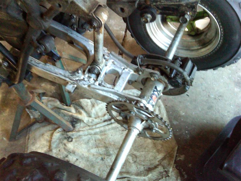

PostPosted: Sun Feb 21, 2010 4:50 pm

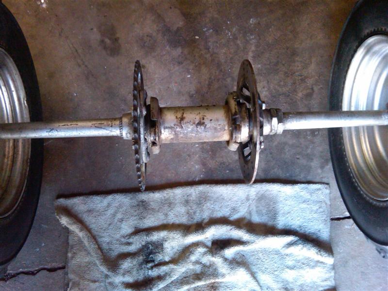

Installed new swinger bearings and seals, also the rear carrier bearings and seals too on the ride, the chain guide is scrap, and there were numerous broken bolts for the skid plate which I drilled and re-tapped on the swinger.It appears to me it has been welded in the front at some point-the tubes that accept the bearings look to me to be homemade,there's no stops on the inside for the bearings, that's weird to me, most of my other swingers have stops in them, I'll post some pictures when I get back home later.The rear carrier bearings are sealed 6007's

pics
File comment: Is it me or do these look to have been replaced, there's no stops inside the tubes for the bearing to seat on --
File comment: rear carrier mounted with new bearings, these are really easy to do on the tecates
File comment: Back on the trike and ready for a shock

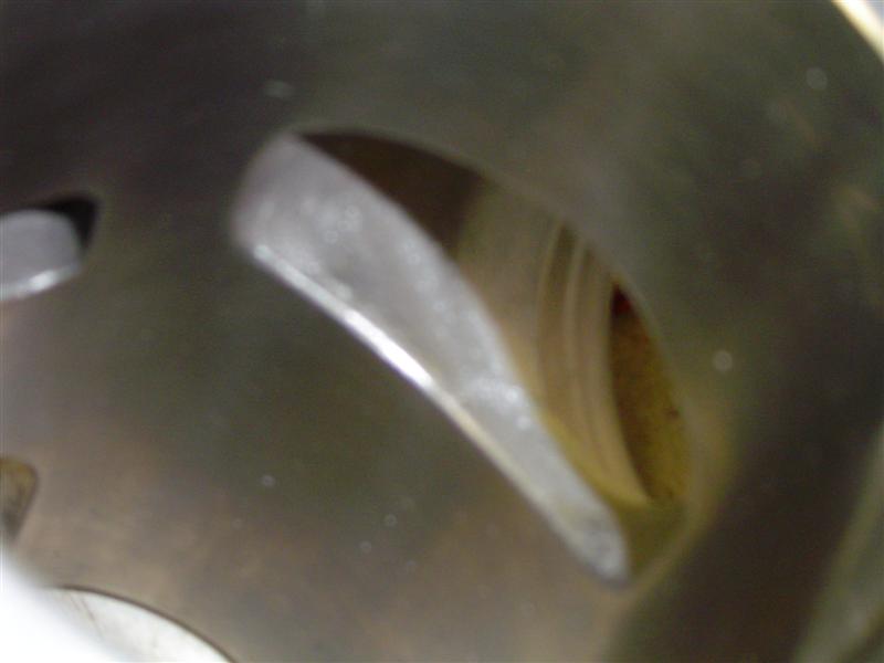

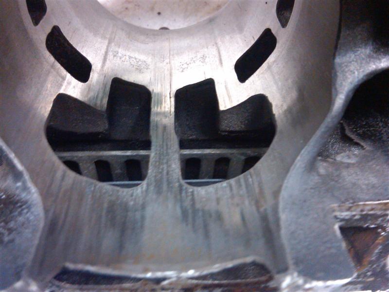

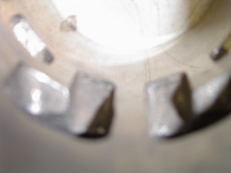

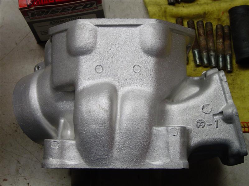

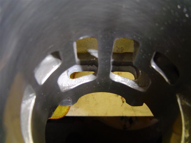

PostPosted: Fri Mar 05, 2010 8:26 pm

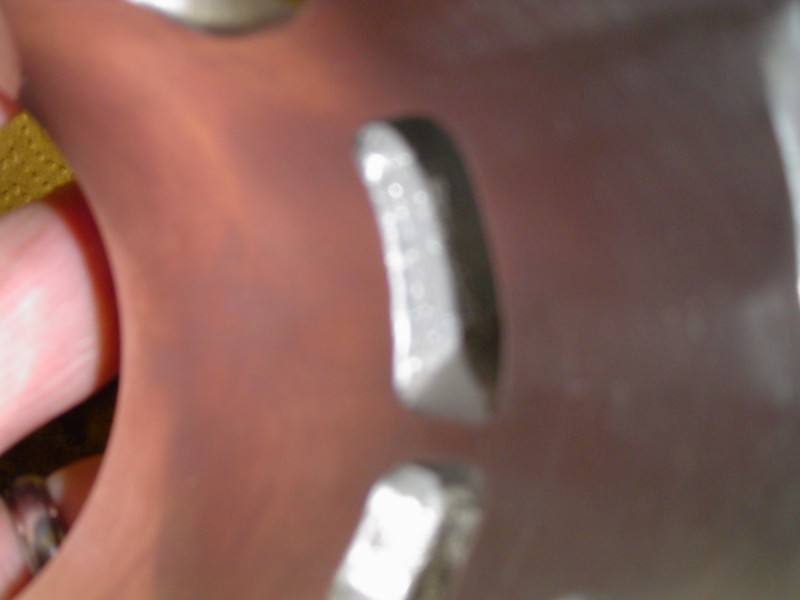

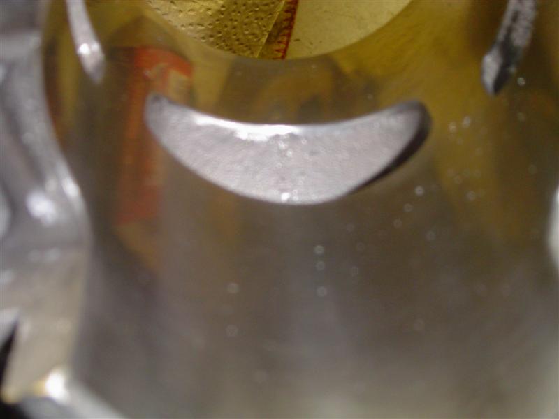

Got the cylinder back from US CHROME-here's some pictures for you.According to US CHROME the ports are not to be touched at all due to the plating.I also got a new intake which is made from a member on the 3 wheeler boards, the material is very durable poly rubber.
File comment: jug before re-plating

File comment: before re-replating
File comment: before pictures
File comment: after re-plating process
PostPosted: Fri Mar 05, 2010 8:30 pm

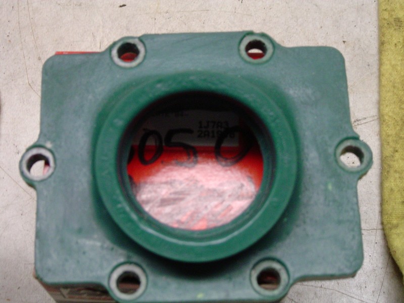

Ordered a RICKY STATOR flywheel and stator 80 watt today as well for the bottom end.

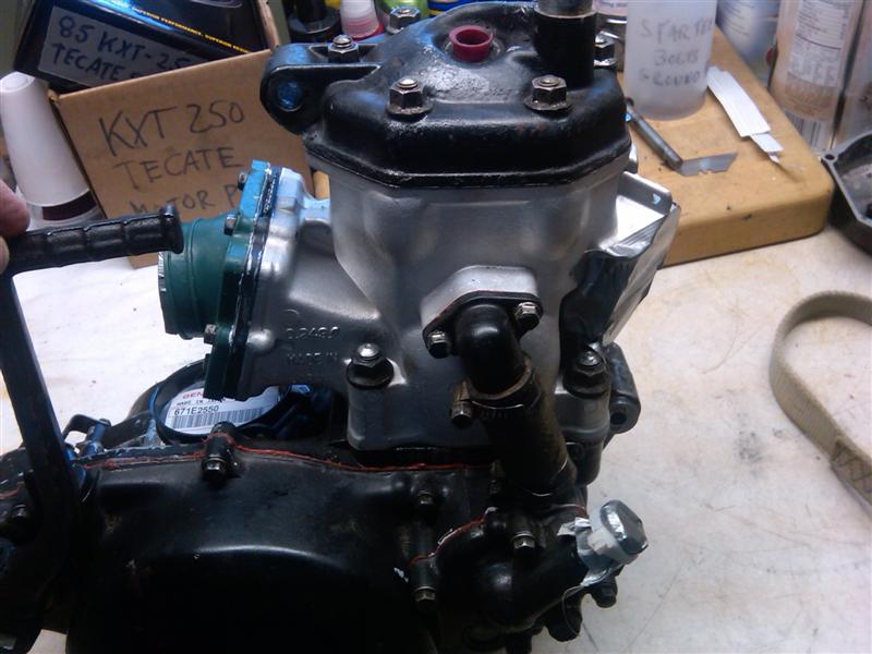

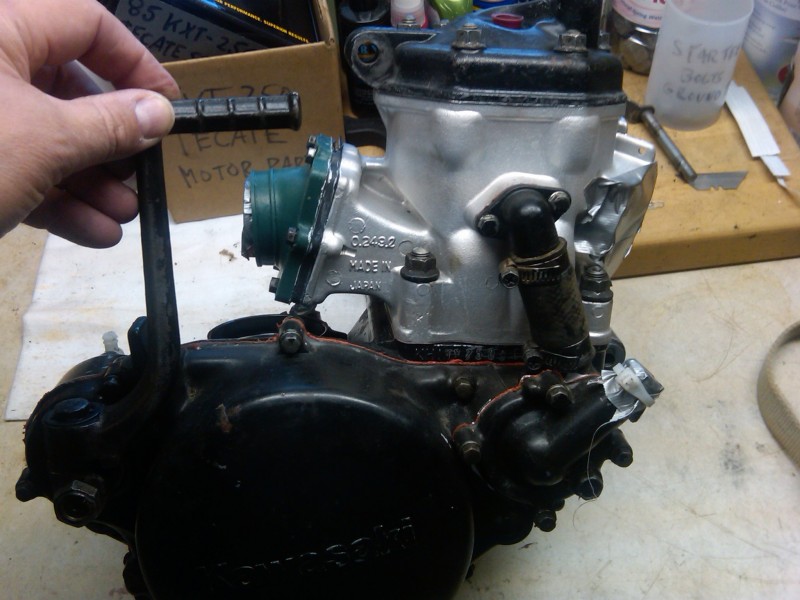

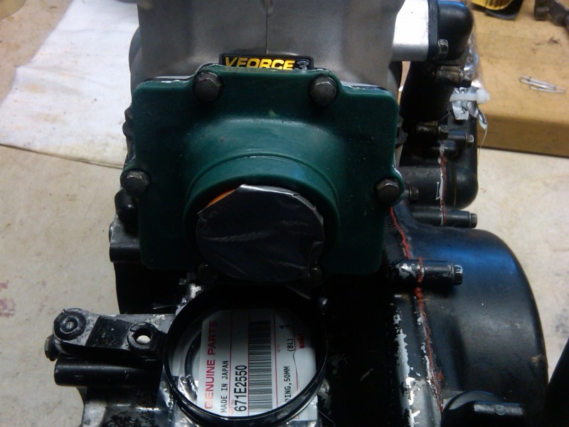

PostPosted: Sat Mar 06, 2010 2:39 pm
motor (( Internal Combustion Engine ? )) is completed, just need the stator and flywheel, which is on it's way.The piston was prepped as per Hosers tech pages: http://pilotodyssey.com/pistonprep.htm and new rings installed with all new OEM gaskets, torqued per manual specs and is ready for bolt in.Here's some pictures:
File comment: that's the intake the gentleman makes on the 3 wheeler boards, worked well.I will air leak test tomorrow, want to gasket to set up.
File comment: Jug from US CHROME installed with new wISECO 70MM PISTON,wirstpin, bearing,all new V-force 3 reeds with stuffer(that's stock)
File comment: kicker side
