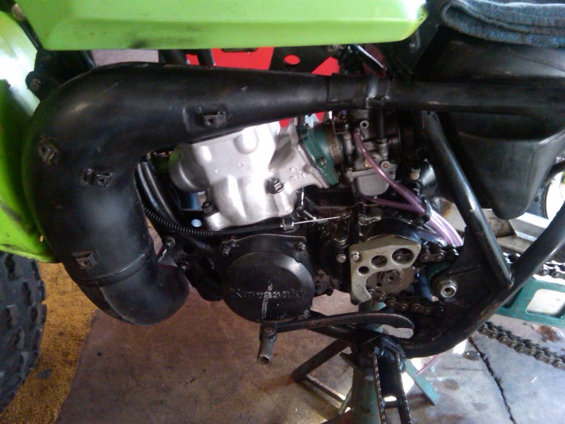

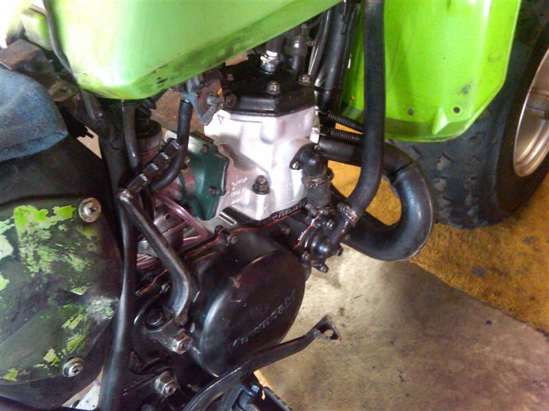

Finally got sometime today-so I installed the motor (( Internal Combustion Engine ? )).I was a little apprehensive as this is the first motor (( Internal Combustion Engine ? )) I have rebuilt in many years, and being it has gears, shafts, shift forks, etc I think 1 can understand my thoughts.The motor (( Internal Combustion Engine ? )) started right up, 1 kick it fired right up.I have to use the old exhaust as the new JEMCO exhaust I purchased for the ride is hand made, these guys are the only people that make them currently-and it takes 6 weeks min!I cannot ride it as I have the rear shock out for a rebuild, I was not going to tackle this but at the urging of Hoser I did, and I am glad I did.It is very interesting to do it, and it is pretty cut and dry.I am using the old stock Mikuni carb as the new VM 34 MM I bought off ebay does not have a stock "elbow" on the throat cap which I need,it was loading up pretty good at idle, I brought up the clip on the needle to the middle from the 4th groove, seemed to help a little.The main is a 200,slow jet I couldn't get e number off, it is a oval slide(stock).The exhaust where the expansion chamber meets the cylinder was spewing goo, I didn't change the gaskets or use silicone on it-so I will take it off and install it with the proper gaskets and see it that works.Here's some pictures of the motor (( Internal Combustion Engine ? )) and the rear shock, the oil that came out of it looked like swamp water, it was totally gray/silver and had no nitrogen in the rese at all.OH BTW, the shitty huge clamp on the intake is just there to get it running, I ordered a new OEM 1 and it did not come it yet.
File comment: motor (( Internal Combustion Engine ? )) installed,using the stock expansion chamber till the new pipe comes it
File comment: another view

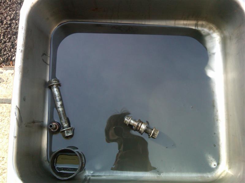

File comment: look at that oil, nasty huh?The seals were so shot, the oil was just leaking right out of the dust cap on the shaft.

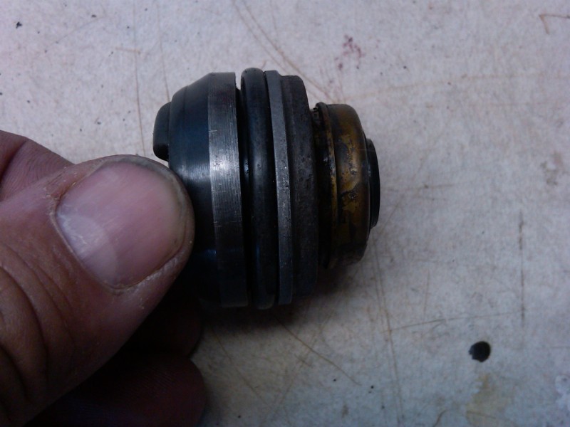

File comment: Plunger that is bad and need replacing,it is OEM

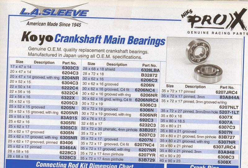

Was wondering where you got your Engine bearings? I am having a hard time finding crank bearings for my 440 kawasaki invader snowmobile motor (( Internal Combustion Engine ? )).
PostPosted: Thu Apr 15, 2010 4:35 pm
Whats the numbers on the bearings?
I was looking in one of my old LA sleeve catalogs and seen this.
PostPosted: Thu Apr 15, 2010 5:55 pm
there are several part numbers listed. the kawasaki numbers are:
Magneto side: 92045-3002 OR 6206-9RT-C4
PTO Side: 92045-507 OR 6207-9C4
I do not have dimensions for the bearings. If you follow this link and go to pgs 82-83 you can see the diagram and part numbers... http://www.vintagesnow.com/Kawasaki_fil ... nvader.pdf
