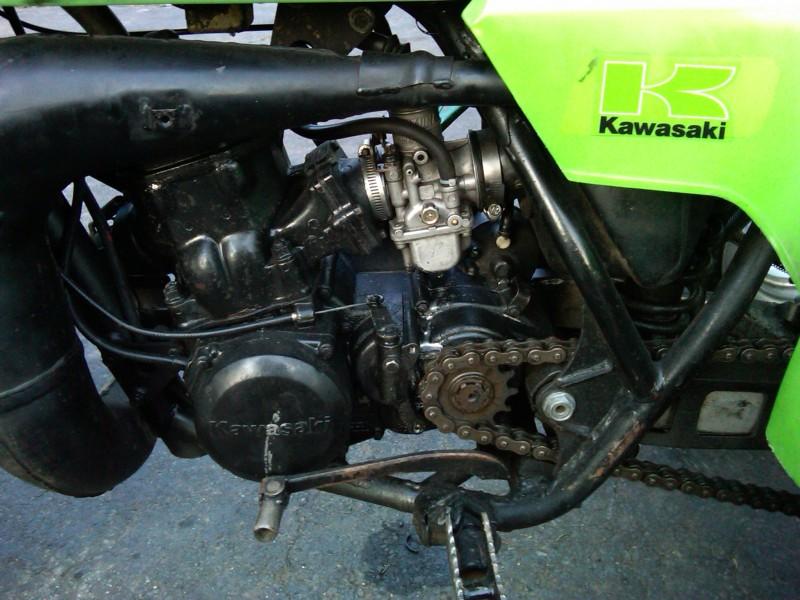

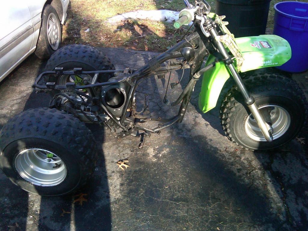

Recently purchased a used Kawasaki TECATE 3 wheeler, I always wanted one and the price was dam small, so I got it!!
I knew going in it was gonna have some issues, and it does for sure.The motor (( Internal Combustion Engine ? )) looks to be toast, top end is a nightmare, has some slight issues on the suspension as well, but the motor (( Internal Combustion Engine ? )) is the target currently.Here's some pictures for you, motor (( Internal Combustion Engine ? )) as well:
File comment: here it is when dropped off, does not look like this anymore!
File comment: motor (( Internal Combustion Engine ? )) pic,

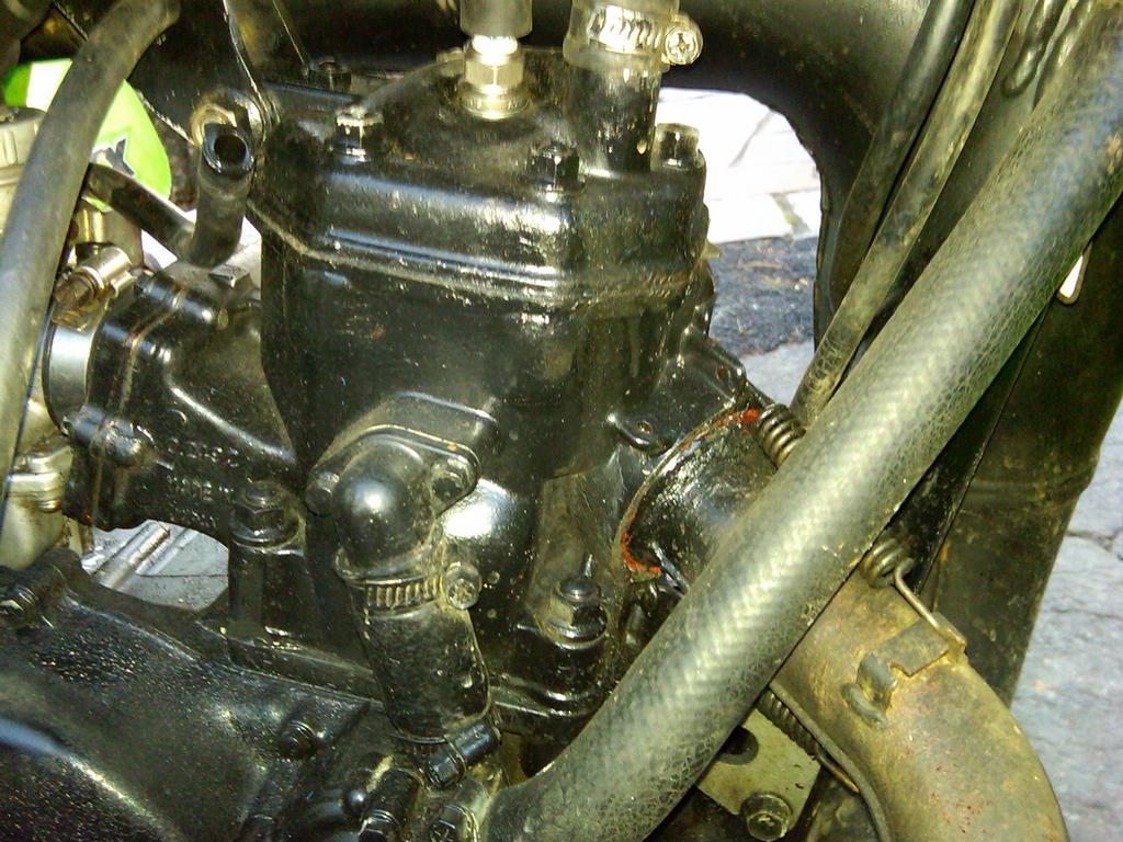

File comment: side shot

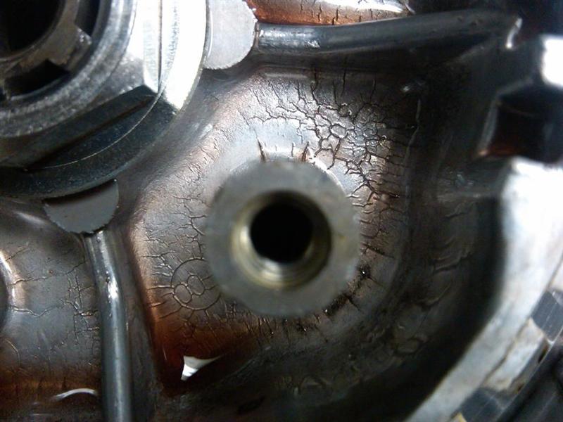

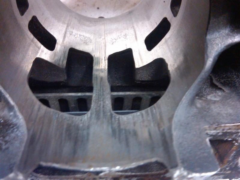

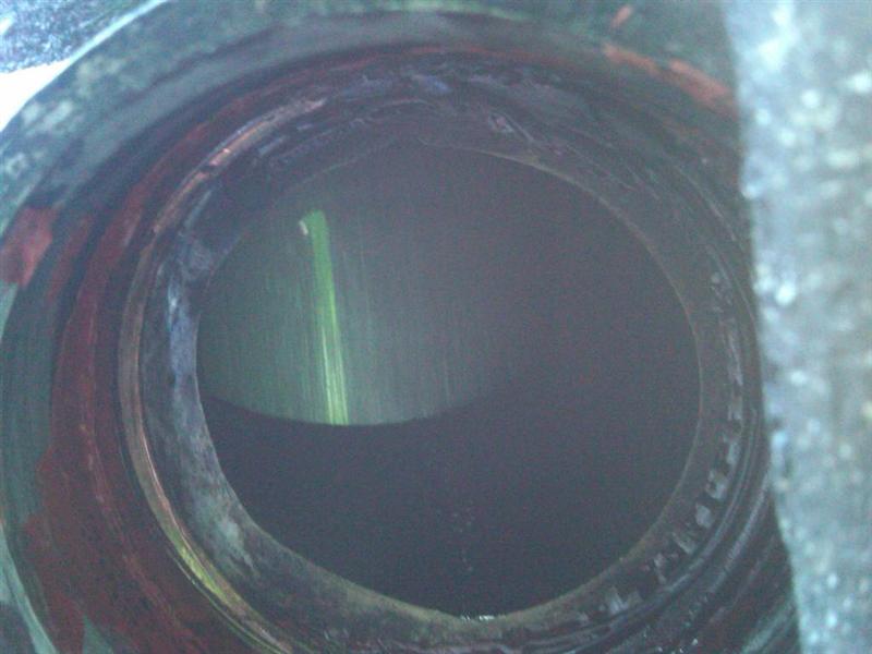

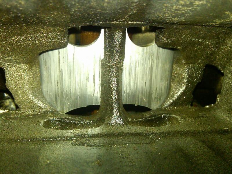

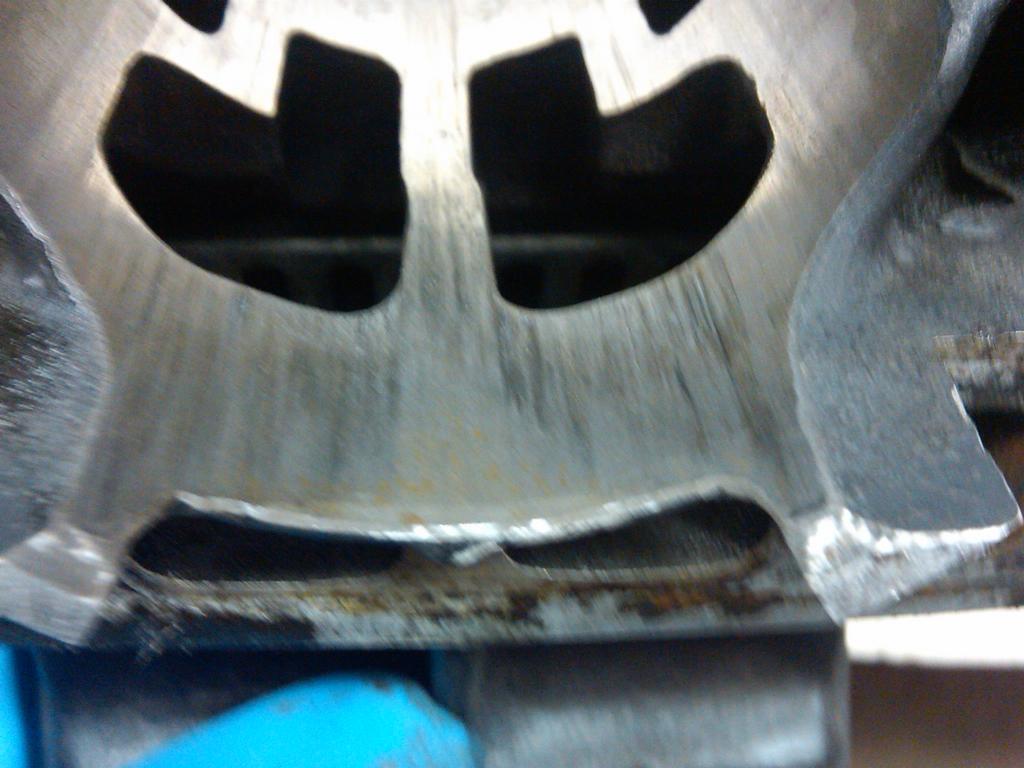

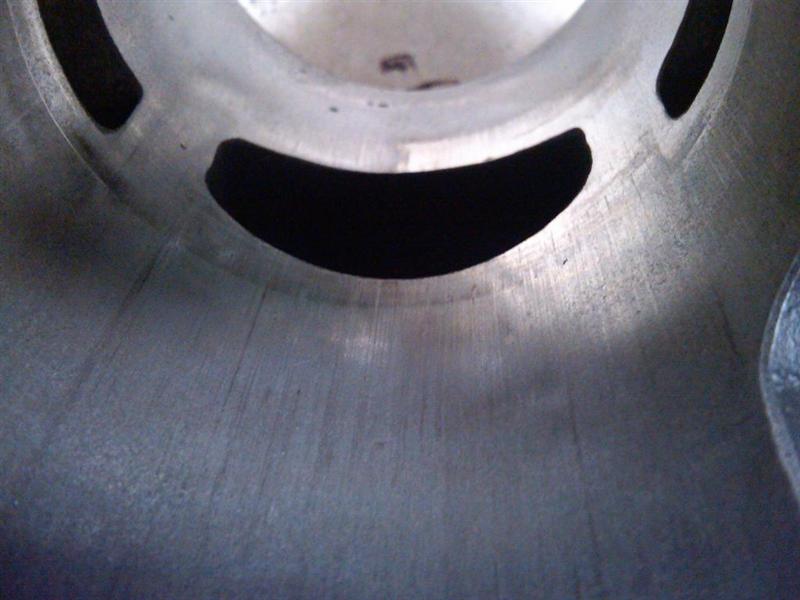

File comment: look at this carnage fellas?see the cracks in the bridge?how many?

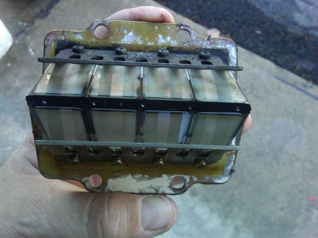

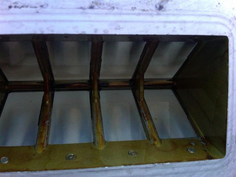

File comment: look at the pattern on the reeds,it is imprinted on the jug as well
File comment: see the imprint?

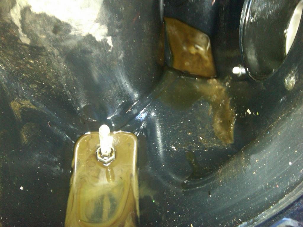

File comment: dunno if pic is good, but that is ATF fluid I drained from the case-YES ATF fluid!! no oil at all.

Isn't ATF tranny fluid. Sorry just being a smart _ _ _. Heck I have seen gear case oil in them as well.

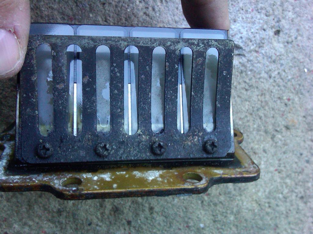

reeds look to me like they got moisture in them,and when I took the intake off there was no gaskets at all on either surfaces for that matter.I'll see if Hoser is interested in a CSI on this.I found a new jug but it is big bucks on Ebay-still looking for a jug.The reeds, silencer and pipe, etc are all obtainable still, axles, rear carriers, etc, shocks to in fact!!
PostPosted: Tue Jan 19, 2010 10:25 pm
It looked like trans oil to me on the reeds. Maybe why it had atf in her. finger the pipe and give her a wiff or lick if you dare. May also account for some of the ware on the piston skirt. Atf doesent seam to carbon up plug and ex port as bad on but is just as bad for the piston. Or the fuild could just be antifreeze from a blown haed gasket. The heads tend to warp. Another thing is the head stay. After bolting up the Engine if the bolt does not install with prying stop and solve.Seen a lot of 250 stuff that they pried the head stay bolt in and tore loose a stud. Any way have fun, Lucky man.
antifreeze came out clean, and the rad showed no signs of oil in it at all.

Got a new OEM jug off Ebay today-the old jug will be sent to US CHROME for replating -the bridge issue will be dealt with by them, it seems to be common problem with the jugs on these motors, the rep at US told me they have done hundreds of them-so we will see.I need a piston kit, new OEM head, crank bearings,gasket kit,and the rod will be dealt with too, that's gonna be up to whats found when a CSI is completed.

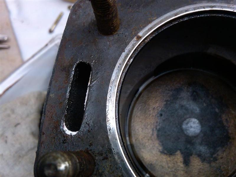

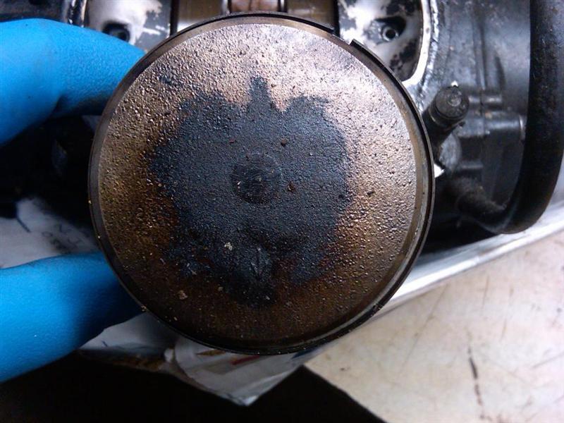

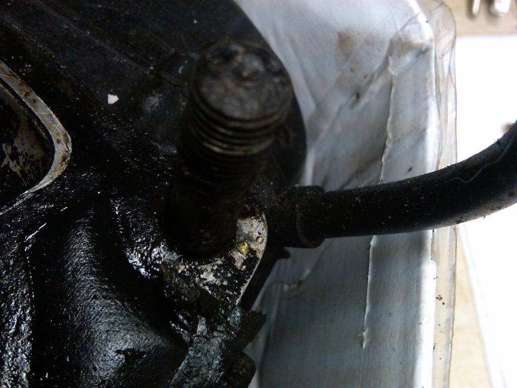

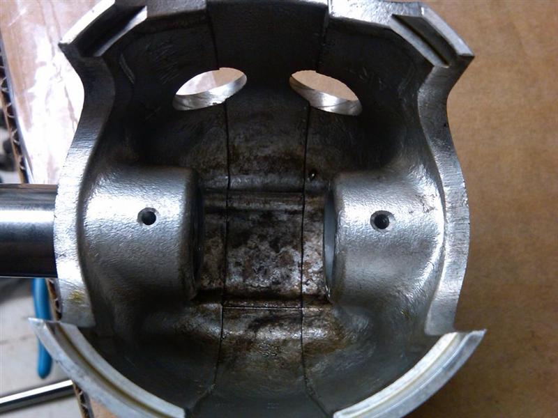

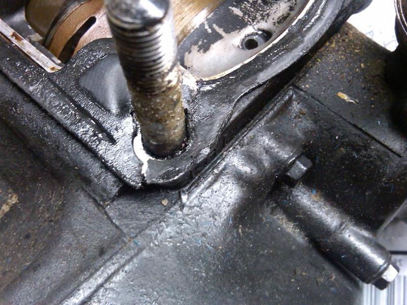

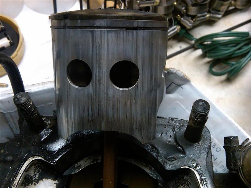

Went into the motor (( Internal Combustion Engine ? )) this morning, the head appears fine and the burn pattern on top pf the piston looks fine. As usual the aftermarket gaskets do not look as they line up perfectly on the top of the jug as most do not I'll take some pictures and post them later for you. The jug will be taken off today as well.
Well, after going into the motor (( Internal Combustion Engine ? )) tonight-got some measurements and some information.First, the jug bolts were hand tight-YUP hand tight!!!This thing must have had 1 hell of a air leak and sucking air badly for sure.The wristpin is seized in the piston, I had to tap it with a ball pean hammer to get it to slide over for removal.The COMETIC base gasket was never sealed, cut, and just a dam mess.Got some measurements off the internals:
Jug bore top: 69.74mm
Jug bottom: 69.85mm
Piston top: 69.67mm
Piston bottom: 69.87mm
rod top ID: 21.99mm
wristpin OD: 18.01mm
heres some pictures for you to view- http://s733.photobucket.com/albums/ww33 ... or%20pics/
The jug is not cracked as first discussed-the pictures show it is a casting flaw in the cylinder,but it still needs to be sent out for re-plating and a piston for sure.The bottom end was remarkably clean-I couldn't take the stator off as I don't have the correct puller-which sucked for sure.Please let me know what you think about the pictures.

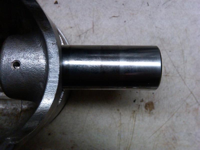

File comment: that was the most I could get the pin out without smashing it hard!!

Rod checks in within clearances service limit is 22.05mm I am at 21.99
end play is within clearances as well on bottom end of rod (side to side play).The rod seems tight-there's no side to side play, no discoloring on the rod at all,the clutch side case came off with no gunk in the cases.
