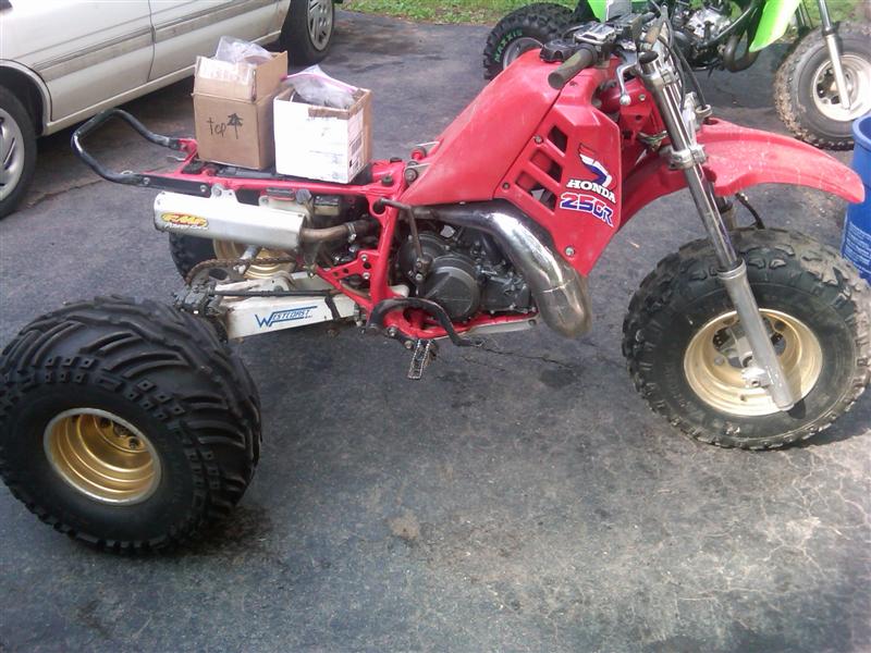

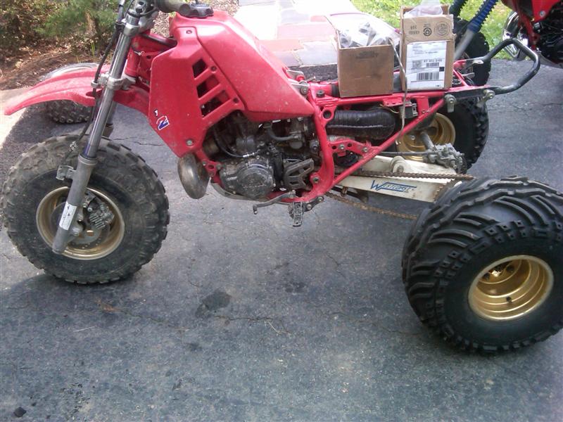

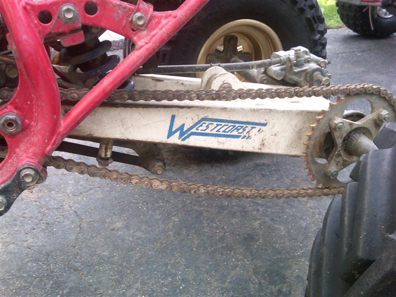

Just picked this 86 250r ATC up from Mike's place today-big thanks to Stoneman for lining this ride up for me.It has a spare motor (( Internal Combustion Engine ? )) that is totally wiped out but the extras alone on the rear suspension make up for it.The swinger, axle, rear shock alone are worth the purchase price. I installed the rear tires and rims as the ones that came with it were a joke-the plastics are all going to be replaced-the rear carrier bearings are shot, motor (( Internal Combustion Engine ? )) won't run currently-looks like the coil has issues.It is missing the front headlight totally,but I can rehab this thing just fine.Carb, reed cage all look stock.Here is some pictures:
File comment: plastics were totaled,I took seat off and threw them out as soon as I got home!
File comment: motor (( Internal Combustion Engine ? )) does not run currently, might need a plug or coil, checked it out alittle bit yesterday-need a comp check today.
File comment: west coast extended swinger, these things are hard to find!
File comment: pipe is a Paul turner atc type 6 one of the best for my riding style
File comment: rear view, carrier is stock, need to replace with a RAD or double row carrier in there.

Nice score Greg. :-)
The rear sprocket and chain look toast tho.Look at the wear on those teeth.
Like waves curlin' in before they shore/ break! ...Baz

oh for sure, it will all be replaced-I started the ROCKY MTN order last night!

Oh yes-I got spares for most of the ignition parts, so it will be replaced or I'll ohm test it with the meter.I got plastics from another machine(WIGGINS RIDE) that will be installed and I'll get new for his ride-chain, sprockets, etc all new.The motor (( Internal Combustion Engine ? )) is gonna be CSI'D to see if it gone or not ASAP, or as soon as the TECATE is jetted right.
Nothing wrong with that set , they are only half way through their life :shock:
Just turn them around and go again :-)
