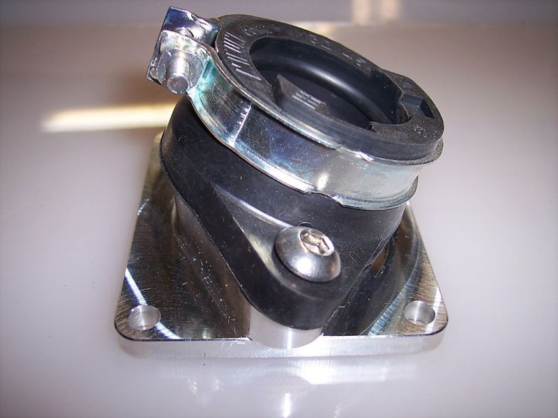

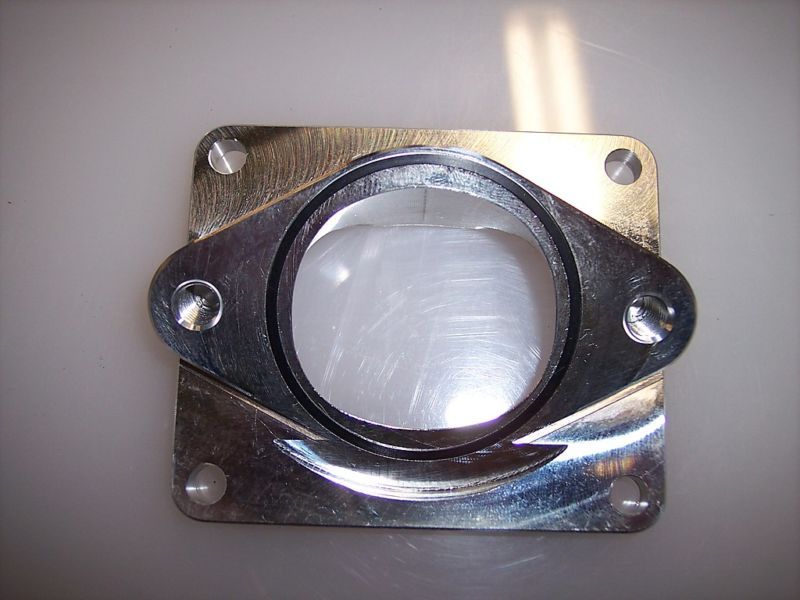

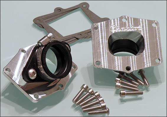

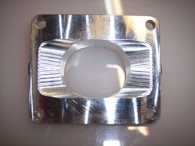

Below are just pictures of other manifolds I grabbed off the web to show what could be fabricated they are for other applications.
