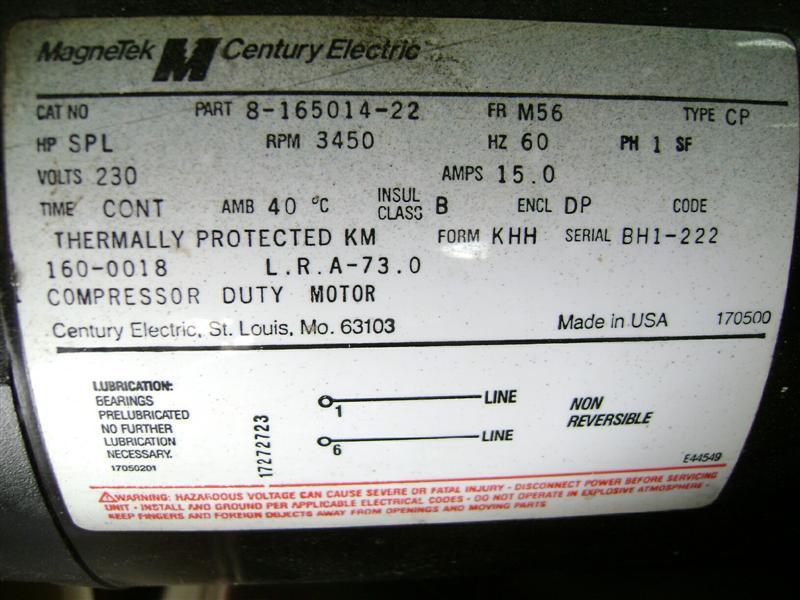

I attached a picture of the data plate off the motor (( Internal Combustion Engine ? )) itself.

Magnatek is still in business the last I knew. They are concentrating on generators now. Single phase motors are usually a throw away item as the labor and basic parts cost more than a replacement one. Try grainger or mcmaster carr for replacement motors? They are both industrial supply houses.

I am going to give a call to a local motor (( Internal Combustion Engine ? )) re-builder and see what they say years ago rule of thumb was anything 5hp an more was about 50% cheaper to rebuild, I see burned windings inside so much for their protection lol it did trip the over load on the motor (( Internal Combustion Engine ? )) and not the breaker, yeah if I gotta order it will probably be grainger or mcmaster carr hopefully I can get local and save on the shipping charges.

http://www.grainger.com/Grainger/items/1ATA9?Pid=search 300 bones
http://secure2.data-comm.com/servlet/RB ... sor/Detail $270 bones
you my want to watch shaft size
your tag is showing a frame size of a M56 ?
don't know what the M stands for
need to look in my book at shop

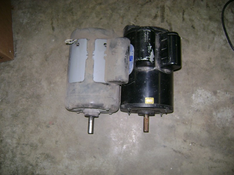

FIXED!!
Thanks to bullnerd who sent me a used compressor motor (( Internal Combustion Engine ? )) he had its now back to working again.
When I started this post I figured my chances of finding one here was slim to none WRONG glad I asked.
Thanks again bullnerd :-)
File comment: Great packing

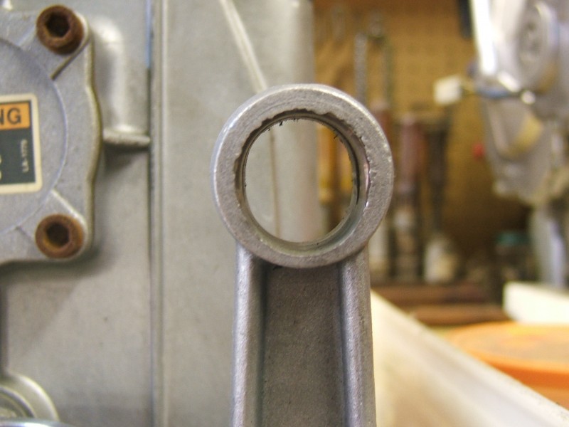

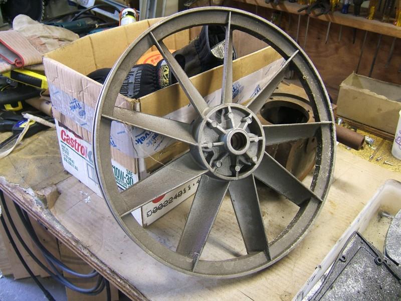

Glad i could help.Heres the rest of the compressor,bad small bushing on small piston rod, but everthing else is there.You cant get this stuff from sears/craftsmen any more so if you see something you can use let me know.There is also a balance tube not in the pics.
