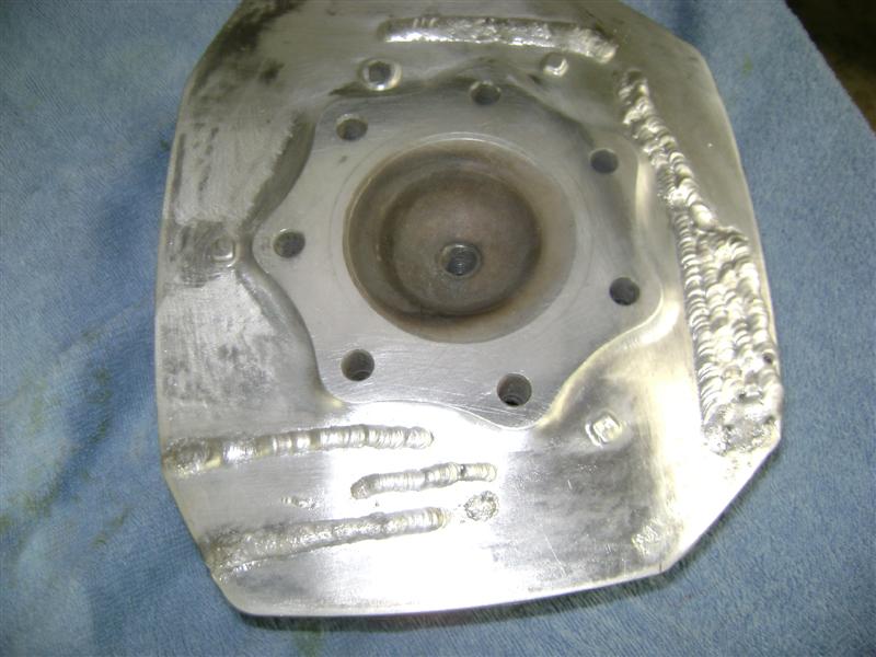

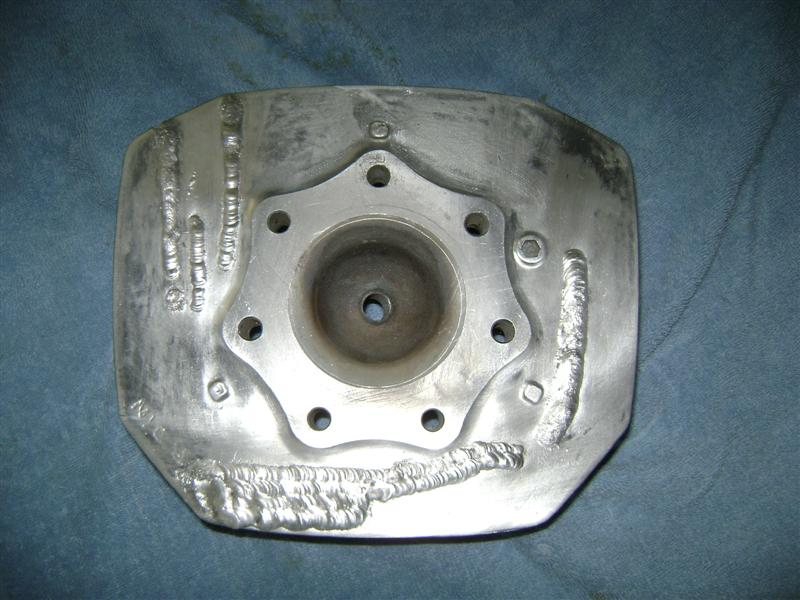

Git some filler rod from the weld shop and some metal from the local recycle place did a little playing with the welder.

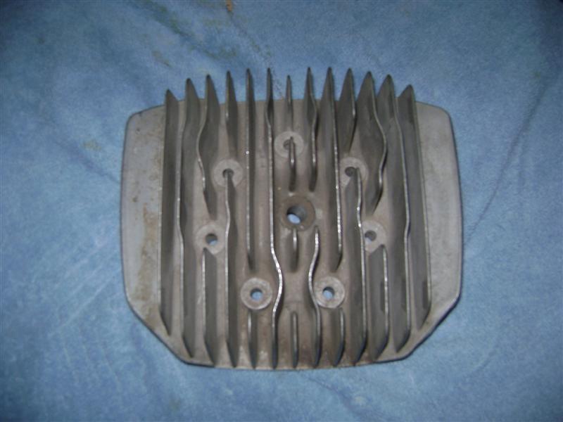

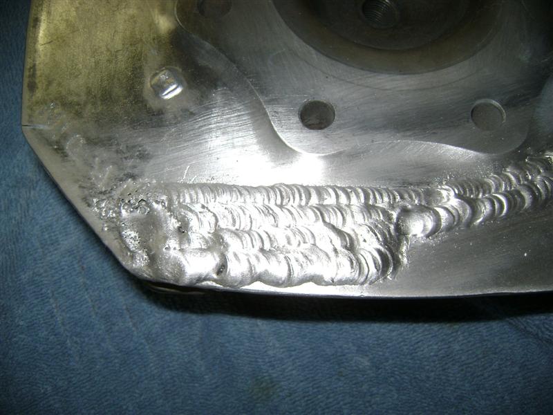

Took a old pre recall FL350 head with the straight fins and did a basic cleaning to practice on, just used sand paper to clean the surface then a stainless wire brush had a lot of porosity in the weld.
Will try sand blasting the casting tomorrow if its not raining then try some more welds see if that cleaning makes it better.

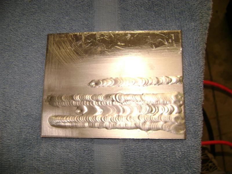

Then just ran some beads on a piece of new plate.

PostPosted: Mon Aug 13, 2012 7:02 pm
Posts: 550
Remember when tig welding aluminum, CLEAN CLEAN CLEAN CLEAN and be sure to remove the milscale off of steel, if you don't chances are it will "POP" and cover your tungston. Mild steel can be very messy to tig, just when you think you have the Bad Azz bead going that you will be super proud of, "POP" and you have a hole in your bead and your tungston is twice the size LOL happend to me last night making a cool looking tool to remove the cv LOL 95 percent welded then BANG, a hole big enough to put a pencil lead into LOL Have fun hoser
