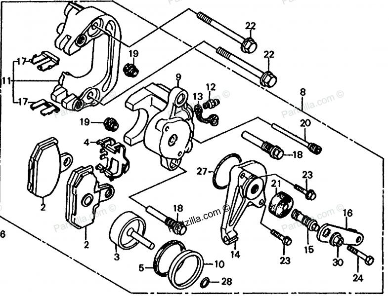

Number 28 ?
PostPosted: Thu Sep 19, 2013 6:30 pm
28 is 91358-964-006 O-RING (7.8X1.9) still shows available but the size is (7.8X1.9)

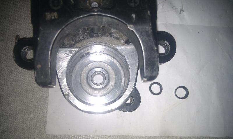

I have the o-ring part # 28 but mine had a small flat rubber ring on top. There is a post from 04/22/2006 from member wyeeeoddy with a picture of part # 28 and the keeper. I need the keeper for the o-ring. I may be wrong but do you need this keeper or will just part # 28 do the trick. my caliper has been cleaned out really good using scribes for all the grooves which were filled up with junk. I put all new seals in it and when I bleed the brakes it leaks still. I know you have a tons of knowledge and experience with these machines so any advice will be greatly appreciated. I used to talk with Randy alot. I could usually fix everything with his help but unfornately he is not able to help.

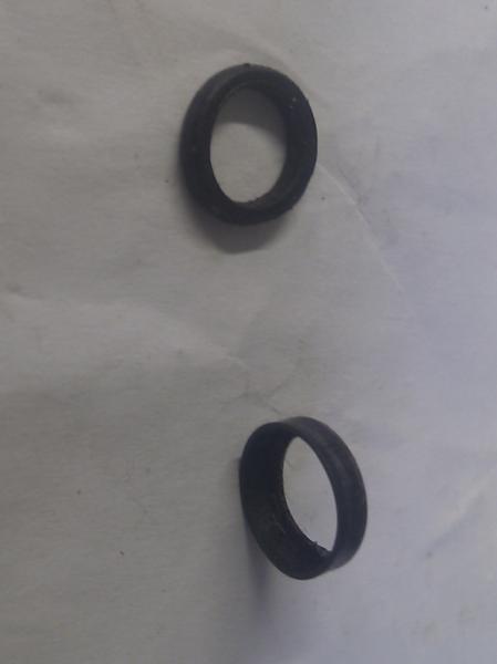

I have tried to chase down the metal Ring that is a press fit that holds the O ring Part #28 in place with out it the O ring
move back up the brake piston arm. I ended up using a Key ring coil it was a push in fit but it works
in the pic the top is the O ring and the bottom is the keeper. The keeper is very soft and must be put in square
I had trouble with both my Calipers after their rebuild leaking around the piston, but i found once the new seals had been used
and abused the leaks stopped
