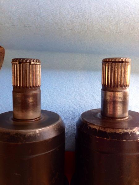

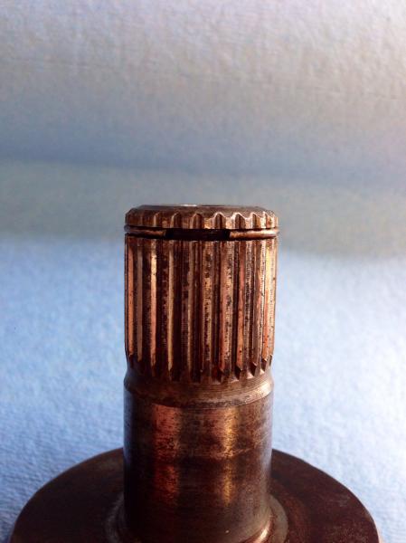

Here are some pics I found. I think one cv cup is an 89 and the other is a 90.
File comment: Left side is the 90 cup and right side is an 89 cup
File comment: 90 cup
File comment: 89 cup
PostPosted: Tue Dec 30, 2014 8:11 pm
I looked at my green painted axles on the shelf and the groove is in the same place as the black painted axle I have.
I do recall the cir-clip diameter changing based in VIN not Year. I'm pretty sure I have a printed document about it some place, but I can not find it.

Dave, here are some other pics I found when I did the long travel on my 89 pilot. I also have a 90 pilot that has the green cv cups and another 90 that has black cv cups. I thought my 90 that has the black cups must have had the green cv cups swapped out at some point, but not too sure?
