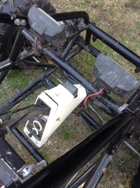

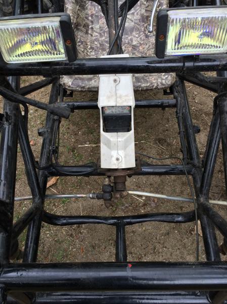

Here are a few pictures have some more. Just wish I could upload a group at once and not have to select one at a time

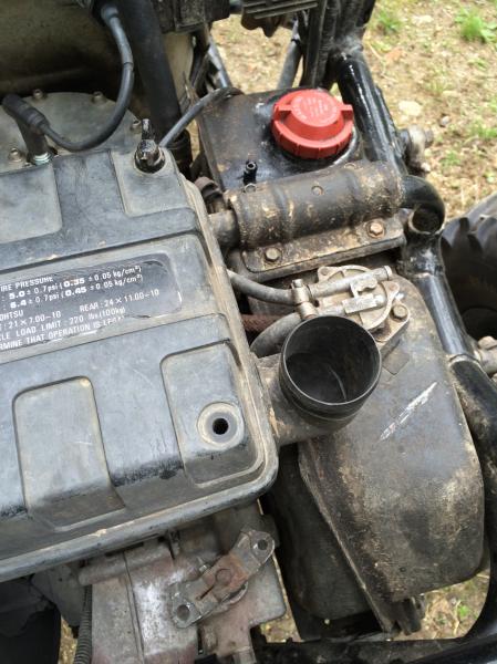

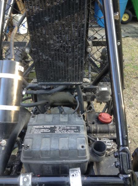

So I bought this thing for $800 the other day from someone who bought it off another guy who worked at an auto zone. Well the guy from autozone I was told fixed things for hobby. Well screws in the wrong place, lost parts, sheared off pieces etc. The owner prior to me I don't think knew how to mix oil and gas as it has oil from the head to the end of the fmf can which is like wet paint. It runs, it drives, it doesn't smoke much surprisingly. But it is missing its shift lever, plastics, floor pan, some skid plates, snorkel, the high brake light, a bolt for the airbox, its starter I guess didn't work so it was detached? The front light's electrical was cut off. there is some of that black plastic coating the wires go in that is shaved but no wires are shaved surprisingly. Draining the fuel tomorrow, and I am going to try and put the exhaust back on as I think one bolt sheared off in the Engine...... It will need tirod ends innner and outer, and I will need to check the rest of the things. (will need help on how to find out if the rest of the bearings are good or bad) I just want to get it to working order so I can ride it a bit this summer but do a total over haul this winter. Plastics are least of the concerns as I work at a metal shop I can have some stuf fabricated, painted then bolted on. Not welding things on just in case I choose to go factory with this. Also looking into a suspension kit to lift it a bit but $2000 is a bit much for something I'll be using as a toy and not a race machine. I think it was on this forum someone made bolt on suspension to lift it up. Not sure though

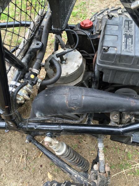

PostPosted: Sat May 16, 2015 6:46 pm

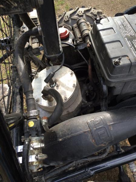

As far as the radiator goes, you can use a Yamaha Banshee radiator or a YFZ 400 radiator from a quad. There are others that will work but as usually over sized for just running a water cooled head. Too large of a radiator will not allow the head to warm up properly.
Your head is a Rand's Manufacturing head.
Your radiator appears to be a Banshee radiator.
You water pump is a Mercedes Benz auxiliary heater pump.
What type and model number is that fuel cap? Do you know if it leaks?

PostPosted: Sun May 17, 2015 12:35 pm
The Rand head (no affiliation to myself) is a good head and will cool well.
If the Mercedes Benz water pump isn't rattling or making racket when it's running, it should be fine.
If you don't want to use the water pump, you can change your cooling setup to a thermosiphon system if you use a vertical radiator such as a Banshee radiator like the one you have now. With a thermosiphon system, the heated water will rise to the top of the radiator and in the process of cooling becomes heavier than the heated water in the head, thus causing the water to slowly circulate through the system.
The benefit of using the water pump set up is better cooling. The disadvantage is a slower warm up. I have used both and prefer the water pump system.
I was asking about the gas cap because the replacement caps are beginning to become scarce and pricey.

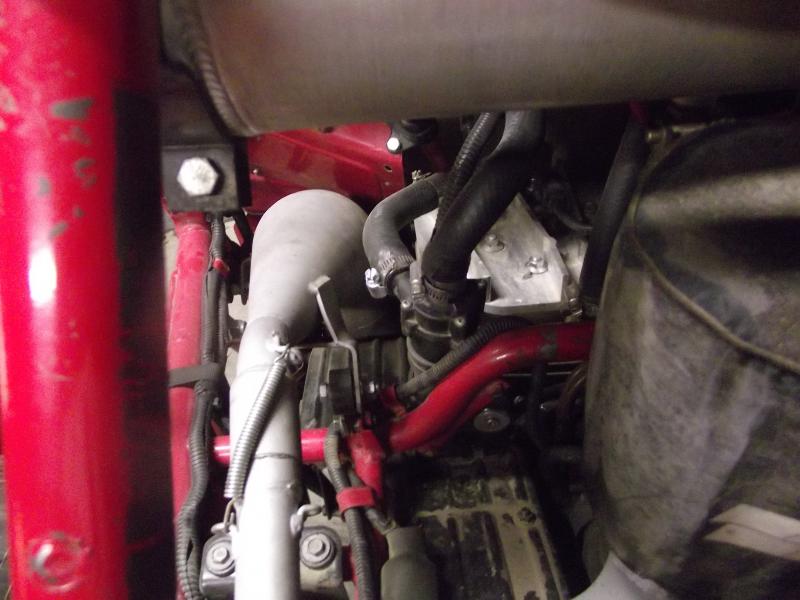

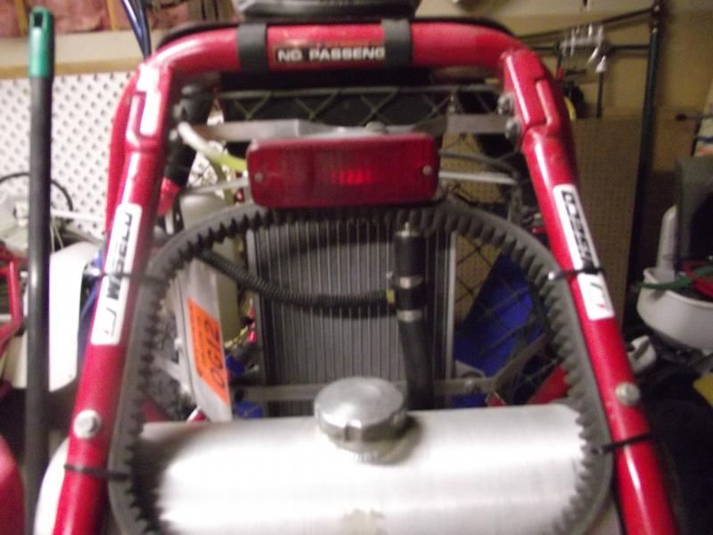

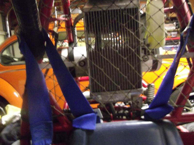

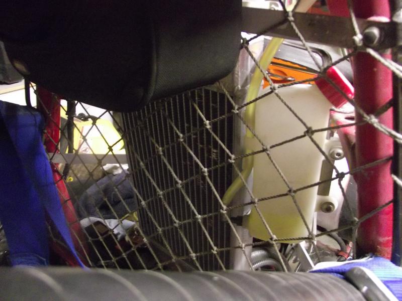

Instead of the YFZ radiator which you are going to buy used, why not buy a new Banshee radiator? They go for less than 75 bucks!
Here are some pictures of my Banshee radiator setup.

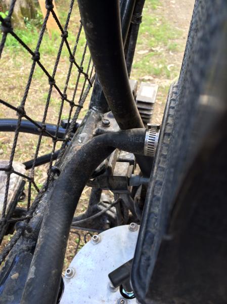

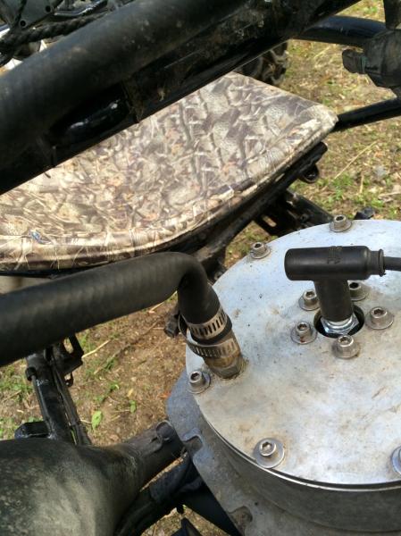

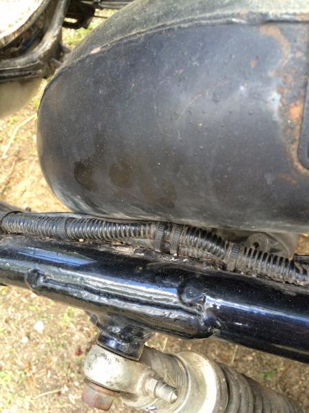

PostPosted: Wed May 20, 2015 12:39 am

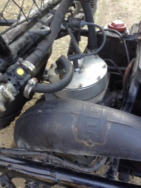

Andy,In your head pics,looks like the coolant hose is kinked?...or is it just me?

yes the hoses are kinked in two spots. I ran it once for 1 minute or two to make sure it ran forward and backward. I need new hoses and radiator. I will get a few picks of the Engine area. Because nothing seems to be where its supposed to be.

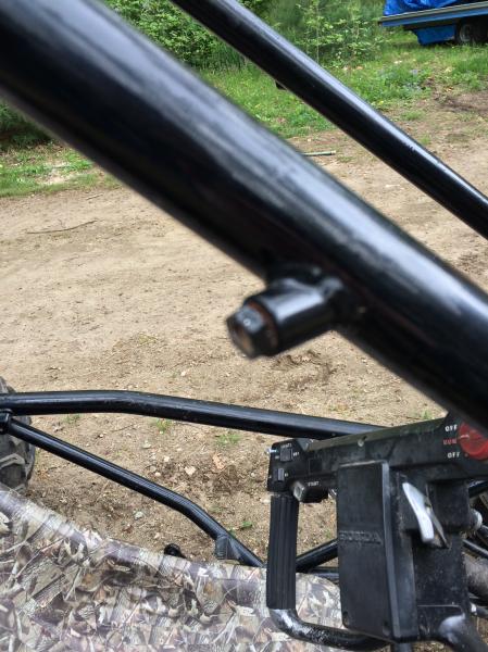

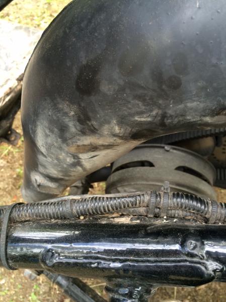

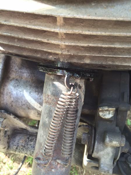

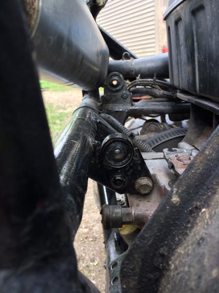

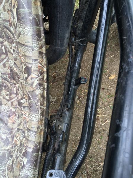

Ok so here is the kinked hoses and busted exhaust (no bolts in it) sorry for so many pictures. Where is the exhaust supposed to be? Also See anything else major missing? And I have two holes by the rear that look like bearings? That are pictured. The two circles behind the air filter. Any banshee radiator good for the replacement? And Any ideas where I can put the new water pump. Don't want hoses to melt or kink.

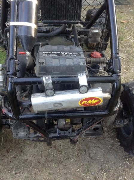

PostPosted: Wed May 20, 2015 9:53 pm
No clamps on the hose joiner?
The 2 holes at the rear are the OEM muffler rubber mounts.

Your DG pipe actually is missing a mounting bracket.
The mounting bracket has broken off just below the frame rail, just above your clutch. You will need to replace the bracket to make sure it's mounted securely.
WARNING!!!!! DO NOT MOUNT THE PIPE RIGIDLY DIRECTLY TO THE FRAME ANYWHERE! You need to use the factory exhaust mounts that look like bearings. These will allow the pipe to move independent of the Engine and the frame. More than likely, the bracket that has broken of did so because the previous owner mounted the pipe directly to the frame and didn't use the exhaust mounting brackets.
