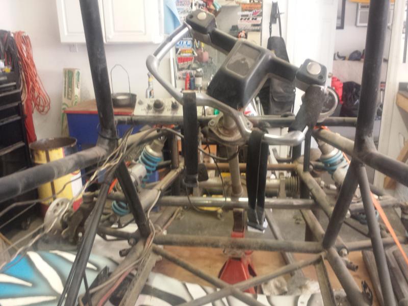

He replied back pretty fast and send 4 pics I will see if I can get more.
This must be a very early Briggsbuilt looks like it has a FL250 steering yoke and a FL350 transmission?
FL350 based Engine unknown water coooled head? don't see a fuel tank looks like it has sat outside for a while.

GEN II car. They used suzuki quadracer calipers and rotors for the front brakes. Should have a rpm sandcast trans case that looks like a 350 ody trans, they did not come with a 350 ody trans. Shims on the front a arms are for caster adj. That set up works very well. Odd to see a fl250 steer yoke on it, cut that off asap and reinstall the quick connect spline/collar set up. Looks like it needs a LOT of work to get it back in action.

Your head will be hitting the roof even with your back arched a bit. I am the same height as you and find fit and comfort is not the goal of this car. That seat is the old old version of the beard suspension seat, very narrow. The seat is terrible for guys our size; but about all you can really fit in there width wise too, it will dig into your hips and make you want to ride the pilot instead, they were made for smaller guys in mind. Even with mine resting on the floor, my head would rub the roof panel. Your knees will be pressed up against the lower dash panel/bar. I added a lot of padding in that area. I have never seen one with a yoke type steering assembly. The rack and pinion will have too much angular motion to work with a yoke type assembly. You are correct on the foot controls. With longer legs, you will be able to lock your knees in to the dash bar to keep your feet from bouncing around. You will need to wear low pro sneakers. The tips of your shoes will rub the cage/hood area from time to time and cause your butt cheeks to sqeaze in a bit from unintended WOT (Wide Open Throttle) acceleration and or lack of braking action.....
