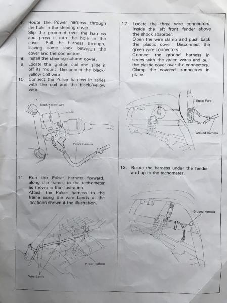

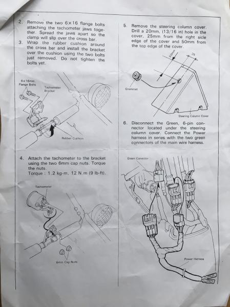

A. does anyone have the install instructions for the honda pilot tachometer that they would be willing to give me a copy of or sell the original?

here you go the pilot install instructions.......

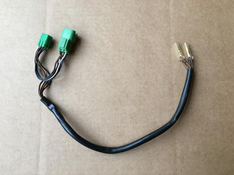

firstly the tacho head unit is the same.it has a oddy part number -VM0- but is the same for both. The power harness is different the pilot one has the two green connectors (see pic below) the oddy power harness has bullet connectors instead of the green plugs.

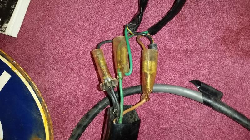

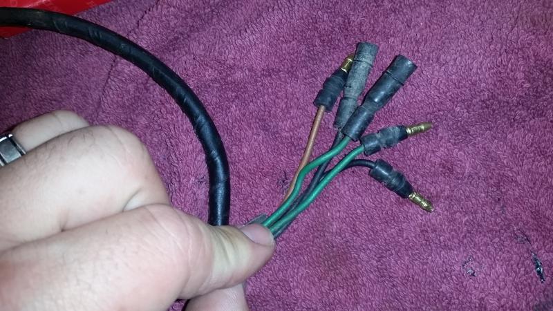

here are some pictures of what i have to work with.

That is a oddy power harness you have......sorry mine not for sale ...took 10 years to find one and had to buy a pilot attached to it LOL...but i have made up a few for guys on here...only problem not cheap as i have to buy a used TRX main harness to get the green plugs....
